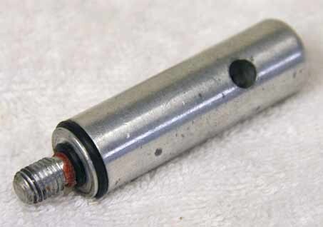

    How do you pull the bolt apart to replace the brass center piece?

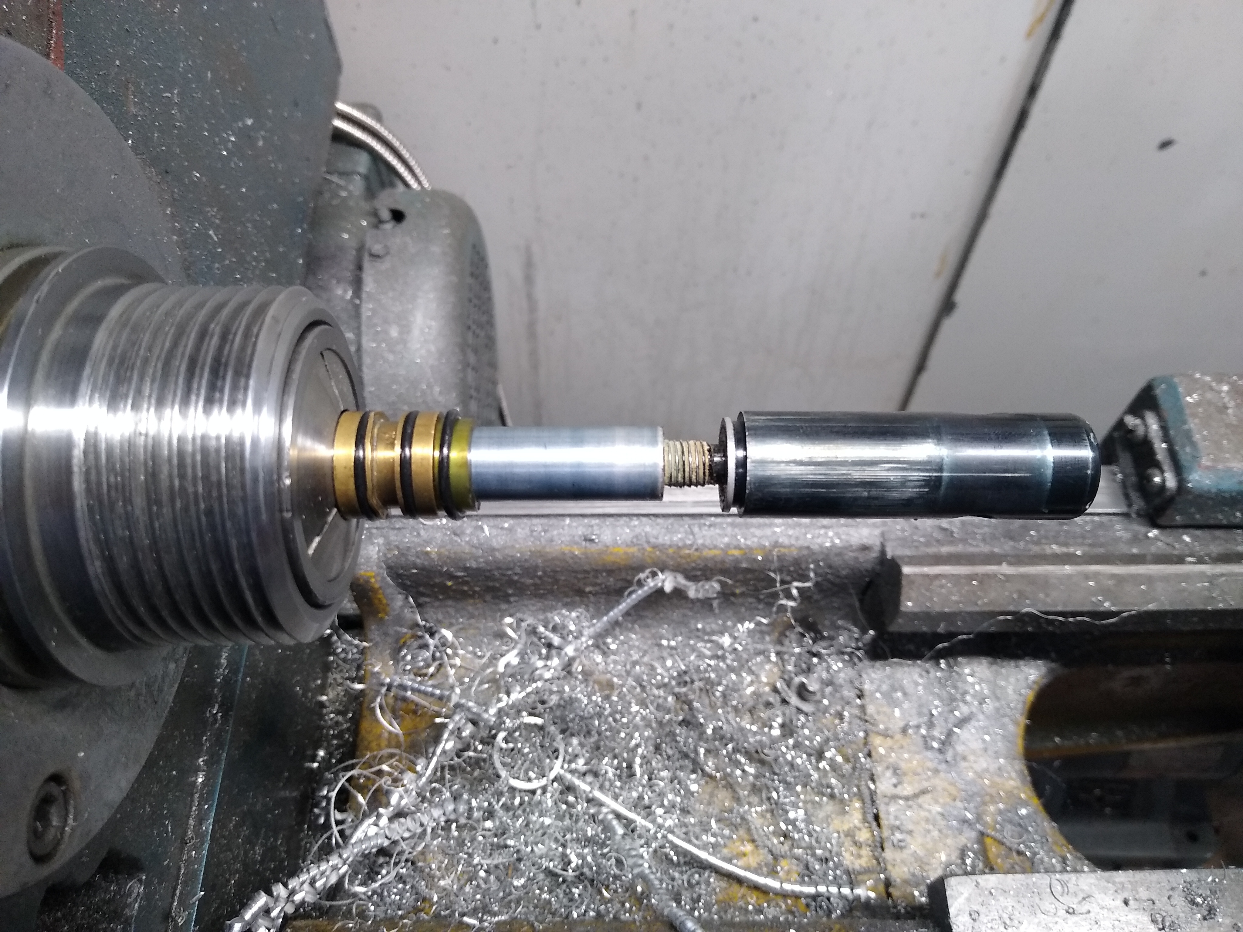

      its threaded, i used a proper sized punch through the bolt pin hole to get apart. its been a while since i did it though, think i needed heat to get apart, loctited

        Thanks, exactly the info I needed.

          Glad to know I'm not the only one that uses lathe chucks and collets to hold round things while I pry 'em apart.

            actually did that with a barrel couple weeks ago

            I've got dedicated 5c blocks for exactly that purpose.

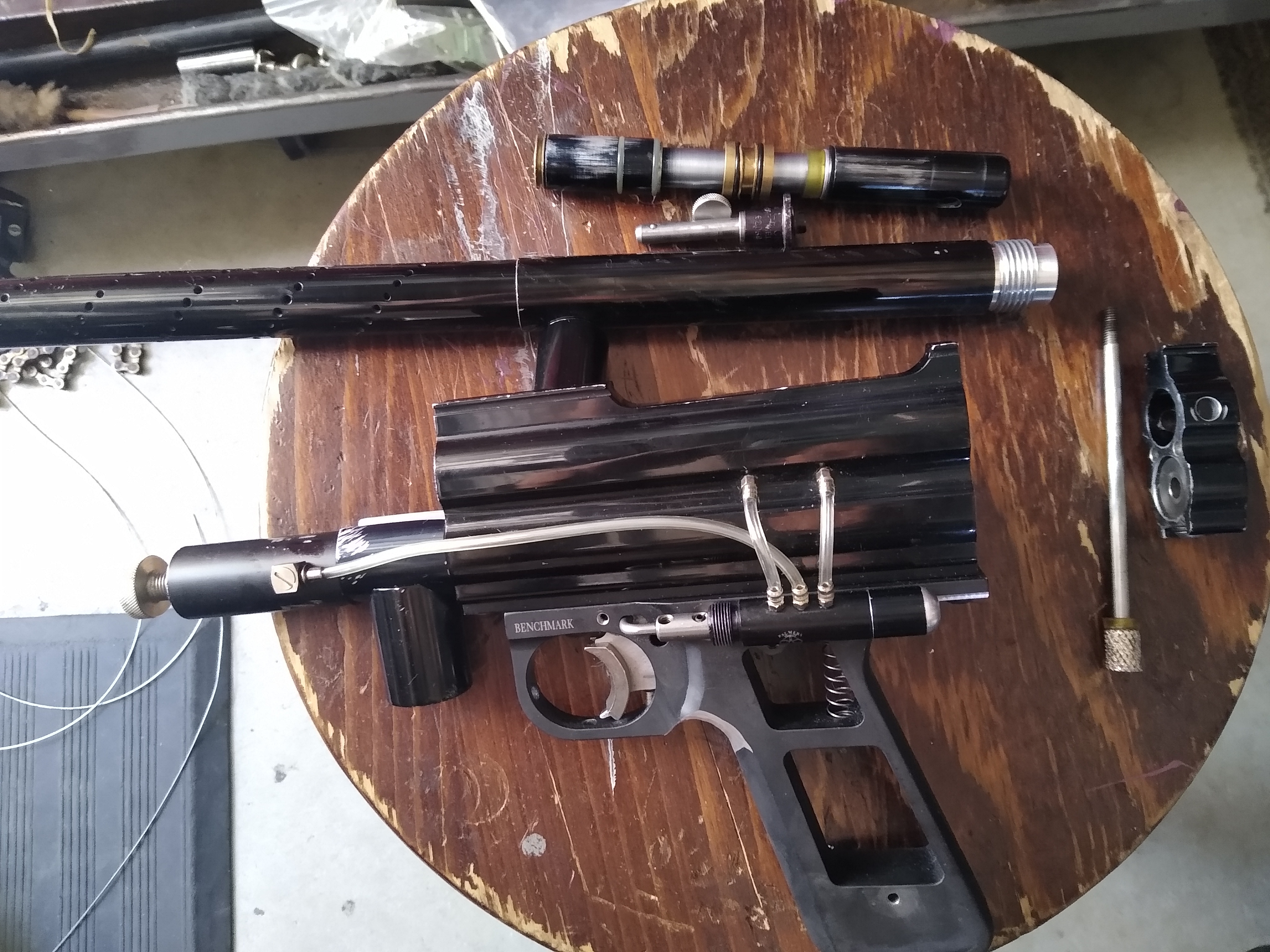

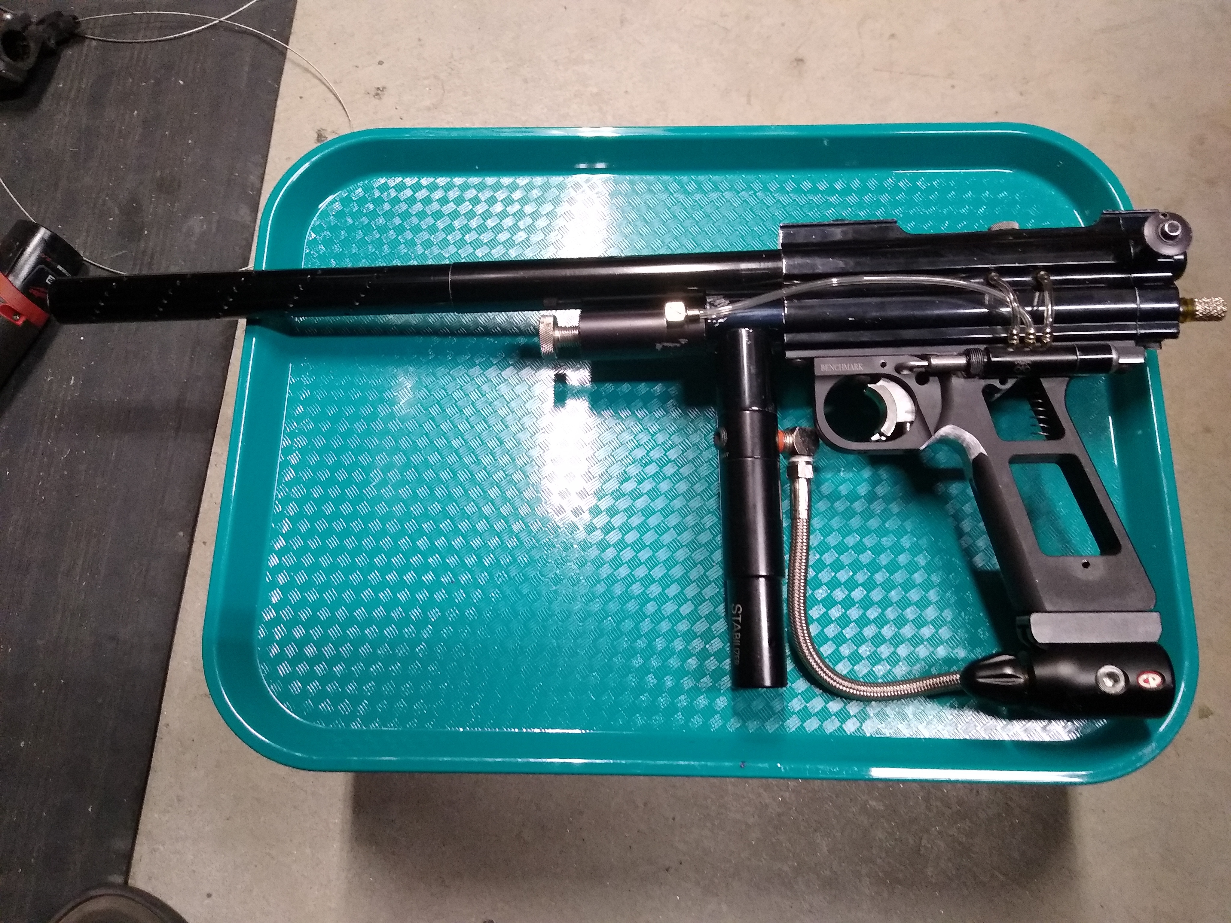

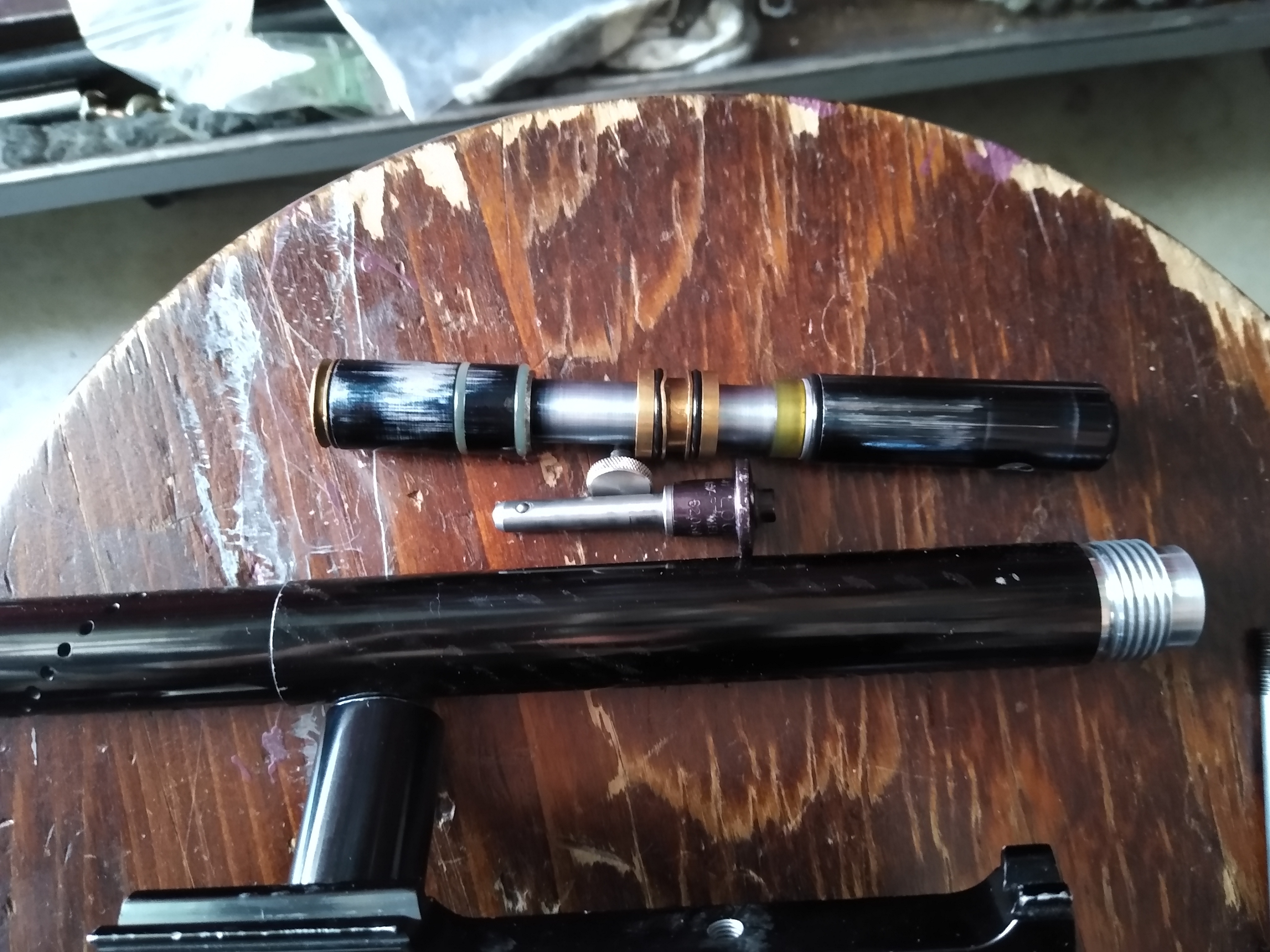

          Got it sealed up and shooting. Ended up just changing the o-rings under the brass piece. If the broken o-ring flanges give me trouble, I'll make a new piece. Until then,... Also need to bore the barrel for inserts or add a ball detent to the body. Or both.

              Such cool looking machines. I wonder if anyone has tried using a 90 degree elbow on the air line from the LPR to the 3-way, so that it would lay flatter against the body. A hardline there would look badass, but probably be pretty fiddly to install.

                they came with a hardline there. Kits is modified

                ans LPRs were supposed to be the correct length to use the factory hard line.
