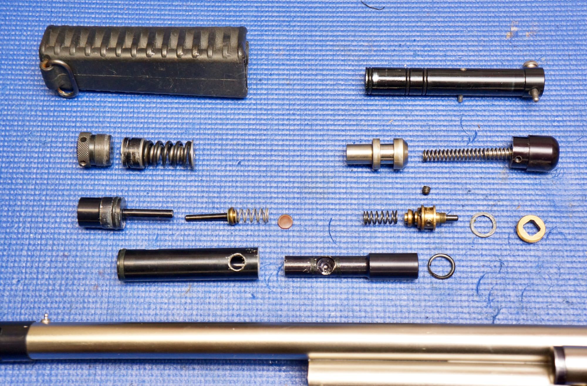

    I'm looking at rebuilding the LPR on my 30 year old typhoon but I'm a bit stumped on how to get the poppet valve out of the body.
    At the moment pressure is building up until the blow off valve releases pressure in a series of pops. After taking the front adjuster knob and spring pack out you can hear a slight leak from the poppet valve. I guess after 30 years the seat is either damaged or contaminated with debris.
    Any ideas?

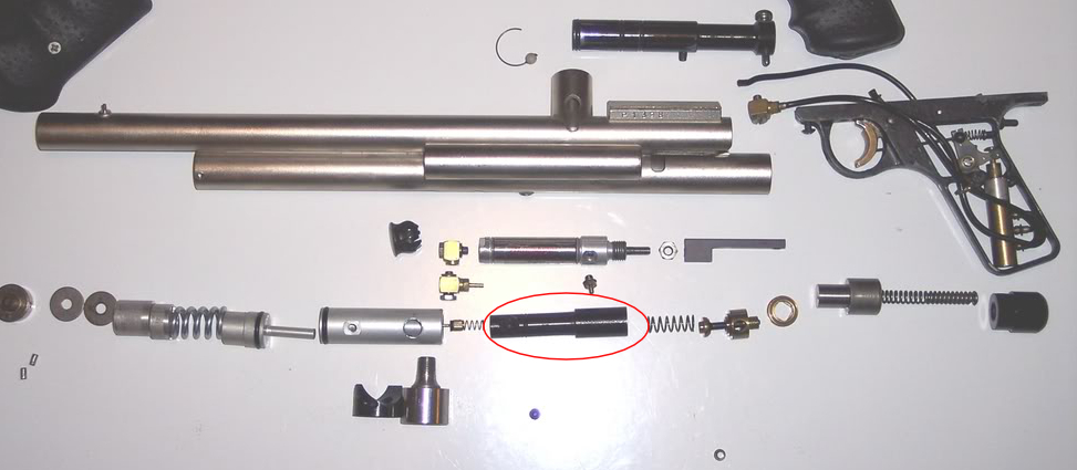

      Looking again at the diagram it looks like the LPR body comes out the front and the valve body goes out the back. Is a special tool or pin punch required?

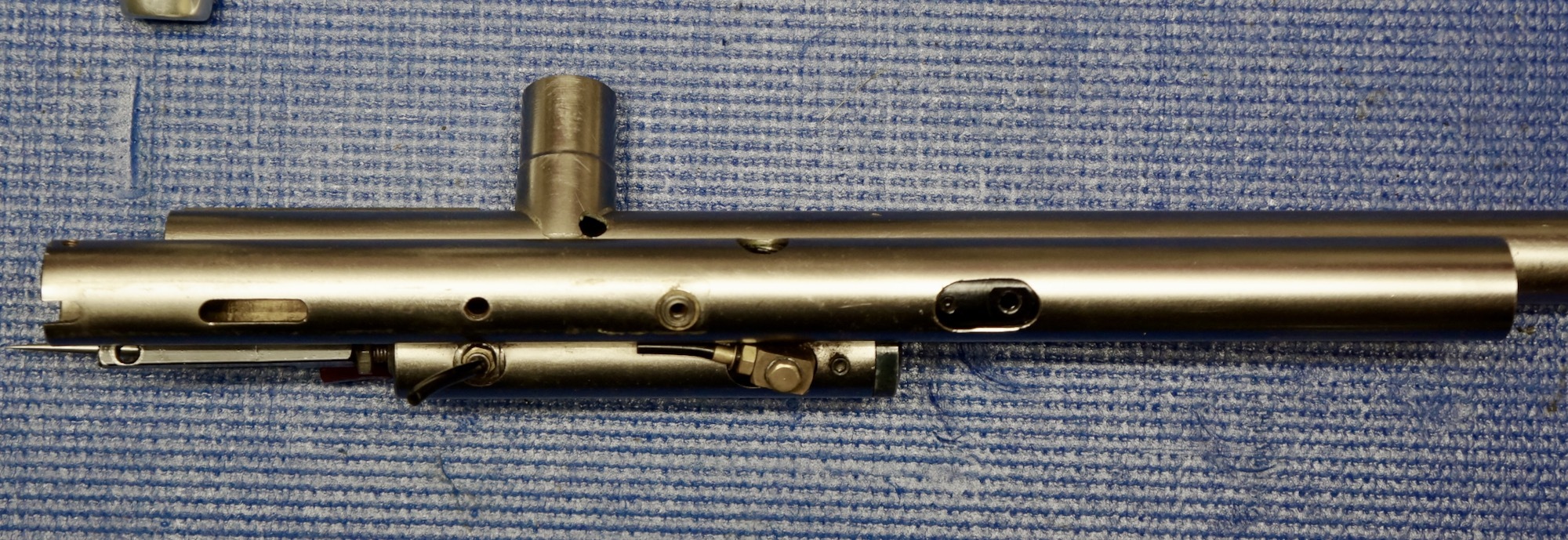

          After putting the Typhoon to one side for a few months I'm back on the case.
          I've made some progress and managed to get the LPR housing out of the front of the lower tube.
          Now all that remains is the alloy body that sits behind the valve (circled in red). The valve is out so there should be nothing holding it in place. Still it is stuck tight. My question is can I knock it out and which direction should it go if that matters?

            It might be helpful to look at my Hurricane disassembly thread. It’s actually a converted Hurricane, so internals are the same. I had similar issues to you. These things are beasts to work on!

              Many thanks, I managed to knock the final piece out of the rear of the marker.
              Apart from the o-rings being mush I found the cause of the LPR leak. There was some metal swarf sitting under the valve seat.
              Both valve seats look ok so it looks like it only needs o-rings to get it back up and running

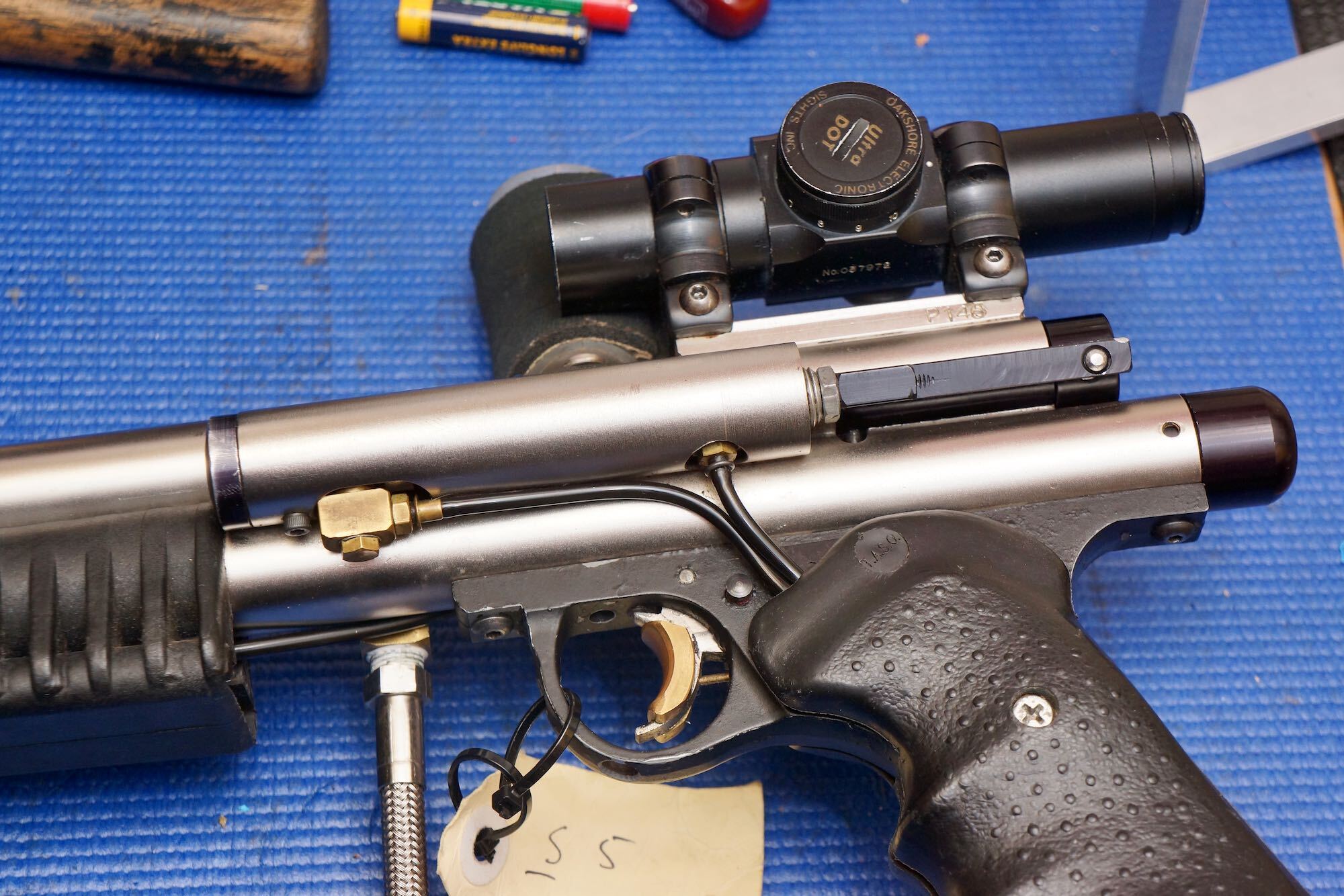

                I've reassembled the Typhoon a couple of times but I'm still getting an air leak. You can hear it the loudest from the opening where the air line enters. I've replaced all the o-rings twice but with no luck.
                Followup - I'm now looking at the threads where the airline attaches to the lower tube and they are in poor condition. I'm thinking that the leak may be coming from here. Any suggestions on the best way to seal this? The threads are too rough for tape, it just tears. I've used Loctite in the past for this type of problem but it didn't work this time so I was thinking of using a thread sealant. Any recommendations?

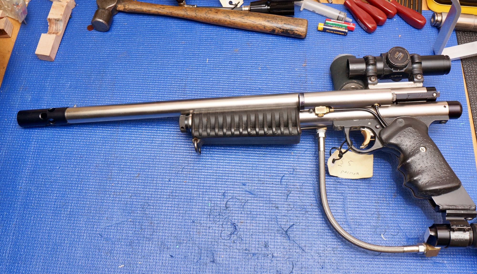

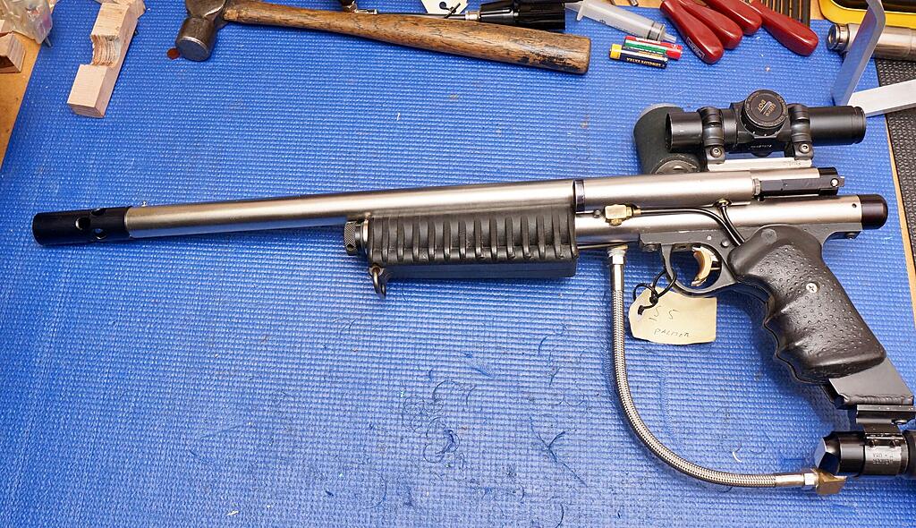

                  I pulled the Typhoon out for another look this week.
                  I was pretty sure by now that the leak was coming from where the main airline elbow screwed into the right hand side of the body. The elbow was screwed in tight with sealant but leaked regardless. That's when I had an idea. Perhaps the fitting was bottoming out. So I machined 2mm off the bottom of the thread on the elbow, added some sealant and refitted it. After allowing the sealant to set for a day I aired up the Typhoon and was back in business. Problem solved!
