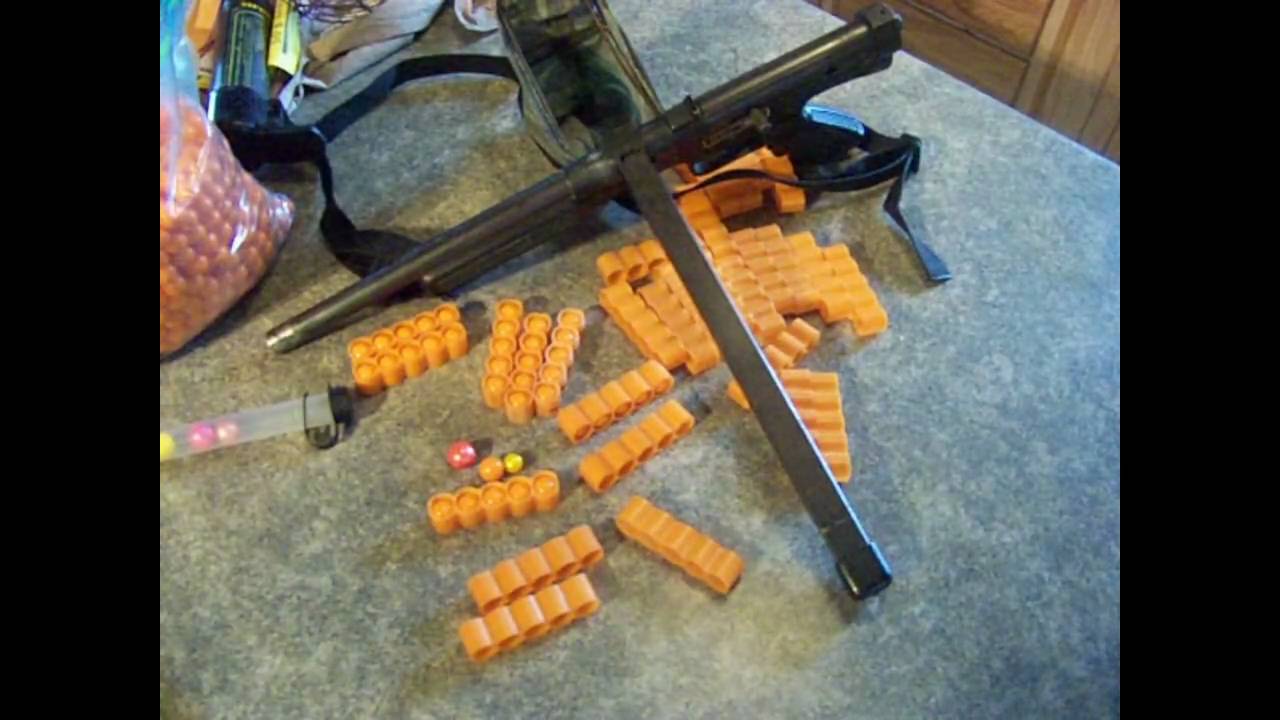

          I made a SMG version with a Sheridan JTX, which has a very small hammer. It is very fast.
          here is a link to a video I made some time ago.
