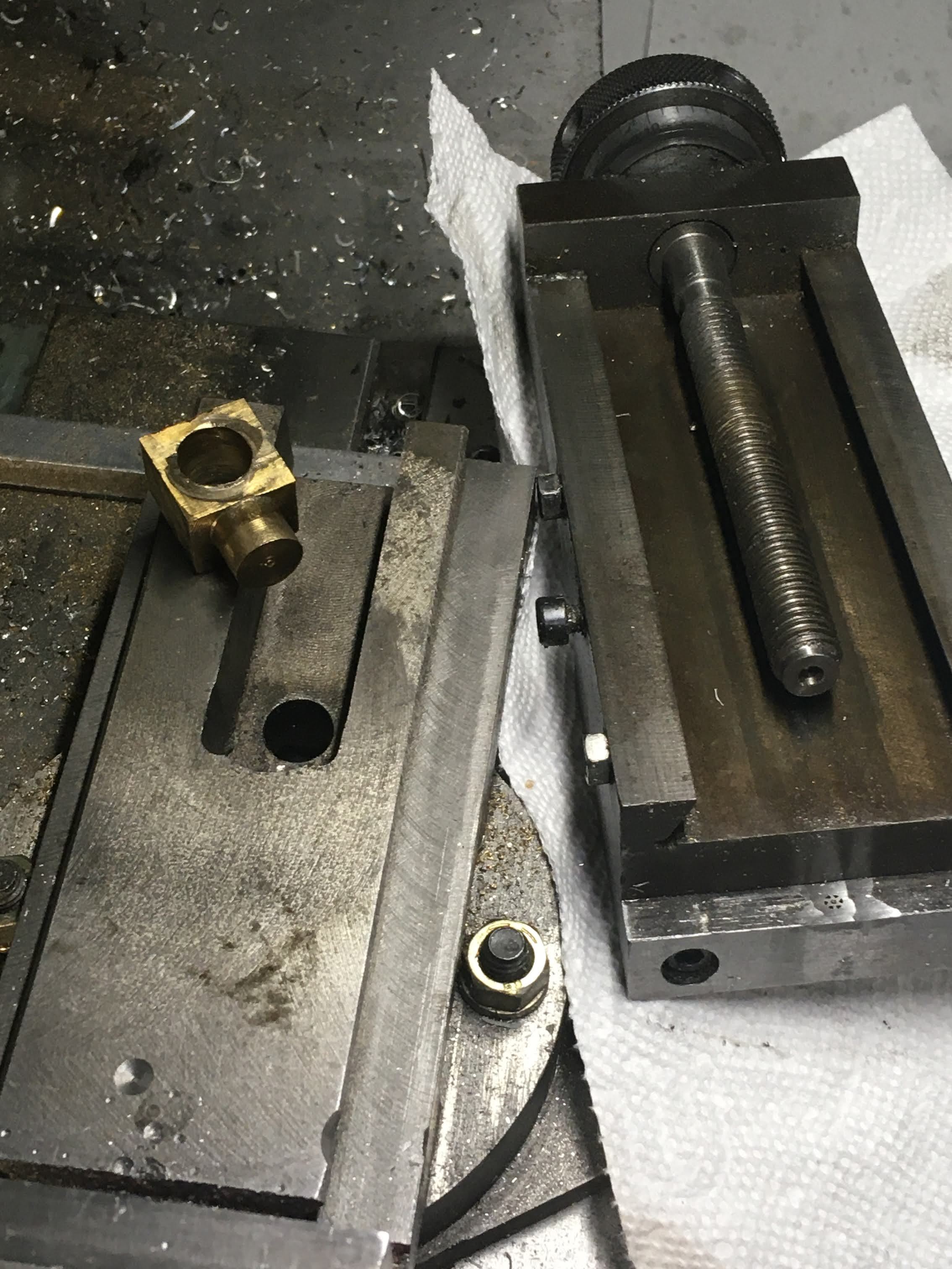

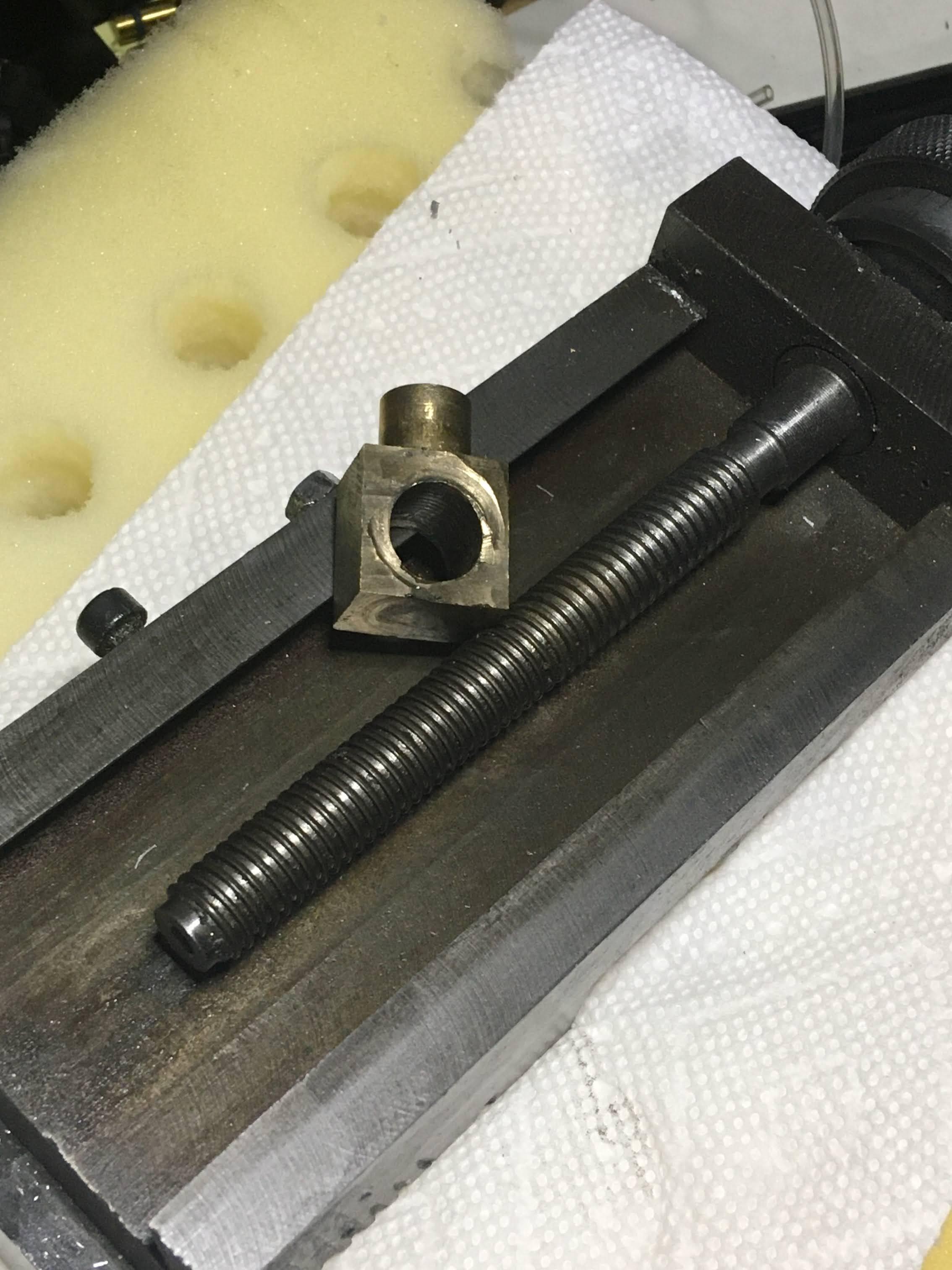

    I need to find a replacement 1/2-13 nut for my machine vise. The one I have (original to the machine) has completely stripped. Unfortunately I also don't know the same for it, so I can't search for a replacement. If I search for square nuts or square retaining nuts or anything similar like that, I only get results for normal square nuts with maybe a few odd shapes for T-slots. Not helpful.
    The nut is square, but it also has a round protrusion coming out of the bottom. That round part fits into a round hole in the bottom of the vise between the ways to keep it in place horizontally. (It's kept in place vertically by the two halves of the vise once assembled.)
    Obviously I've checked the manual, but the manual lists the entire vise as one part. Useless. I've also looked at manuals for other vises, but I can't find one that uses the same kind of retaining nut.
    I've attached some pictures for reference. The nut I need to replace looks like it's made of brass, which seems really stupid to me, but whatever.

    The same part in a lathe cross slide is called simply a leadscrew nut. They're made out of bronze, usually, or brass on cheaper parts, because those wear well (low coefficient of friction) on a steel or iron leadscrew.
    The brass or bronze does wear faster, but it's cheaper/easier to replace the nut than the whole screw.
    If you can't find a replacement, I can make you one.

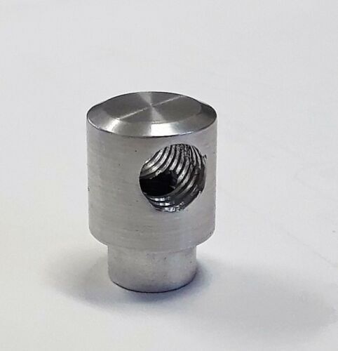

      Thanks, Doc. I might take you up on that. But if this nut is usually made from brass or bronze, I should be able to make it myself. I don't have a 4-jaw chuck, so I can't do the square part, but I found this leadscrew nut on eBay, and I think I can make something similar.

      I'm assuming the fact that this one is round won't be a deal-breaker. It will be a little more tricky to get the vise reassembled since the lead screw might rotate, but once it's all together the lead screw itself will keep the nut from spinning.

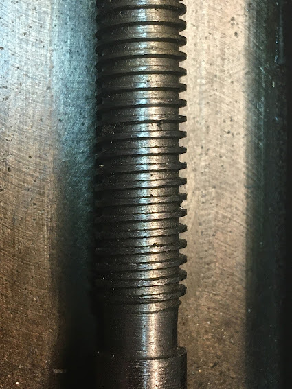

      I've got one more question, if you don't mind. The lead screw itself seems to have square threads, but a normal 1/2-13 nut will screw onto it. Can I just use a normal 1/2-13 tap to make my leadscrew nut, or is there a different tap I should buy for this?

        That's what's known as ACME thread, a blockier, sorta-triangular thread that can stand up to more force/pressure. A nut made with a standard 1/2-13 tap, if it fits, wil work, but will wear out and get sloppy in short order.
        However, mot ACME threads like that are used for machinery- like lathe cross slides and the like. As such, an odd thread like 13 TPI would not cooperate well with a lathe dial, so a 1/2-13 ACME is rare. I'm not actually sure they even exist. Most you'll find are 1/2"-10.
        Which means your options are to either single-point one (tricky, but by no means impossible) or just use the standard 60-degree tap, and just know the nut won't last terribly long.
        There's several good videos online, including one by This Old Tony that explain how to do internal ACME. Be good practice to try.

              All of Doc's talk about dials and things divisible by 10 reminded me that, duh, I have a metric machine. So, I took the whole lead screw to the hardware store again and discovered that it's not actually 1/2-13. It's M12x2.0. And they don't have metric nuts that coarse. They only have 1.25 and 1.75 thread.
              Looks like I'm buying a new tap.

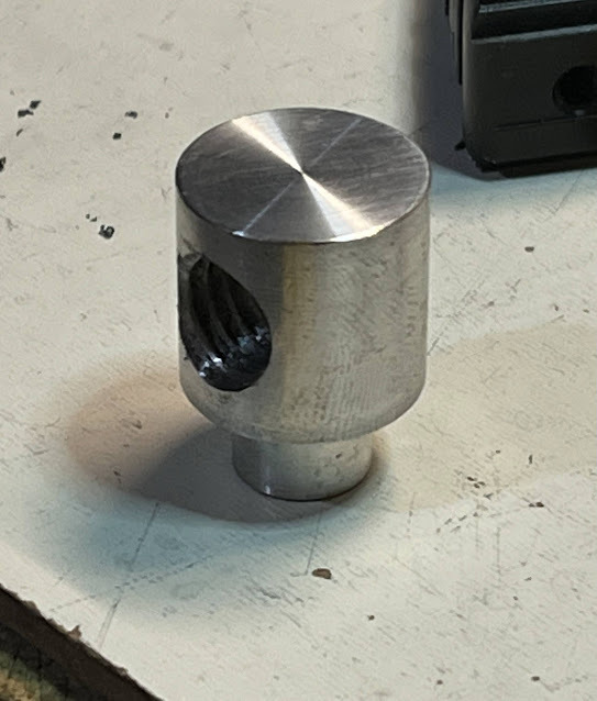

                      Time to finally update this thread.
                      I ended up buying the 12x2.0 tap/die combo on eBay to try and make this leadscrew nut myself. Sadly I couldn't find a piece of bronze bar stock for less than $40, so I decided to make a prototype out of aluminum first, just to see if it works well. If it does, then I'll invest in the better quality material and make a second one.
                      I almost ruined the part when one of my center drills broke while trying to drill straight down on the round section of the piece. The tip of the center drill even got jammed inside. But I turned it 45 degrees, tried again, and made it through. Turned out pretty well, if I do say so myself, and right on spec.
                      I've already got it installed in my vice, and I've done a few tests. Seems to hold up perfectly, so I'm one happy guy.
