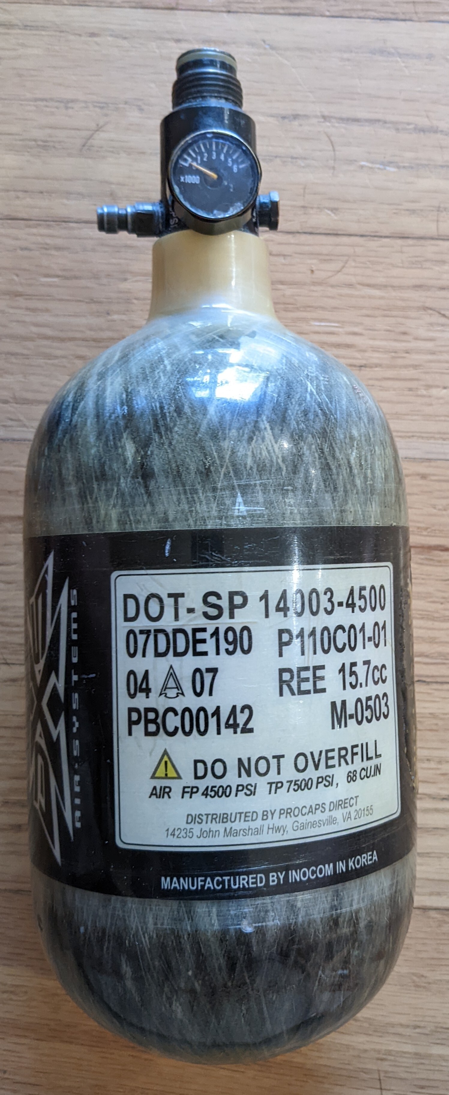

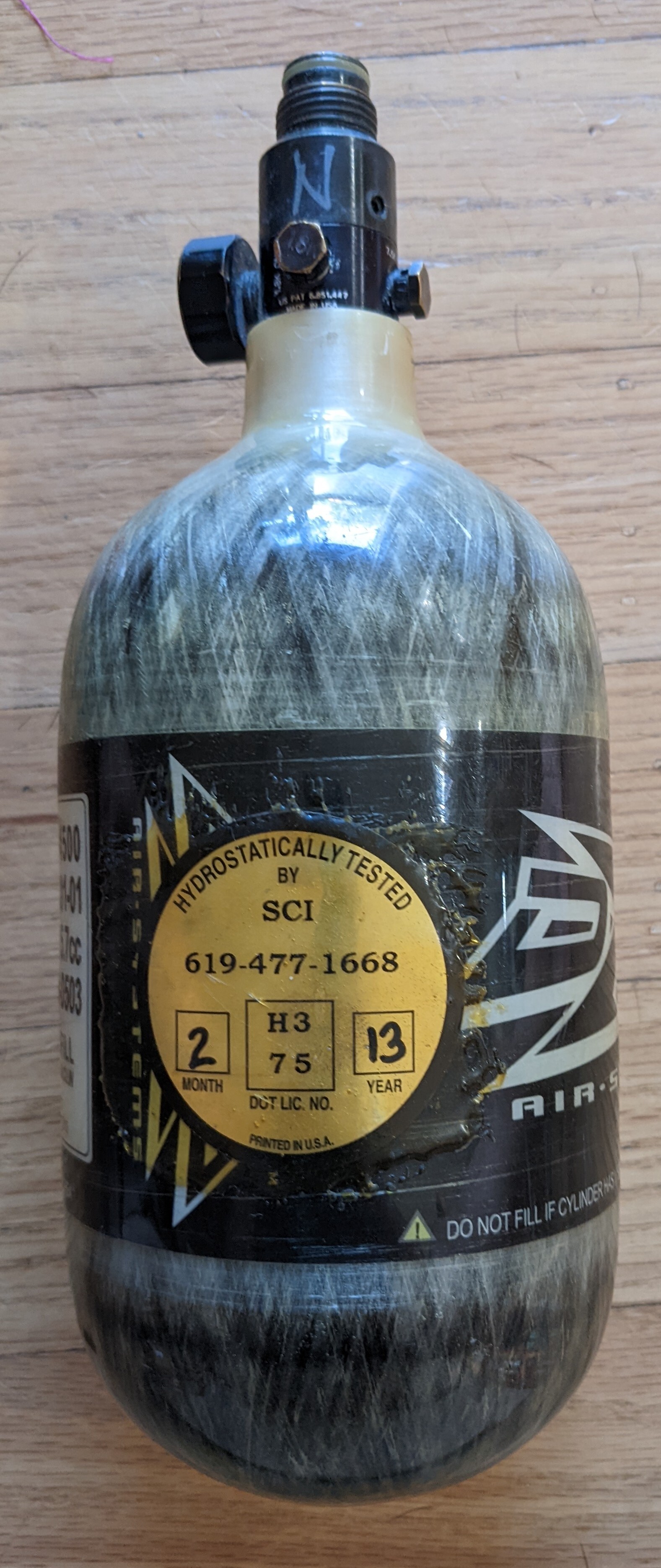

    Is this usable?
    Hello MCB,
    Wondering if this tank is still usable:
    Thanks,
    • 3415
    No sir. End of life April 2021.

      My local scuba shop takes expired tanks and recycles them. I give them all the C02 tanks I end up with as well.
      • Pumpytrilly1
        • 560
        Save the reg. It's done though. Born date of 04/07 with 15 year max life.

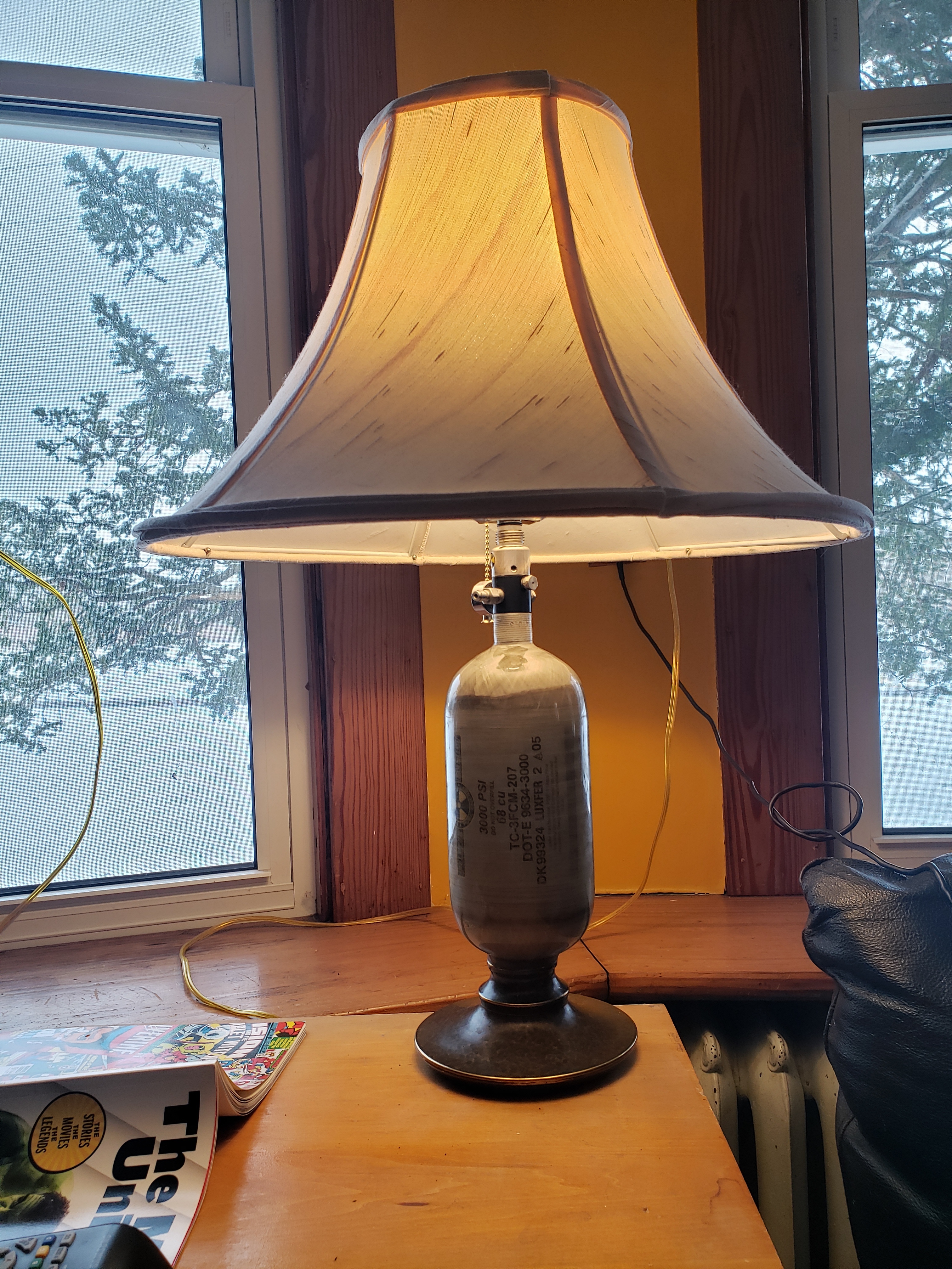

          Jordan made a cool lamp with a tank like this, trying to find the post
          The reg is worth keeping as a spare or if you find a tank with no reg
              Originally posted by Jordan
              And here it is.
              Click image for larger version  Name:	20220102_113047.jpg Views:	83 Size:	4.34 MB ID:	212312
              • AnarchicArctic
                AnarchicArctic commented
                That’s awesome! Might have a use for my old tanks after all…
