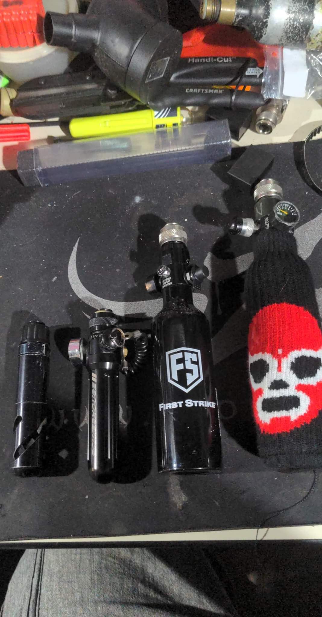

            • 4408
            Smaller tanks...... Oh boy do they.
            Left to right.... Carter bucket changer, powerhouse tester tank (like 2ci) 4500, 8ci 3000 and a 13ci 3000
            As for Palmer 3 ways.... I've never swapped a hurricane obe around but have swapped several typhoons. I despise palmer quick switches so much so I pull them out of everything thing I get that has them..... The BBT typhoon I have in my collection I modified a shocktech Bomb into.

              Tank wise... Holy crap! That's wild!
              How many shots do you get from a 2 ci?!? Or the 8?

                The powerhouse tank? I get a solid 30 shots out of on my emek. They are also still available new.
