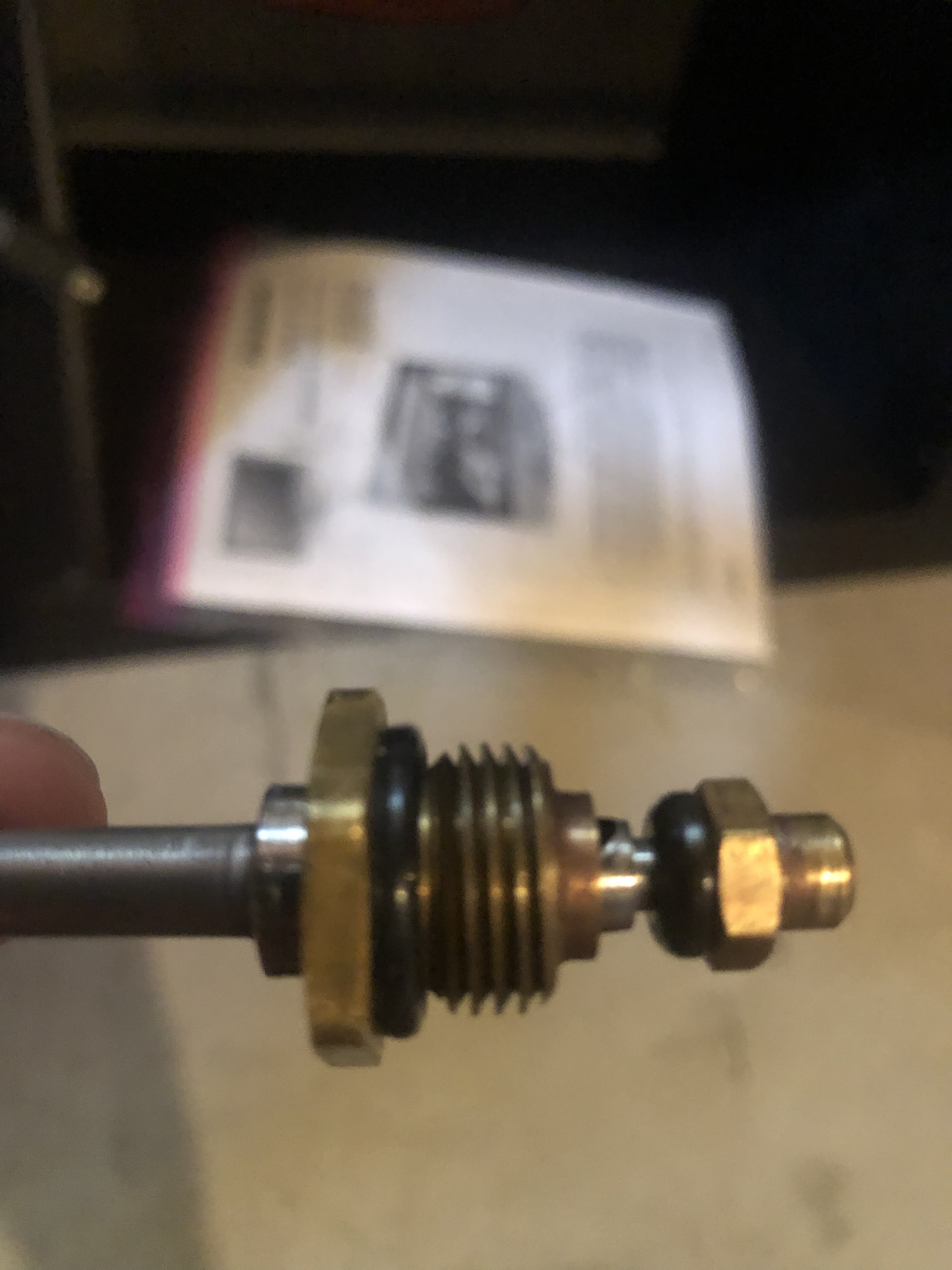

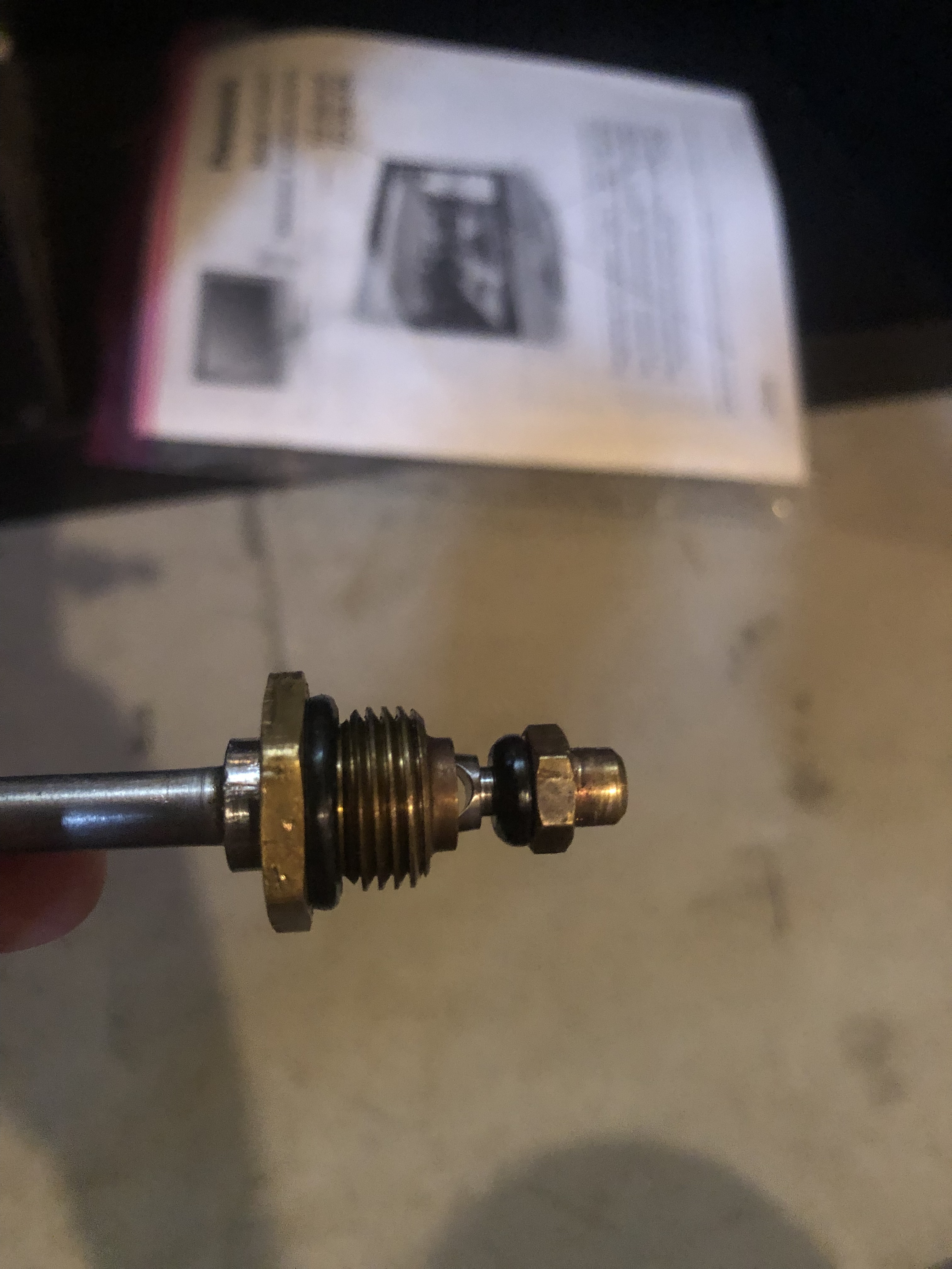

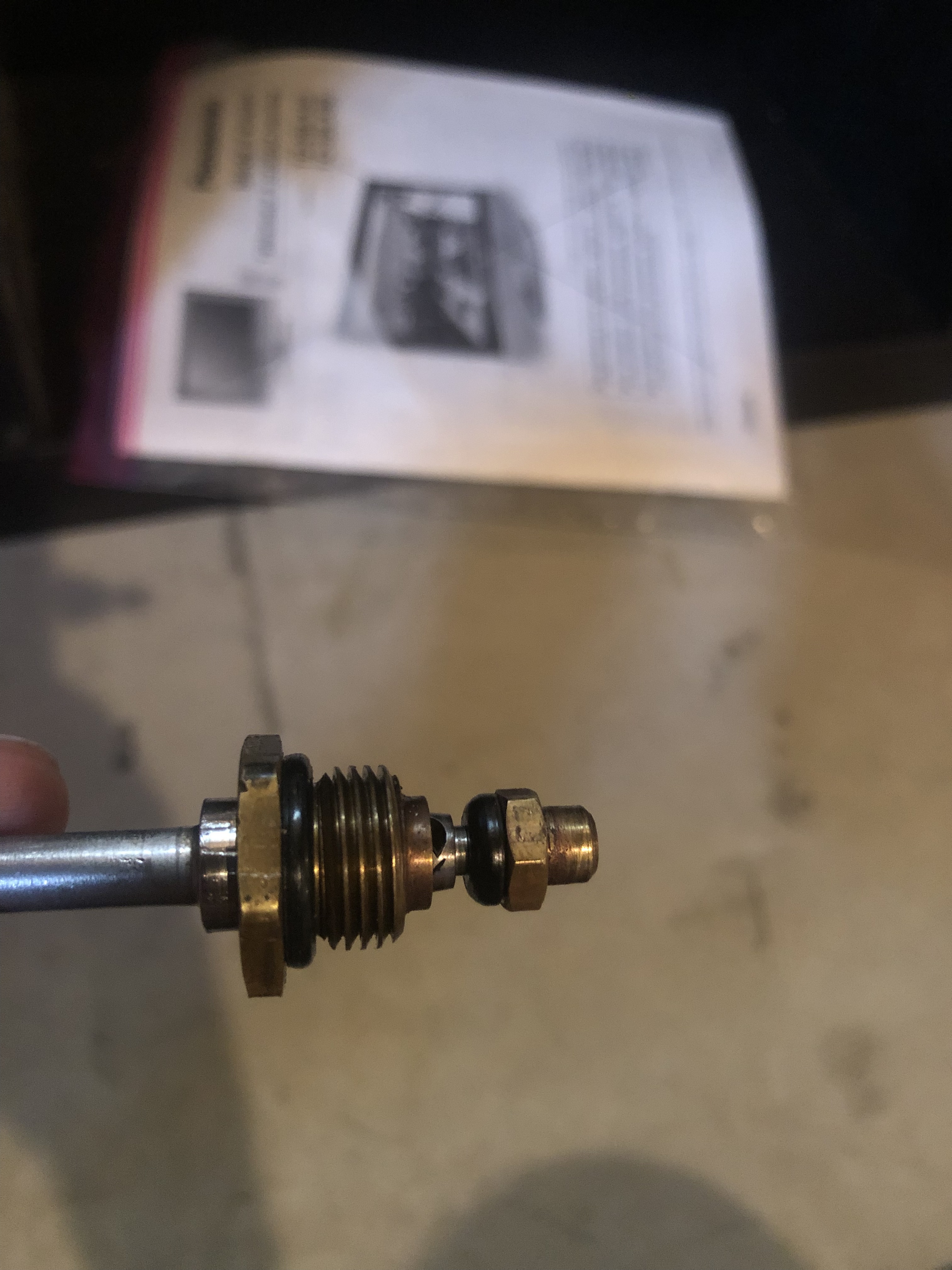

                I am using co2.
                I replaced o-ring on bolt and cleaned off
                some small pieces of rust on hammer.
                velocity is very low and sounds like it leaks after a 5 shots (the leak part is a new development).
                through deduction, I think something is wrong with valve.
                I’ve included some images
                thanks
                • nnolt89
                  Pump Kings
                  • Jun 2022
                  • 266
                  • Maine
                  I noticed a gap inside of valve is that suppose to be there ?
                    Carp commented
                    That is definitely not normally there. Are you able to tighten it up? That should at least take care of the new leak and possibly give you the extra FPS.
                • nnolt89
                  Pump Kings
                  • Jun 2022
                  • 266
                  • Maine
                  Update:
                  tightening that piece made all the difference.
                  tracer is now at 265 with stock parts
                  Maverick is now at 311 with a red phantom spring
                  thanks everyone !
                  I feel like an idiot for not trying that sooner; I was fixated on the springs.
                    So your cup seal was the issue.
