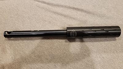

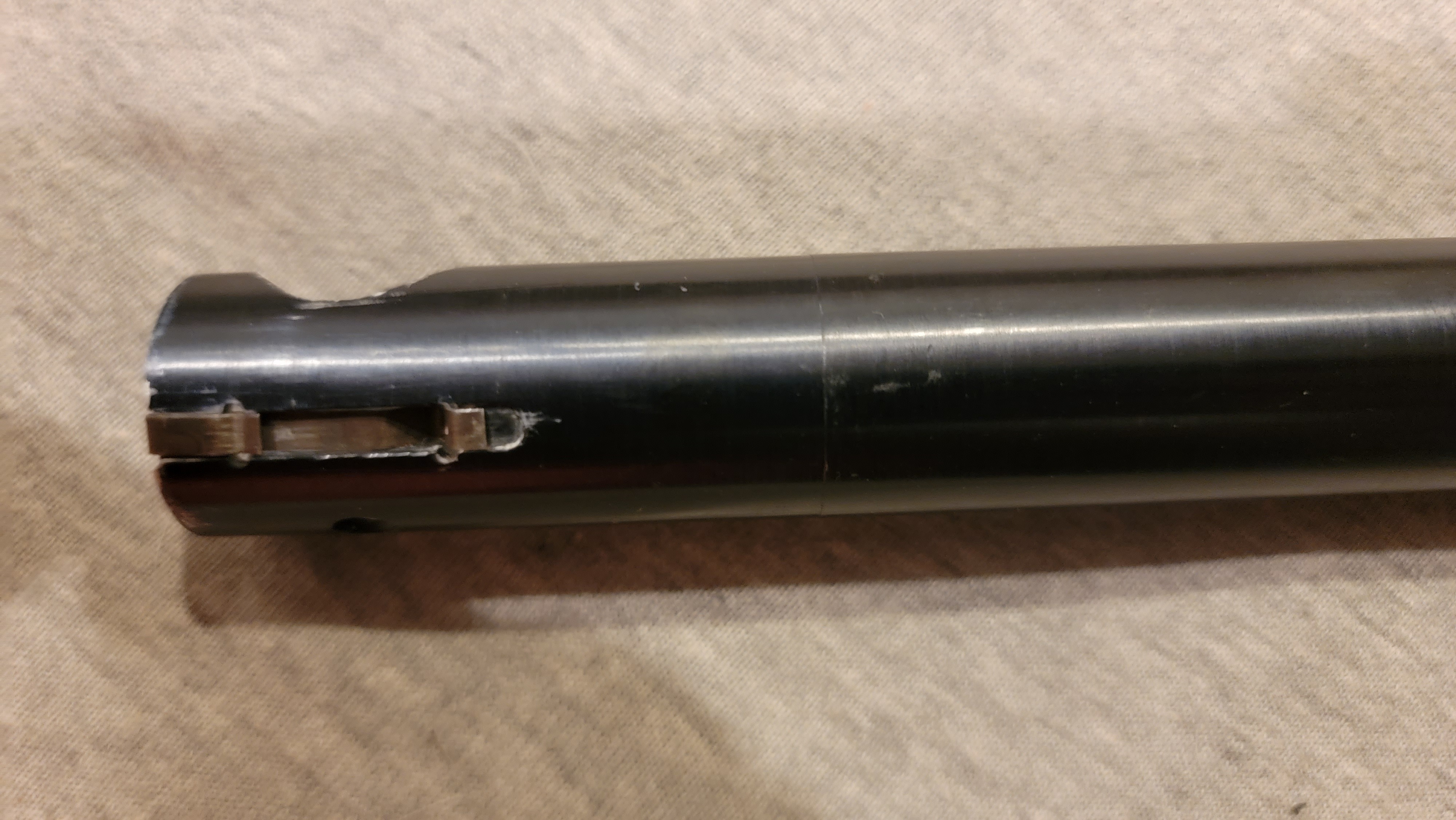

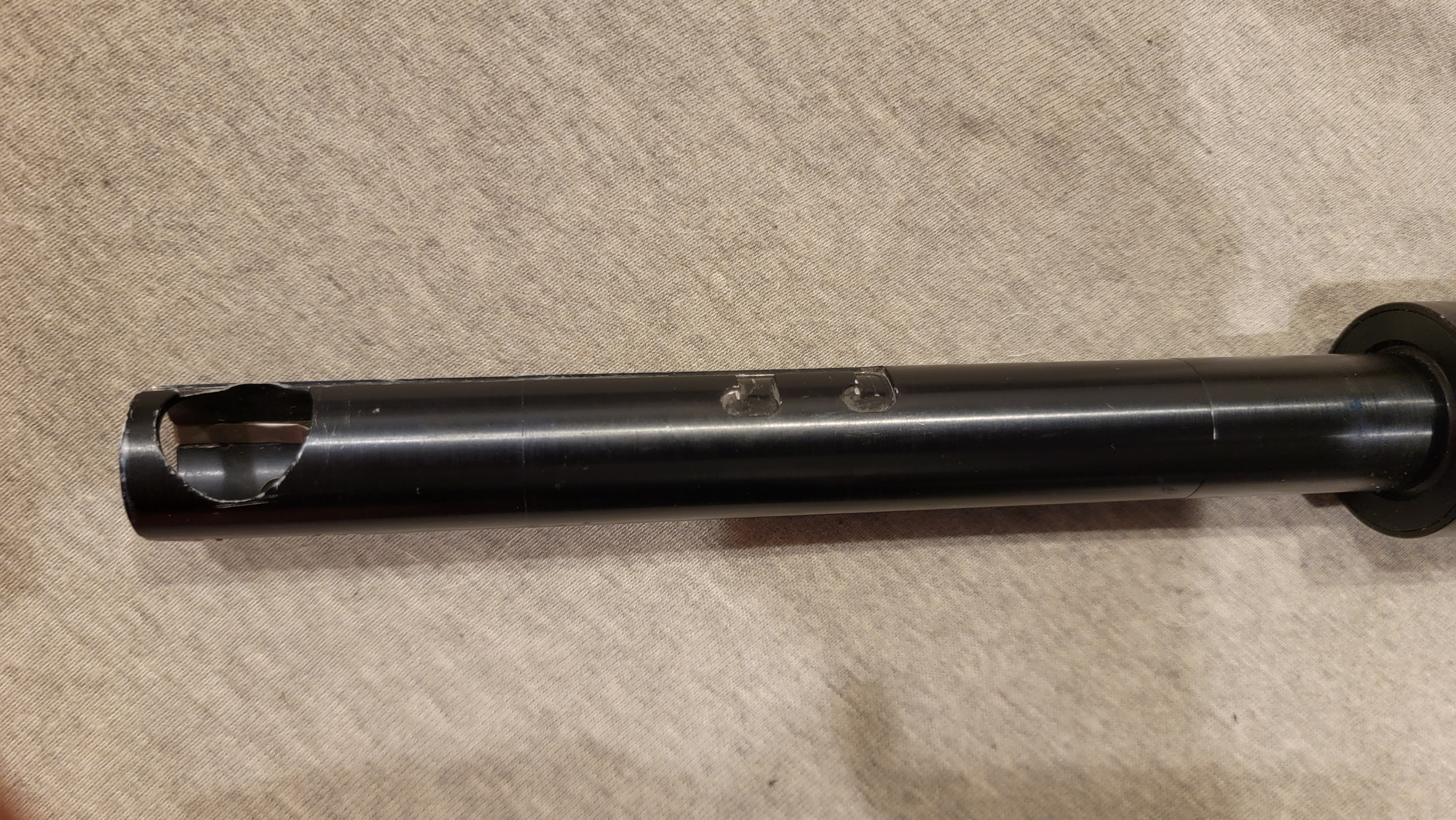

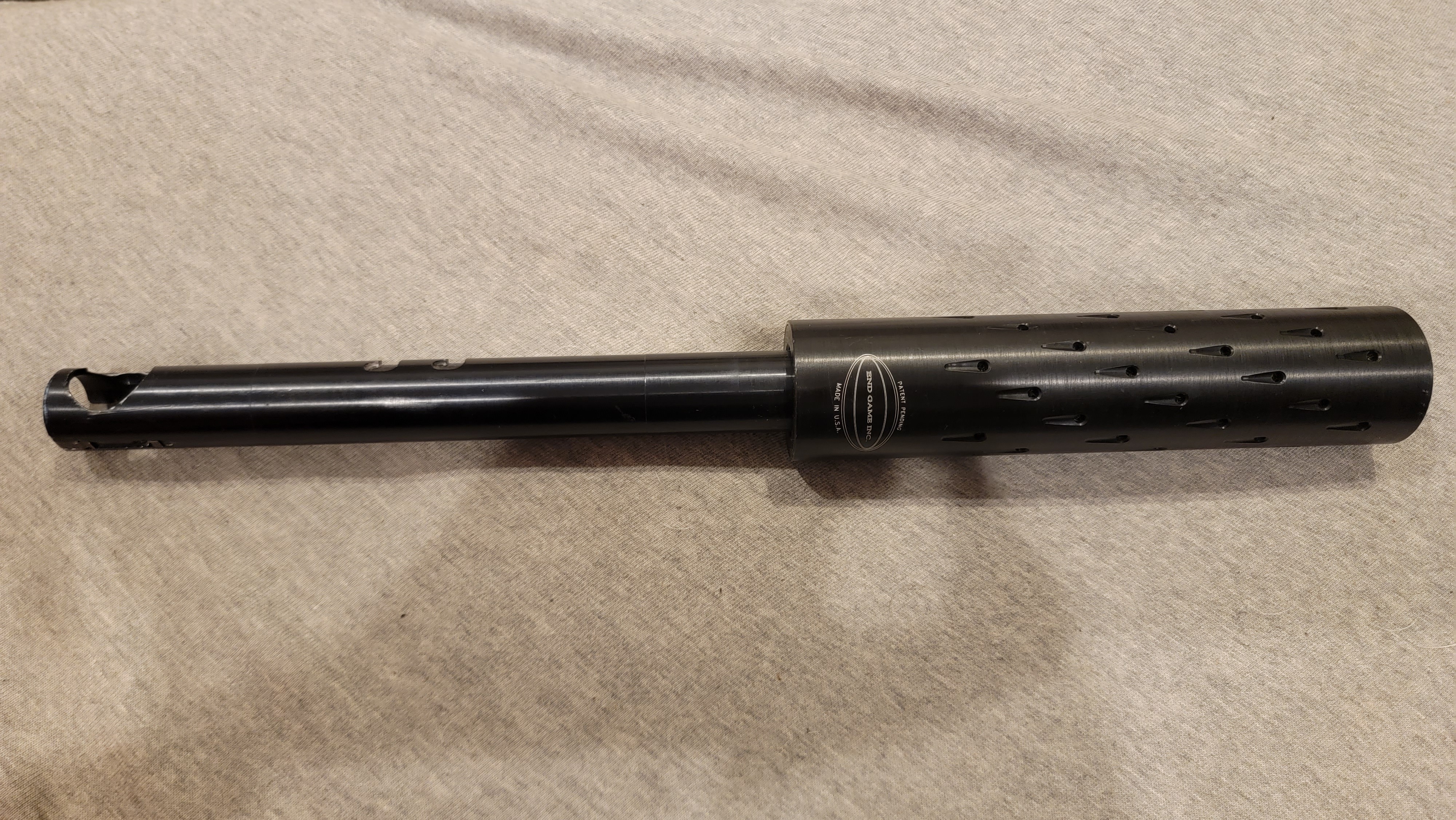

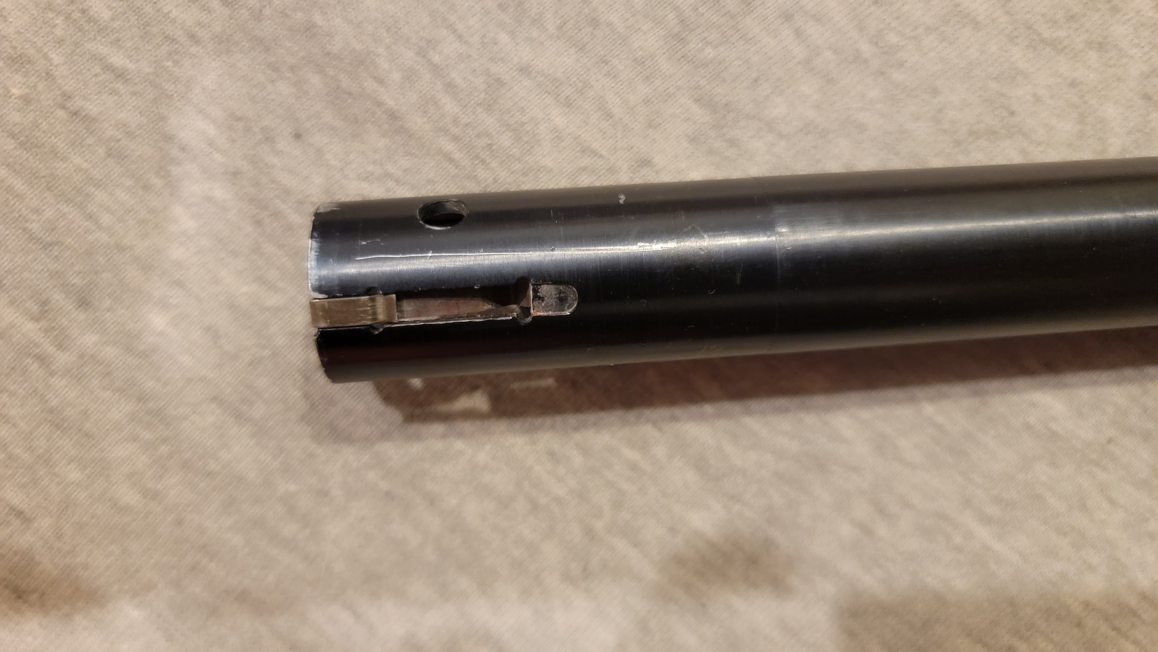

    20220708_212308.jpg What does this fit?
    and appraisal $
    20220708_212319.jpg 20220708_212329.jpg 20220708_212308.jpg 20220708_212311.jpg

    Mokal Mirage barrel maybe.

        Not Mirage. Tiberius T8.
        Will work on a T9, but without the front shroud and looks like for magazine only. Can't see the second set of notches needed to rotate the barrel to the hopper position.
        Also not for First Strike rounds, round ball only.
        And as is at the moment will chop paint like crazy. The detent on the second picture is installed incorrectly. The front tab need to be on the outside, not hooked on the inside.

          Yup, agree T8 barrel.
          XEMON commented
          +1
          Doesn't have the second notch for the hopper position.
