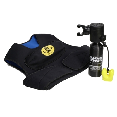

            The ones I’m familiar with from military water survival training are the HEED systems. I’m not sure what threads they have, but the bottles look just like a 13ci bottle. They are a bit cost prohibitive though.
            https://www.ssishoppingcart.com/HEED...ze-_p_128.html

                XEMON commented
                This is the original use for those tiny tanks, and they do save life when used for what they were designed ... But for scuba they'll hurt you ... Hold your breath at 40ft (after inhaling on a tank) and you go pignatta before you reach the surface ...
