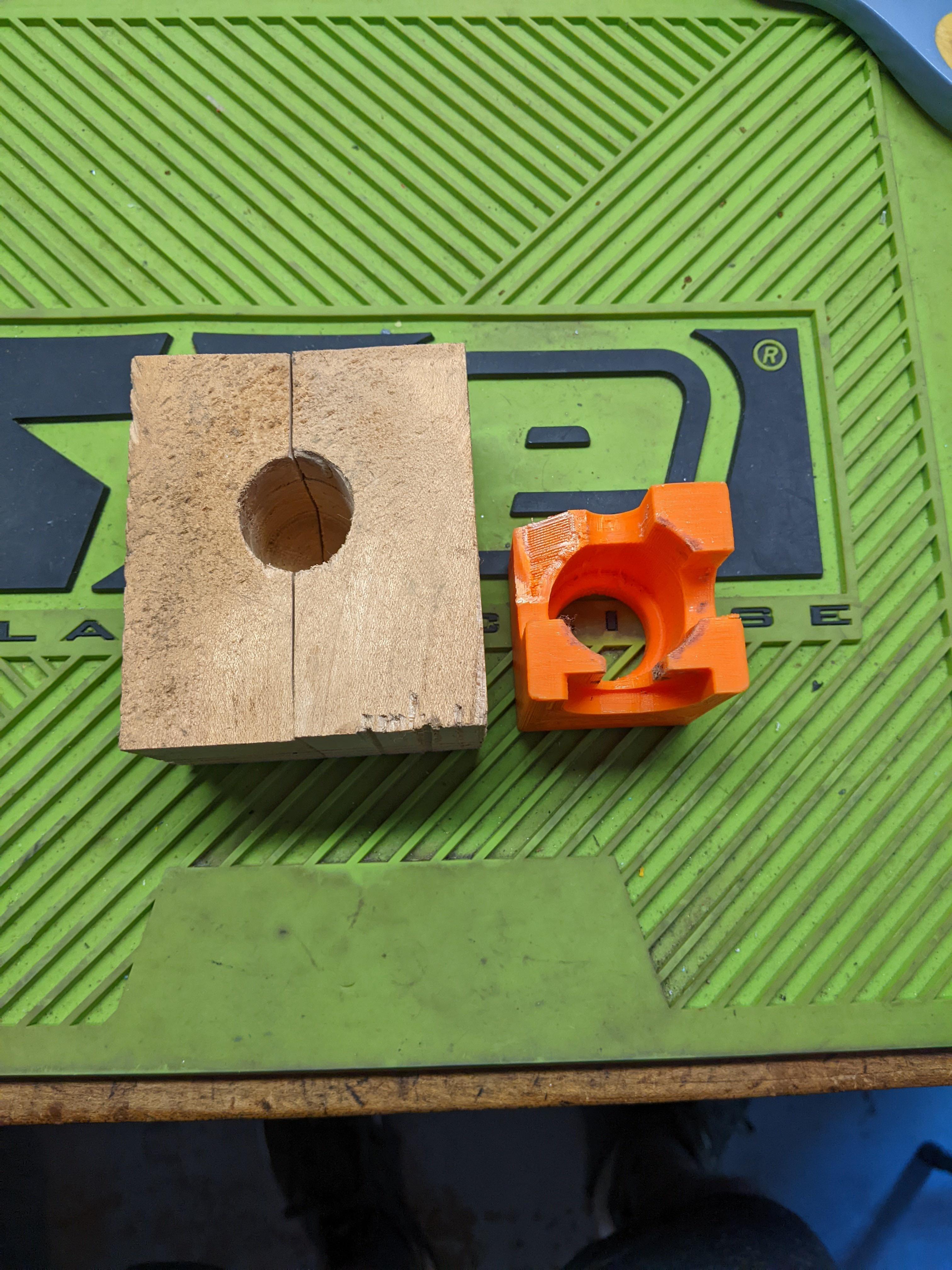

    The cheapest option would be to get a block of 2x4 and use a hole saw to cut to an appropriately sized hole, then cut in half through the hole. You can then throw that in a vise. If you don't have a proper sized hole saw you can go a bit bigger and then cut a piece of rubber hose in half to shim the wood (it doesn't have to be an exact fit, a bit smaller is fine). The downsides to this are that you will need to remove all the fittings from the reg and there is no way to torque it down to spec.

      I liked the 3d printed one and used it to remove probably 25+ regs over a couple years. The only disadvantage is that it relies on the burst disks, fill, and gauge to work, and not all regs fit into it. It broke because I had a FS Hero reg stripped down to just the fill nipple and it was too much force with only one point of contact.
      I saw your suggestion about the 2x4 and it sparked a lightbulb for me: I used exactly what you described before I got my 3d printed version. Dug around my toolbox and found the blocks, so I'll try those on the next reg.

                  Thanks for the feedback everyone. Toestr's comment made me remember that I had a wood block setup somewhere, so I'm going to toss that in the vise for the next tank. I can't recall why I moved away from that, but if it is not satisfactory then I'll grab a pair of soft jaws for the vise or get something from BMC. It looks like they have metal and 3d printed options, so it is exactly what I was looking for.

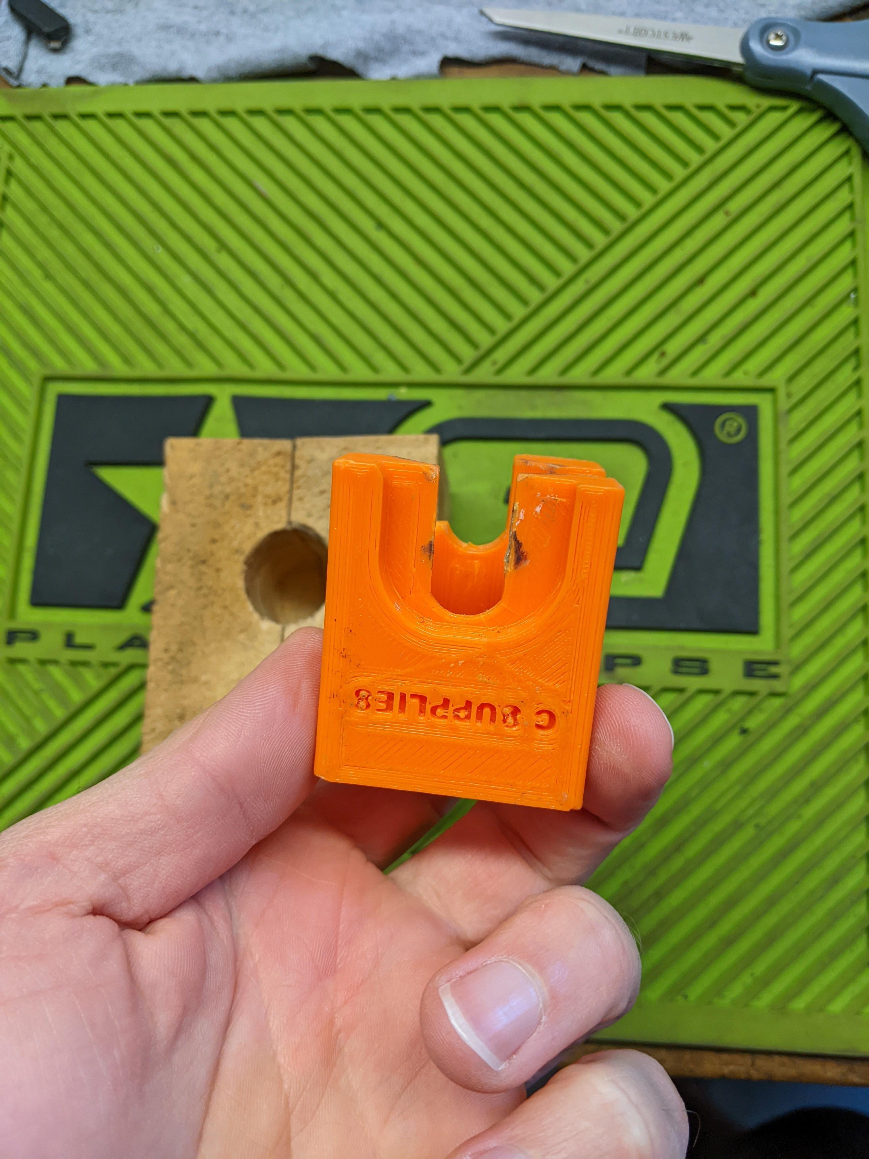

                  Here's a pic of the 3d printed tool I had. I snapped off one of the pegs trying to remove a reg from a FS bottle. I heated the threads to soften the bond, but it still didn't break loose and I had removed everything but the fill nipple to get the reg to fit. Too much force and one point of contact led to busted tool. I haven't had many modern bottles with anything on the threads, but this one was certainly loaded.
                  As an aside, is there any concern about damaging the fill nipples, gauges, or burst disks (or their threaded holes) when using them to remove regs? I've always thought it was a large amount of force on small objects when you have a stubborn reg.
