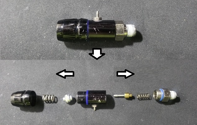

    So I picked up this little LPR with a few other items last week. As usual with used items I usually test, tear down, rebuild & retest.
    Well this simple little bitch is giving me a heck of a time. I hook it up to my bench test set-up... HPR @ 350psi screwed into an ASA
    that has a gauge port, then screw the LPR into the gauge port hole.... attach a gauge to the LPR nipple via Cocker lp line. I back the
    knob all the way off and then gas up the HPR. I'm figuring I'm probably gunna get a creeper.... but when the line pressures up nothing.
    It's holding zero, so I let it set for a couple minutes and its still holding. I'm thinking this isn't gunna need much so I start turning the knob
    to dial in some pressure.... the needle starts going up like normal and I stop it at 100psi and let it sit for a minute. Everything looks good
    so I cut the air to the HPR and bleed off the air at the lp gauge hose. So now the system is zero'd out. So I put the lp line back on and proceed
    to gas up the system again, figuring it should go to the previous setting of 100psi because I have not moved the LPR knob. So I watch the needle
    approach 100psi..... and I watch it pass 100.... 105....110...and it's not slowing down so I have to back off on the tank. So I go through the process
    of zeroing out the system and try again, same result. So I zero the system out again AND back the LPR knob all the way back off. I gas up the system
    and the the HPR gasses up but the LPR is holding at zero like it should, so I start cranking the knob down and set it to 100psi again.... all is good.
    That is until I zero out the system again and re-gas it.... it just blows past the previous setting of 100psi and keeps going.
    I have tried 4 different o-rings on the plunger, different duro as well. I have tried different lubes and different springs. NONE of those changes has any
    effect. The end result is always the same...... it woks only if you start with the system under pressure & the LPR zero'd out, then dial the pressure setting
    to where you want it. I have never had an LPR do this.... any ideas?

    Do you have the spring seat/piston upside down by chance? 3rd item from the left on the picture. It sounds like you got all the other troubleshooting steps covered, so the last time I had a creeping LPR was because I had one of the pistons or seats backwards. Really easy to do.

      Good suggestion, however...... Looking at the bottom pic at the piston, the nub on the left that the spring couples to is "solid".
      The nub on the right has a hole in the center about 3/32" that allows the stem of the dup seal assembly on the right to fit in.
      If it was to be reversed the shaft would have less distance and would protrude 3/32" further out on the right not allowing the
      nut assembly to screw in. Appreciate the suggestion tho...

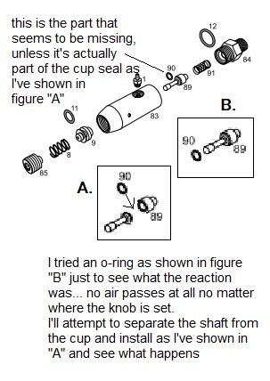

              I saw the parts drawing for the '04 wgp Cocker.... it has the same guts. Seems to have an o-ring listed/shown just before the cup seal shaft.
              However, no size or placement given

                THIS........... Click image for larger version

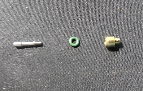

                  Hmmmm.... I'm gunna guess that these weren't designed to be taken apart, no threads on
                  shaft or cup and heat was needed to remove the o-ring out of the cup assembly
                  Click image for larger version  Name:	karnivorCUP.jpg Views:	0 Size:	76.1 KB ID:	328515
                    Jordan commented
                    Correct - non-serviceable, replace as a unit.
