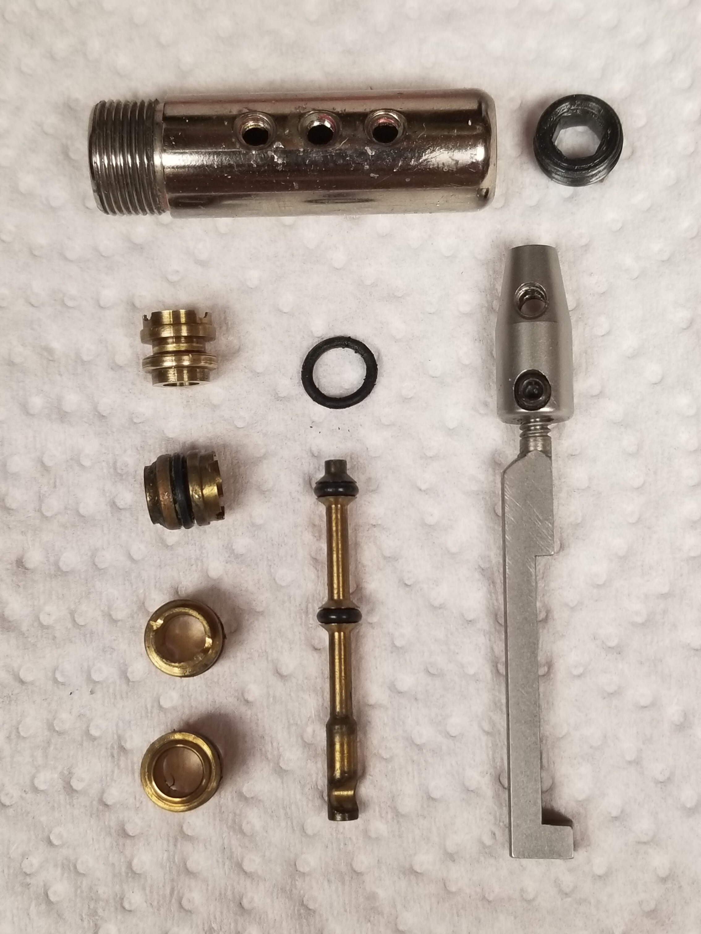

    I'm pulling apart my Revenge V2 for a deep cleaning because it's leaking a bit after sitting a few years.
    I pulled off the 3-way and completely disassembled it. The internals are modular!
    Here's a pic while I'm still cleaning it up.
    So, what type is this? And what size are the original o-rings? 20200919_222708-2.jpg

    Been a while since I've torn one apart but it looks like a PPS Quickswitch. I'm sure Palmers will sell you the oring kit, but I don't know what sizes they are.
    • fullofpaint
      Hoarder
      • 494
      It's a Palmer's quickswitch. They used to have a manual for it but seems like between the new MCB and Palmers site it's gone. They take normal 3-way o-rings on the stem so 003's and the cups should be 046x.224.

        Great! The orings on the valves fell apart when I removed them....so that was likely the leak issue. Hoepfully I can find a manual to make sure I put it back together correctly once I have the new orings!

          Got my seal kit in the mail today (along with one for the ram). Put it back together and NO LEAKS!
          Now I'm waiting on the new o-ring kit for the Armageddon...

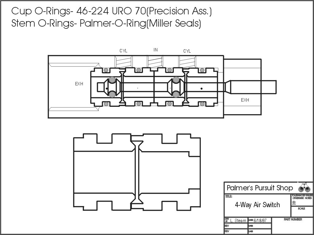

            BTW, here's the assembly guide that Palmer's sent me.... Palmer4way-assembly.jpg
