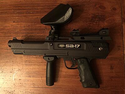

      I find that for me they’re a little too chunky and heavy of a marker to feel really good as a “pistol” strictly speaking (my USP fits better into that role), but with a foregrip and a micro hopper they feel juuust right as a little SMG/machine pistol type deal. When I get the bottomline situation figured out I’m going to run mine with a forward facing ASA to a 13/3000 (or a dual 12 gram changer for outlaw play), to keep the compact profile. And the foregrip does wonders for getting that 12g changer latch open, like your rope handle.

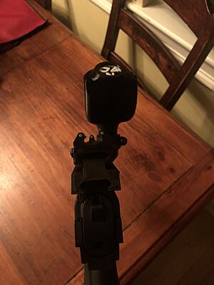

      I recently picked up an angled rail for the back riser and some neat 3d printed iron sights (made for nerf guns lol). Now it sights like a SMG and is actually pretty damn accurate to boot! And I don’t have to look at that ugly (but useful) little aiming knub thingy haha

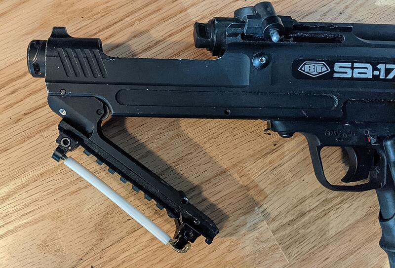

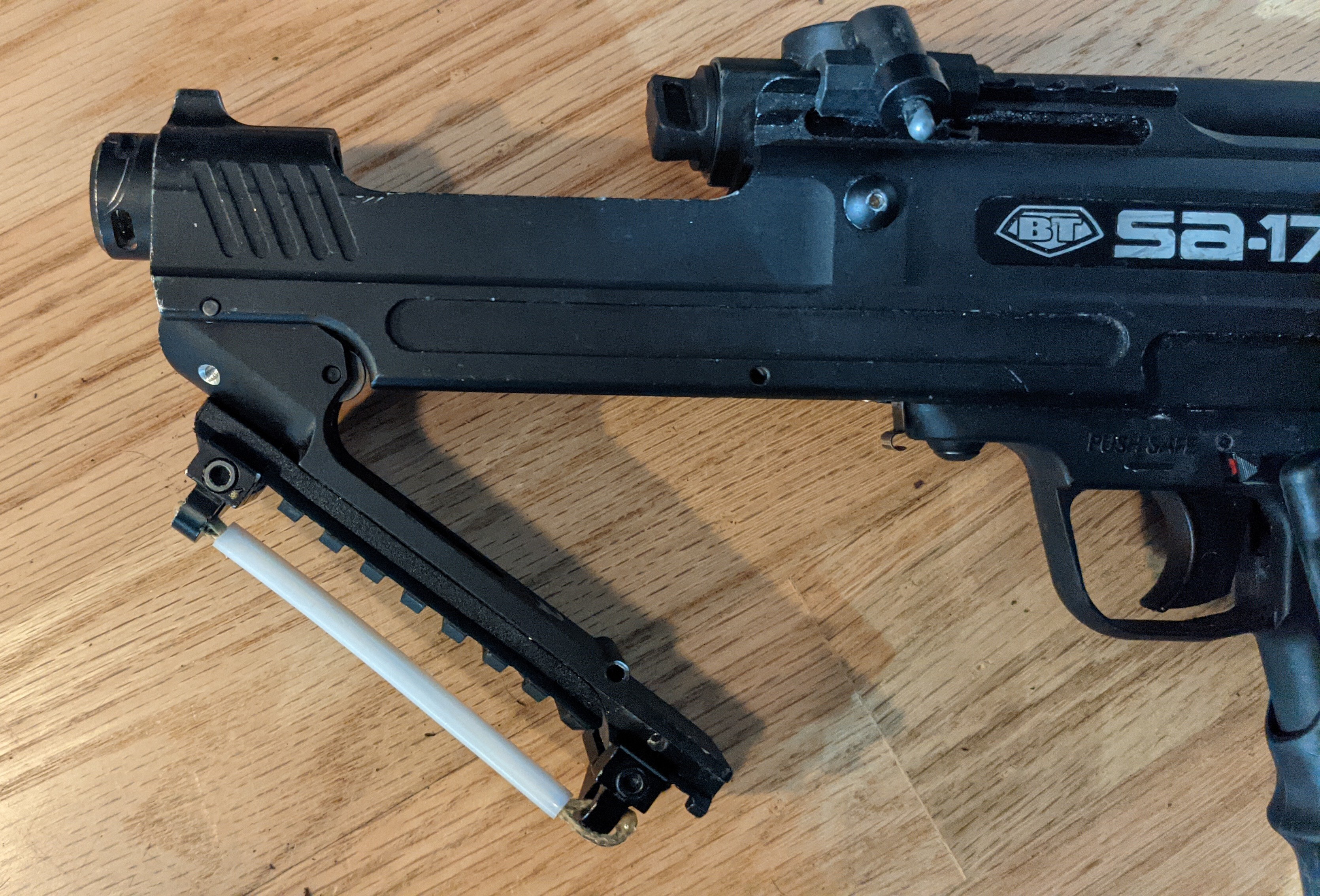

        Here is the handle.
        also freaked the tip so I use freak insert instead of the "barrel insert"

          Slick! How’d you mount the rail to the underside of the 12g latch? Bolt/washer combo on the cutout in the center?
            XEMON commented
            Drill and tap mounting screws. There is no room for washer.
