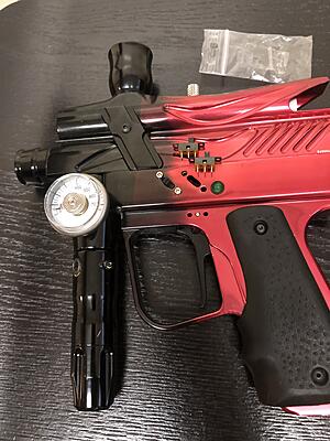

    I have a B2K4 with PDS that I got in a box of PB bits and masks earlier this year. Threw an Empire reg on it since it was on hand already.
    I’ve read through some upgrade threads on PBN (https://www.pbnation.com/showthread....8#post29472238)

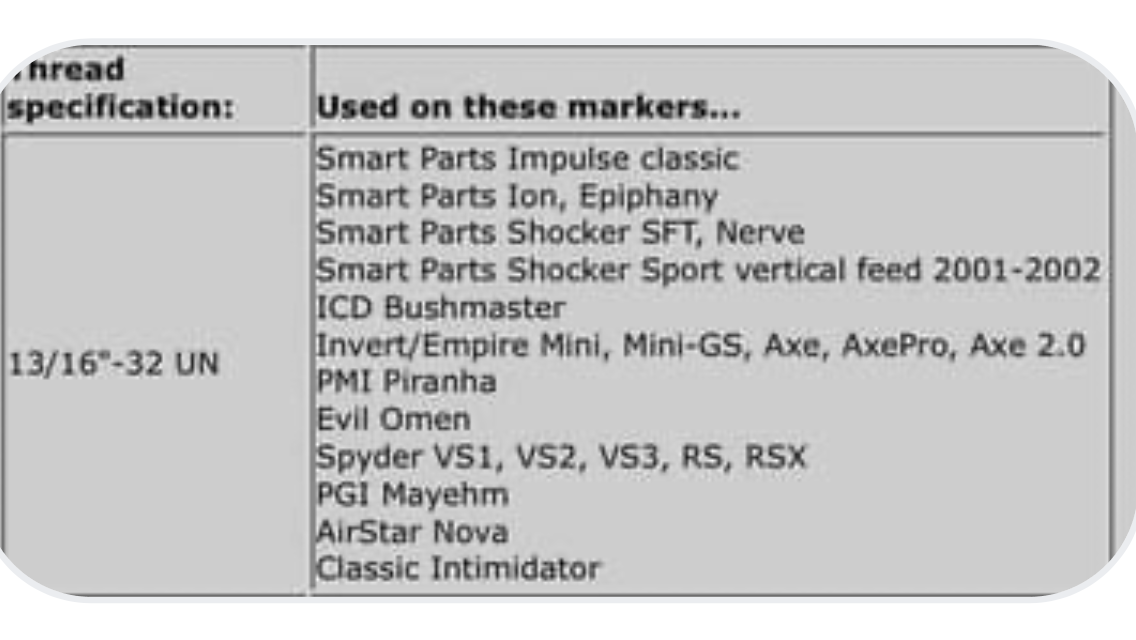

    • A clamping feedneck is a must since it still has the old stovepipe. The threads are 13/16” x 32 tpi per the link above, but which “standard” named thread is that (I.e. for which gun)?
    • I’ll also get an on/off asa.
    • I have the stock barrel, but the B2K4 is A/C threaded, so I have barrel upgrades covered.
    • There are wires that have broken and one switch is bad. Already have the replacements.
    Anything else that really needs upgrading? Guessing everything else is stock.

    So, technically the ICD feednecks are a different thread, but ION threaded feednecks can work, and is often what is sold under the "ICD" thread option. AKA, CP if you can find them, and Inception Designs empire style stub (I found one on eBay) are all good choices.

      Hi zinger565, is the Inception Designs empire style stub the same thread as ICD Bushmaster / Defiant feedneck thread? Helion said it was, but I wanted to hear one more similar opinion before buying one, cheers, M7

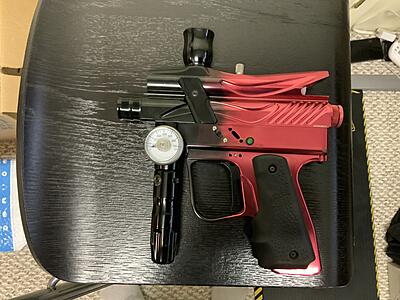

              Finally getting to this project after selling other stuff.
              I bought an ICD feed neck from ICD. It’s not a lever clamp, but it should look nice and will hold a hopper on just as well.

              Meleager7 Here's a thread chart I have that will help.
