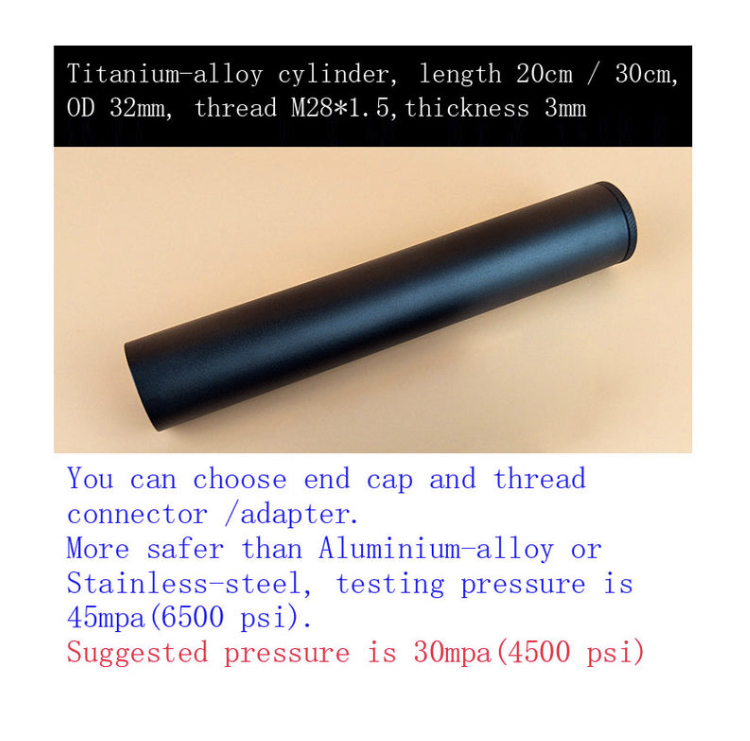

    Anyone know what the heck to make of this?
    They seem to be manufactured by some company overseas, almost everything is misspelled on the website. Now of course the phrase “More Safer” definitely puts one’s mind at ease when followed by “4500psi,” but...is the core concept sound here? I guess I cant think of any reason it wouldn’t be?
    Basically what you’re looking at is *allegedly* a titanium alloy 7.8”x.8” (if you had the 20cm version) cylinder, that holds .1L, so a little over 6ci, and can *allegedly* be safely filled to 4500psi. So what, we’re talking like 90 shots or so out of something like this?
    I mean, would that not be a game changer?
    The sketchiness of that site is more than enough for me to not buy one, but perhaps some reputable manufacturer could make something like this one day? Or has this ever been done? It’s all news to me.
    Gotta say I’m tempted to buy one not to actually even try it, but just to examine the build quality. But I fear that would inevitably lead to me eventually trying to fill it, and there’s probably a nonzero chance I could end up with one of those endcaps embedded in my skull, so nah.

    Unless it's got a DOT stamp, you can't fill it.

      I think you could fill one of these in like 3 minutes with one of those sketchy hpa pumps that are also made overseas lol. Not saying you should.

        Those are basically unregistered, DIY suppressor cans. Be very careful buying.

          This was my immediate thought. "boy, that looks like an ATF bait site..."

        Ecap has one of those reg testers that are a lil bigger than a bucket changer. Probably only get a few shots off it tho. I forgot who made it powerhouse I think.
        yup probably only good for 10-20 shots

          If someone buy one, at least get it hydro tested before using it to make sure your specific tank is safe to use up to a specific pressure.

            these are routinely used on PCP airguns.
            you don't fill directly from a commercial compressor at a field, store, etc. use a hand pump, scuba, or your own compressor to fill to desired operating pressure, most won't set their pressure higher than 3k, i won't.
            aren't designed to be removed, basically air chambers that screw into the valve body directly. regulators built into the gun valve.
            lots of overseas junk out there, but there are also machinists making rock solid safe and reliable "safepaks" as they are called. Google "PCP airgun" and you'll see what I'm talking about.
            when buying something that looks like a supressor, i only buy it from airgun dealers and order pellets with it since total legit to silence an airgun so ATF can eff off.

              Had a feeling there’d be someone who knew exactly what was up with these. Thanks for the insight.
              An internally-aired marker with a non-removable hpa tank would be an interesting concept, if for no other reason than to see how clever the manufacturers could get with disguising the tank into a sleek design. Kinda like those stocks they have that go over 13/3000’s, but more...internal haha. Sounds like something that’s prob been tried before.
              I’m sure it would be a pain in the ass in practice, but the mental image of a bunch of people waiting in the fill line to plug in their entire markers is kind of funny to me.

                I looked into PCP rifles for a while, and the commonly have a forearm tank. Pretty slick.
                Not sure how reasonable it would be for a full length game with anything but FSR, but maybe with a Ninja PCP-regged remote tank it could be fun. Carry a 45/4500 in a pack, with a whip to charge the gun on the field.

                  wouldn't buy us much in paintball. we need too high an air volume to move our .68ish caliber water balloons. tanks need to be big.
                  if we were to try to hit a modern paintball with anything more than 850 psi i'm not cleaning up that mess. slamming the back end of a .50 caliber lead slug you need the extra pressure to get any kind of range.
                  i'm looking at pcp conversion on a crosman 2240 i'm butchering right now lol. Even if I put a beautifully machined aluminum chamber on it for close to 100 bucks i'll only get 7 shots per charge. and that's with about 15 gr .22 lead rounds. a high pressure fill line from a unregged remote bottle is probably my better/cheaper option for bench shooting. or hell even straight from my scuba.

                    You’d put a regulator on a tank like this for any sort of projectile shooting application (unless you fancy your paintball gun turning into a real live grenade!) and match the output pressure to whatever your marker is set up for/what you yourself have set the marker up for. For example, my Emek is allegedly supposed to be able to go as low as 135psi, though I have my doubts. Generally with any modern non-CO2 marker the ideal operating pressure is going to be less than 850psi, some by orders of magnitude. So that 4500psi number for the tank pressure will get divided into the output pressure of your marker, and the ultimate level of shots you’d get would be based on that plus the volume of the tank. They don’t make a paintball gun capable of operating at 3000, let alone 4500psi, people would die lol.
                    On a “normal” marker (I honestly forget what the operating pressure is assumed to be for this rule of thumb equation), the rough estimate is 10-12 shots per cubic inch on a 3000psi tank, and 15-17 shots per cubic inch on a 4500psi tank (though there’s obv lots of variables at play here).
                    So on a 6 cubic inch tank like the one in the picture (and 6ci is well below the smallest typically commercially available hpa tanks, the smallest ones easily found are generally 9ci), you could make the rough estimate that you’d get about 90 or so shots.
                    Hope that helps! It took me quite a while to wrap my head around it personally.

                      the shot math is nothing new. if someone wants to invest time or effort into it go for it. the cost per shot is going to discourage most except those that have to do it for the sake of doing it. i mean you can get a 13/3k with all the safety measures built into the design, regulated to 850 or lower if you want, and is rebuildable for 60 bucks. don't let ebay prices fool you into thinking this is a cheap alternative, it's not due to new filling equipment needed, etc. a lot of those ebay designs are ticking time bombs that haven't been fully tested to 3x their operating pressure for an appropriate safety factor.
                      only reason pcp shooters bother with any of the expense is the performance at higher operating pressures.
