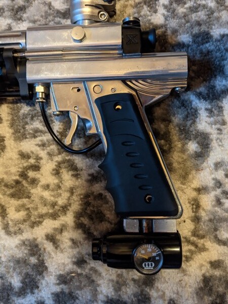

      So, i ended up picking up an early Empire ASA reg. the one with the rail on the bottom.
      My first cocker built is nearly done, just a few leak to track down:

        I moded the frame to be an air-through frame, I may make a build thread in the cocker section if people are interested.

                lew summed it up ... I have done it enough times ...
                But, this is an air-through project. I needed the air line to go through the frame and be as small as possible.
                My first version had a female stab with the outlet facing up (through the bottom of the frame). It was really long, I wanted something smaller.
                So I got this going. It's the same size as any regular asa and has the outlet towards the top, so no wired elbow and tubing trying to sneak under the grip panels ...
