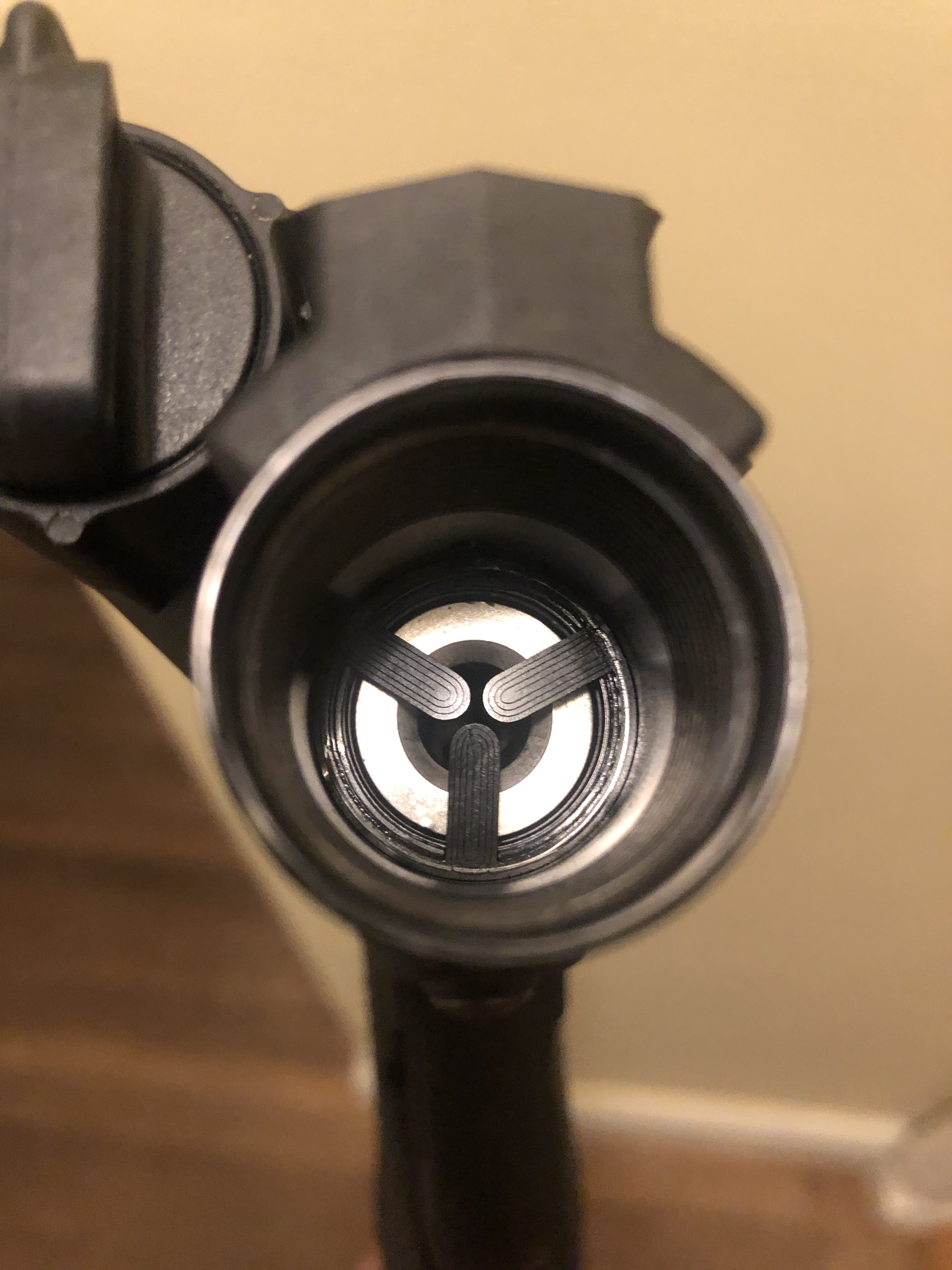

        Had this lil guy in my Trracer marker for years, still works flawlessly
          Same, I still have the original one in my cocker pump
