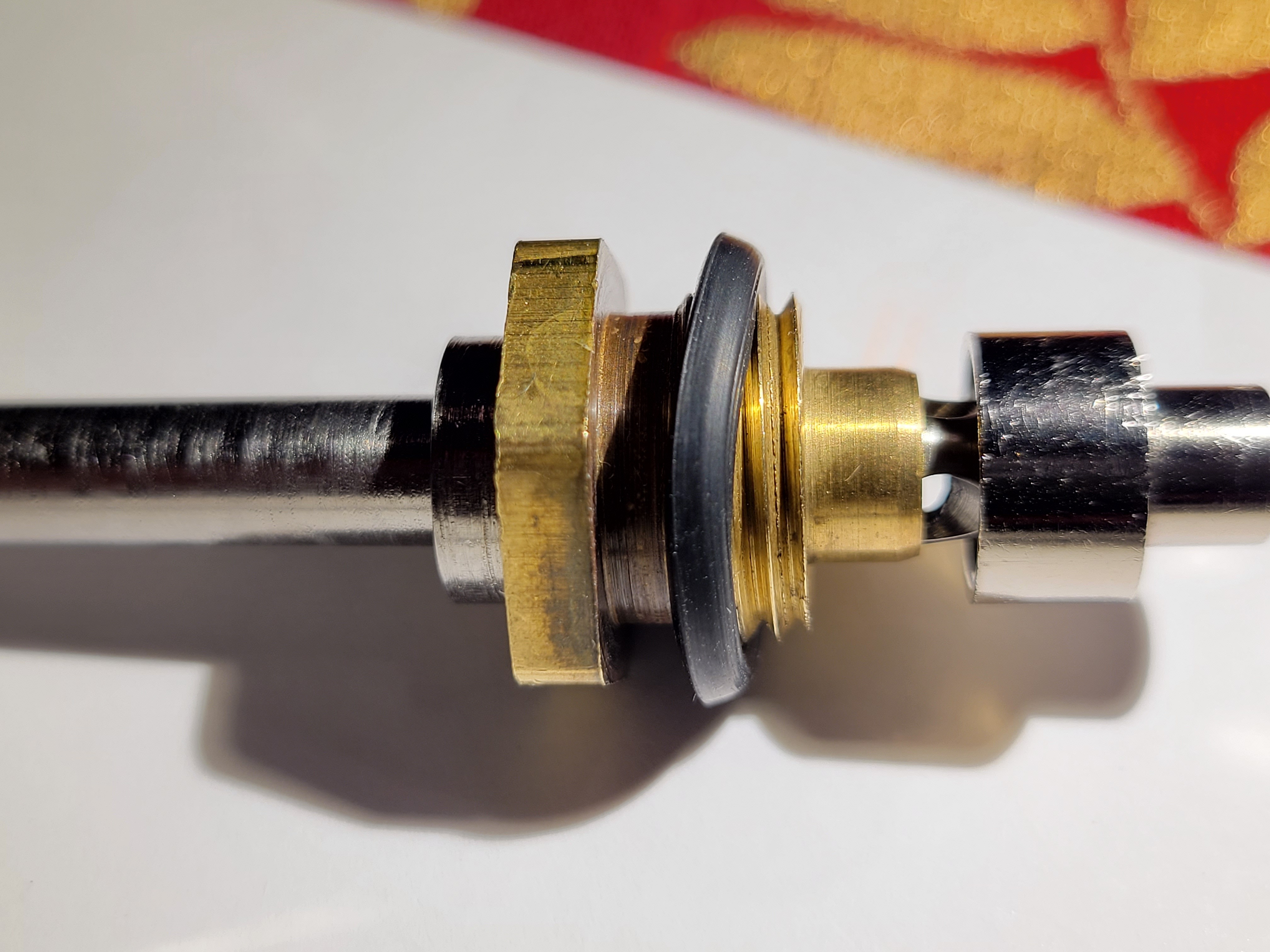

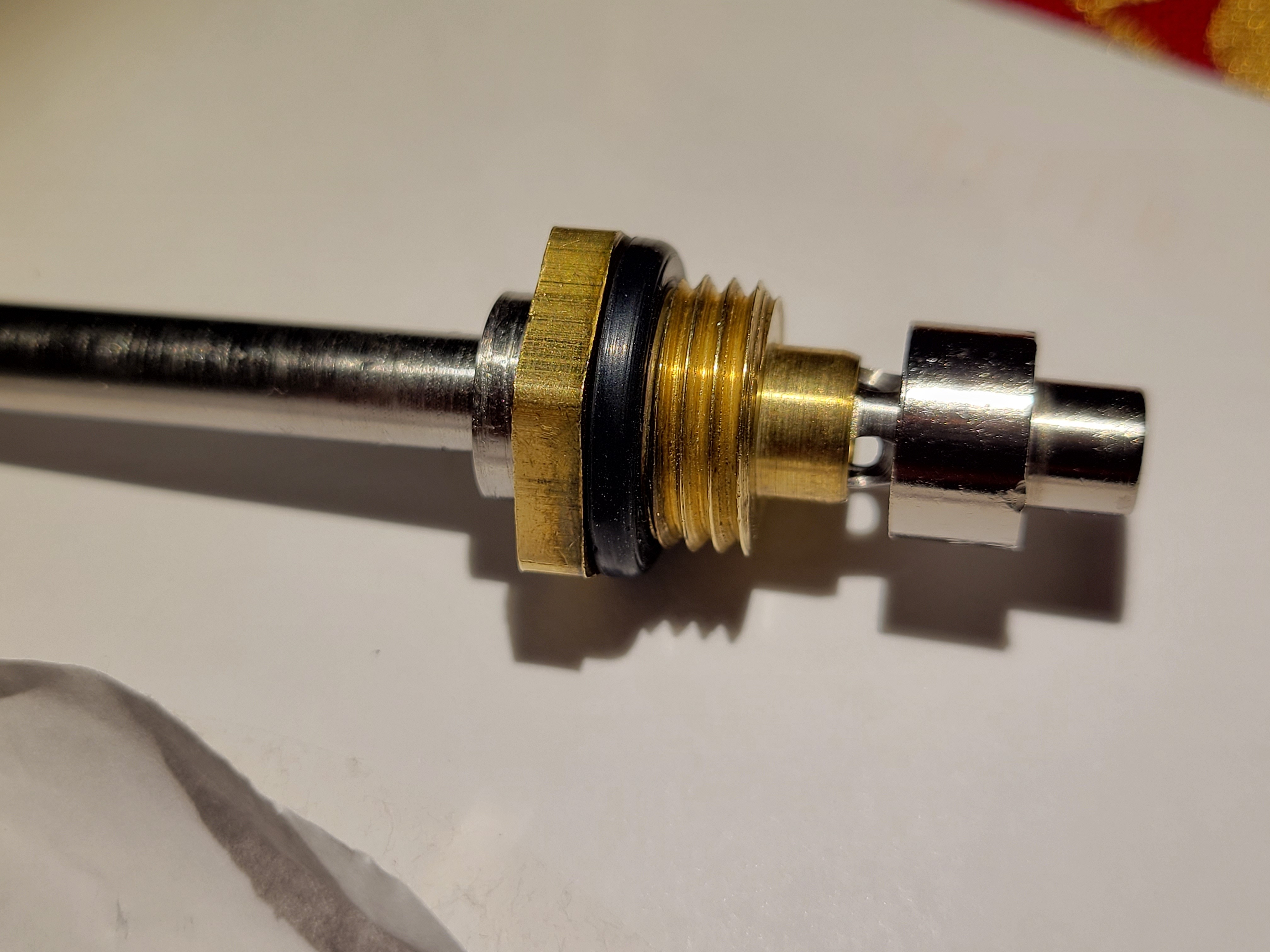

          Yeah, I'm thinking you're probably right. I'll give it a try. Definitely appreciate the help. Also, I might create a separate thread to ask this, but my powertube assembly seems to have an odd oring that appears to be flat on the back side and somewhat rounded on the front. I can't seem to find anything like it online. Is there a name for this type of oring or somewhere I can find these? I attached a couple pictures showing it in its correct position as well as pulled up so it can be seen better.
          • Brokeass_baller
            Brokeass_baller commented
            It's a standard o-ring, just deformed from use and squeeze. I owned two Diablos in the past and fixed them with standard Bunas.

          Okay, thanks. That makes sense. It looks like one of the orings I already got (size 112) to try with the bolt will also be a good fit for the powertube retainer.

              For the bolt, I went with a 11.91mm ID x 2.62 CS buna 70 oring that I got from theoringstore.com but I think I could have also used a regular size 112 buna 70 oring. The first one seemed to be a tiny bit better fit though. For the powertube assembly, I just used the size 112 buna 70 oring since it seemed to be a perfect fit in there. That one I had originally got at phantomonline.com (it is the bolt oring for phantom pump guns)...but I'm sure I could have used any size 112 buna 70 oring. The gun shoots well now. Only have had time to shoot it out in the yard but I got one of those handheld chronographs and after adjusting the gun's velocity adjustment, it's shooting around 270fps. I did also end up replacing the valve spring and the main spring with green ones that I got from baccipaintball.com. Those green springs are both listed on his site for the Kenimex gun but they are a perfect fit in mine as well. Before I changed those springs, the gun's velocity was a little more erratic. Maybe my original springs were more worn out.
