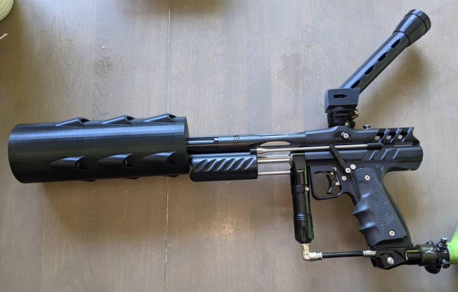

        I had a pump cocker that was completely silent. You literally couldn't hear it shoot. I am not sure if it was the trigger, LPR. or what. Here is a pic:
          You have got the most deliciously weird sense of humor
          Cdn_Cuda commented
          Stick feed with an autotrigger… sigh.
