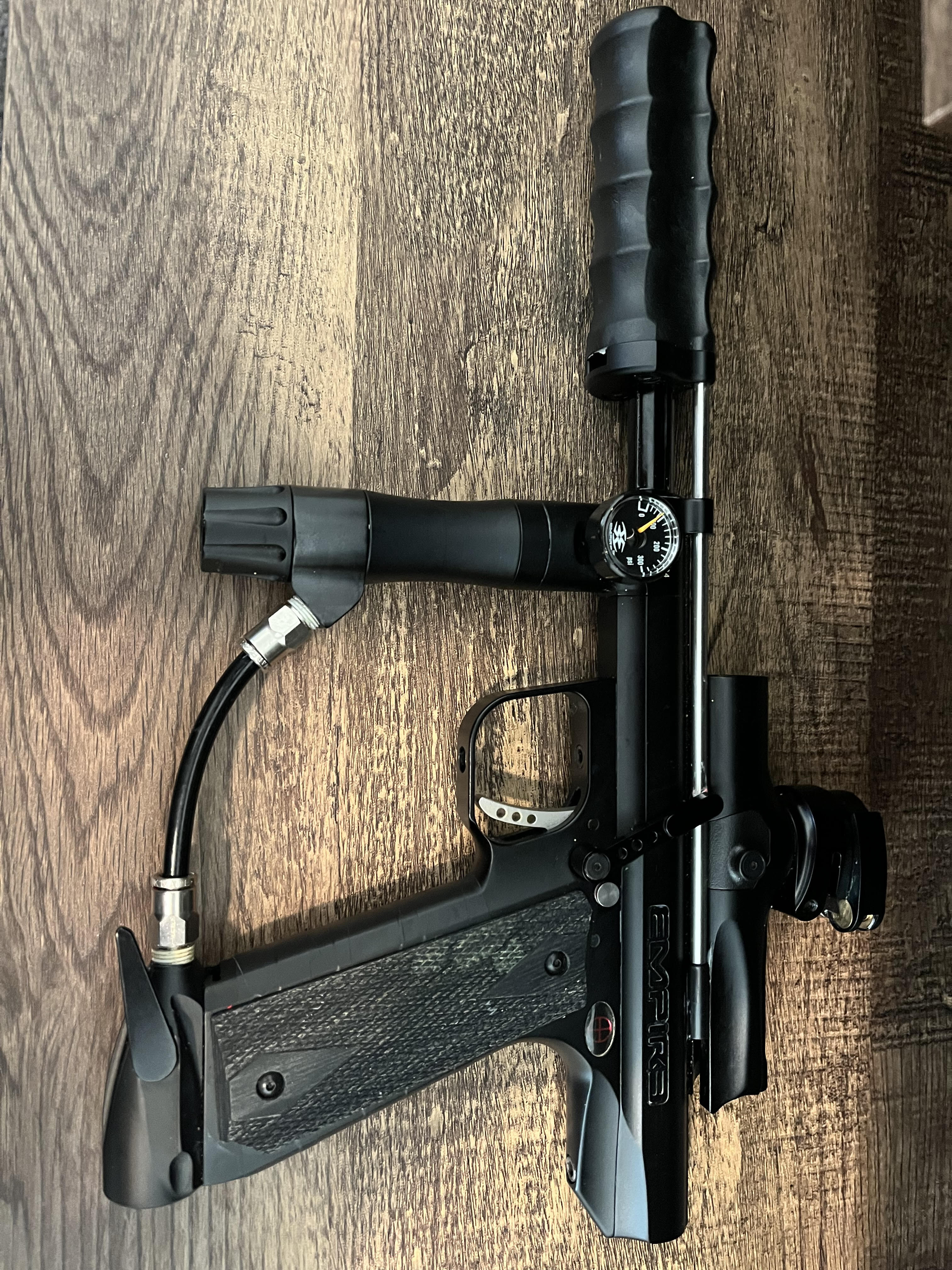

    I was out playing with my Empire Sniper today and it suddenly stopped shooting. Essentially, I'd cock it, pull the trigger, and there was no air getting behind the ball at all. It was as if I was shooting it without an air tank on it.
    There aren't any leaks that I can hear and the marker airs up just fine. Its just that no air at all is getting to the top tube (?) when I pump it and pull the trigger. All I get is the same click that I'd get if the marker wasn't aired up at all.

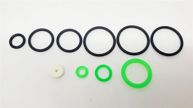

          Here is a rebuild kit, with the better seat: https://www.inceptiondesigns.com/HPR...p/cgp-0040.htm

            Here's a picture of it reading ~100 psi while de-gassed.

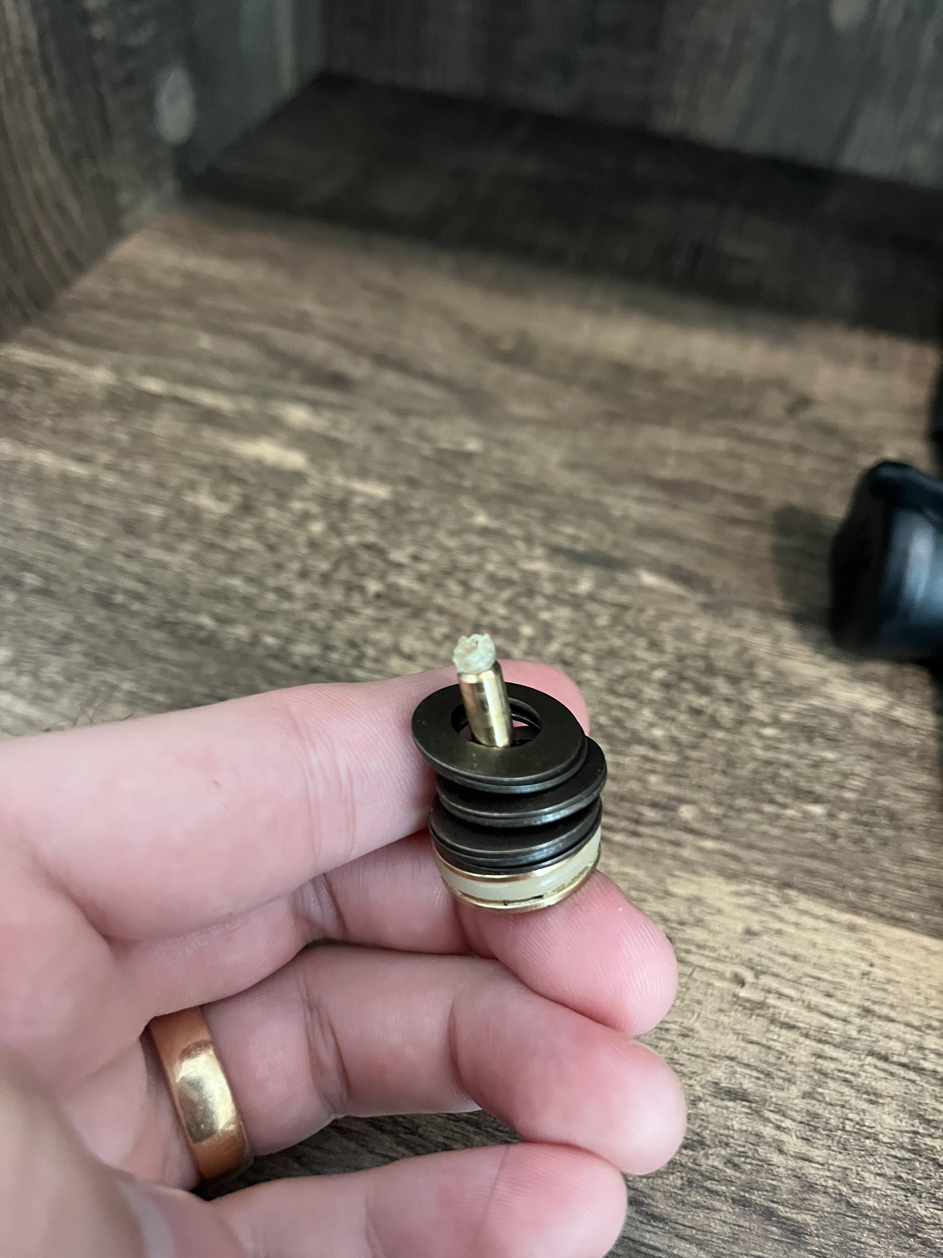

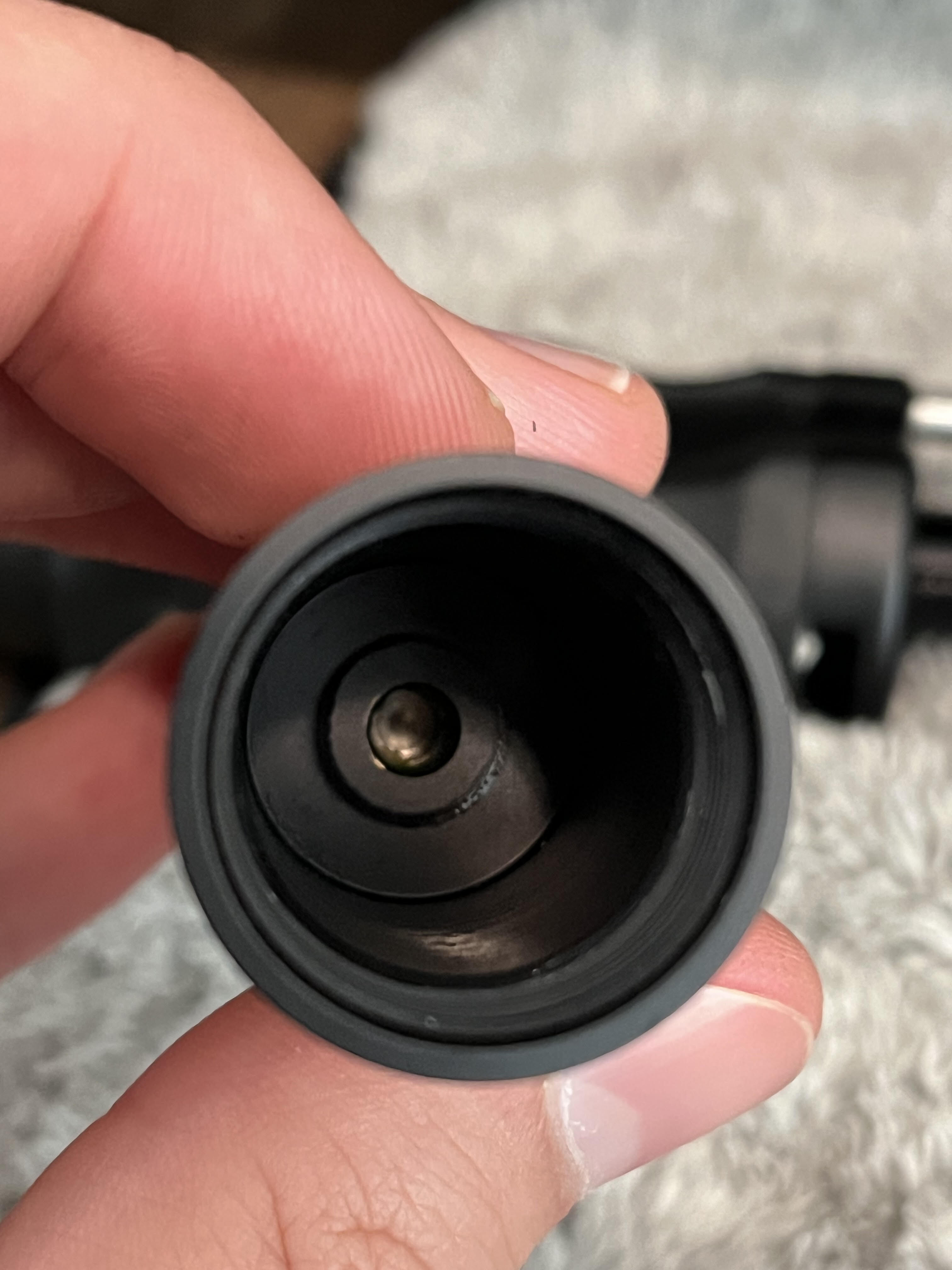

                        I took apart the reg as much as I could without pin pliers and found that the regulator piston was covered in a bunch of gunk. Not sure where this came from, but I suspect it came from the bottom portion of the regulator that I can't access yet.
                        I think the "gunk" on top of the regulator piston is what's left of the o-ring that sits on top of the regulator retainer. Looks like it got completely torn up to the point that its just a glob.
                        I'll have to take a run to the hardware store so I can get to the internals in the bottom of the reg to replace the o-ring, but seeing the piston totally blocked like this in the picture must have been the problem.
                          • 6185
                          That would be what remains of your regulator seat. Superman nailed it
                          Rebuild, all o rings and in this case, replace the regulator seat as well

                            Here is a rebuild kit.
