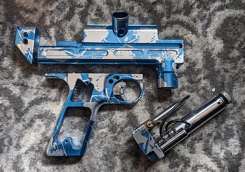

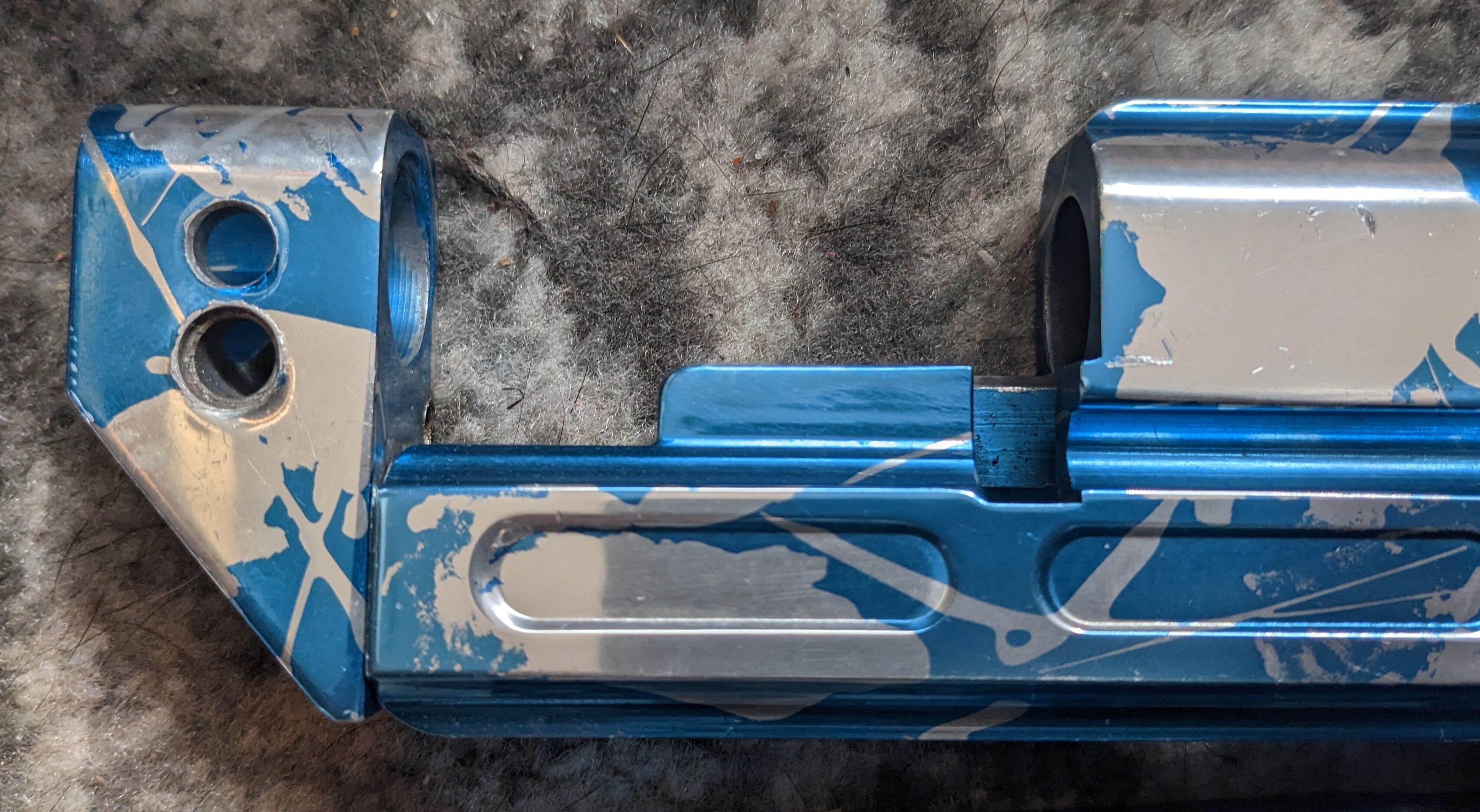

    Hello y'all,
    I traded this cocker with Loophole and it's got some unique machining on the back ...
    Now, I'm no cocker guy, but I know some of you are ...
    The ano was done post machining, but it seam to have decent bolt wear on the rounded top.
    IS this a home brew milling?

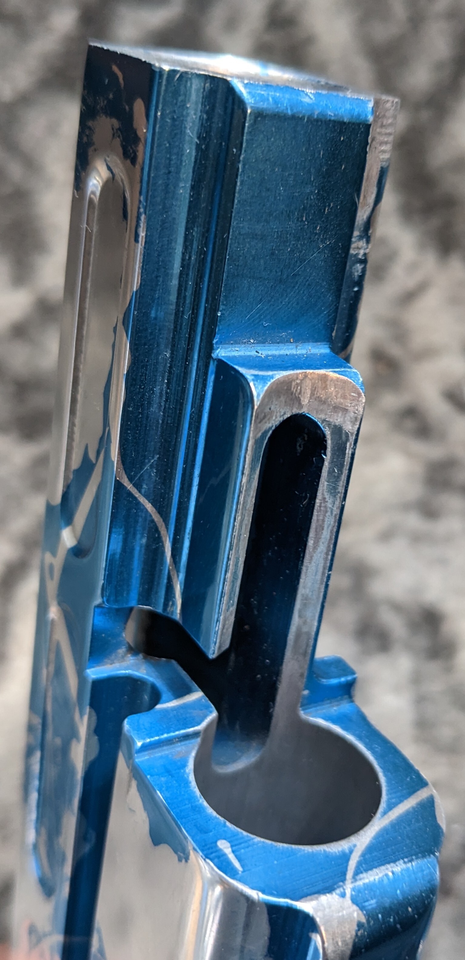

    Any idea what the notch on the right is for?

    I actually might have some insight. When I first got it I did a ton of research into it. I found this video by Bacci about a Custom Bob Long Signature Series Autococker Paintball Gun that has very similar body lines.
    https://m.youtube.com/watch?v=KY-nqmnHEzc
    I am guessing it was a homebrew job after... but my guess is this is maybe what it started as? Just a hunch. I could be very far off.
    Bacci did an interview with Brad Gadberry and he talked about only doing minor milling jobs. So my guess is this is a Brad Gadberry body that got remilled and anodized.
    I can't wait to see you get it up and running!
      XEMON commented
      the milling on the lower looks just like it ... and its also got marching milling on the back of the frame ...
      Thanks for the video ... and the gun 😋
    • 4408
    It looks like a very early attempt at a half block job or a very Homebrew version. Not quite sure what it started life out as besides a standard cocker. The secondary hole on the back block is indicative of a Danny love rotobreach style bolt however none of the other milling on this is his style.
      XEMON commented
      The serial is 6299 so it would be a 92? (according to docfirepaintball)
      Whats a rotobreach?
      I thought those were angel breach ...
      Ecapnation commented
      That's what I'm calling it for lack of a better term basically it was a pin with one side cut and one side solid that you could rotate in the back block to remove the bolt. I have a few examples but they're not in my surface boxes
      XEMON commented
      I'd love to see a picture of you find one.
      I have no idea where I'm gonna go with it, but funky old is my kind of stuff 😋
    MCB member
    • 3511
    • Montreal, Qc, Canada
    Dont think its what it was intended for but you could male it bolt action with this notch

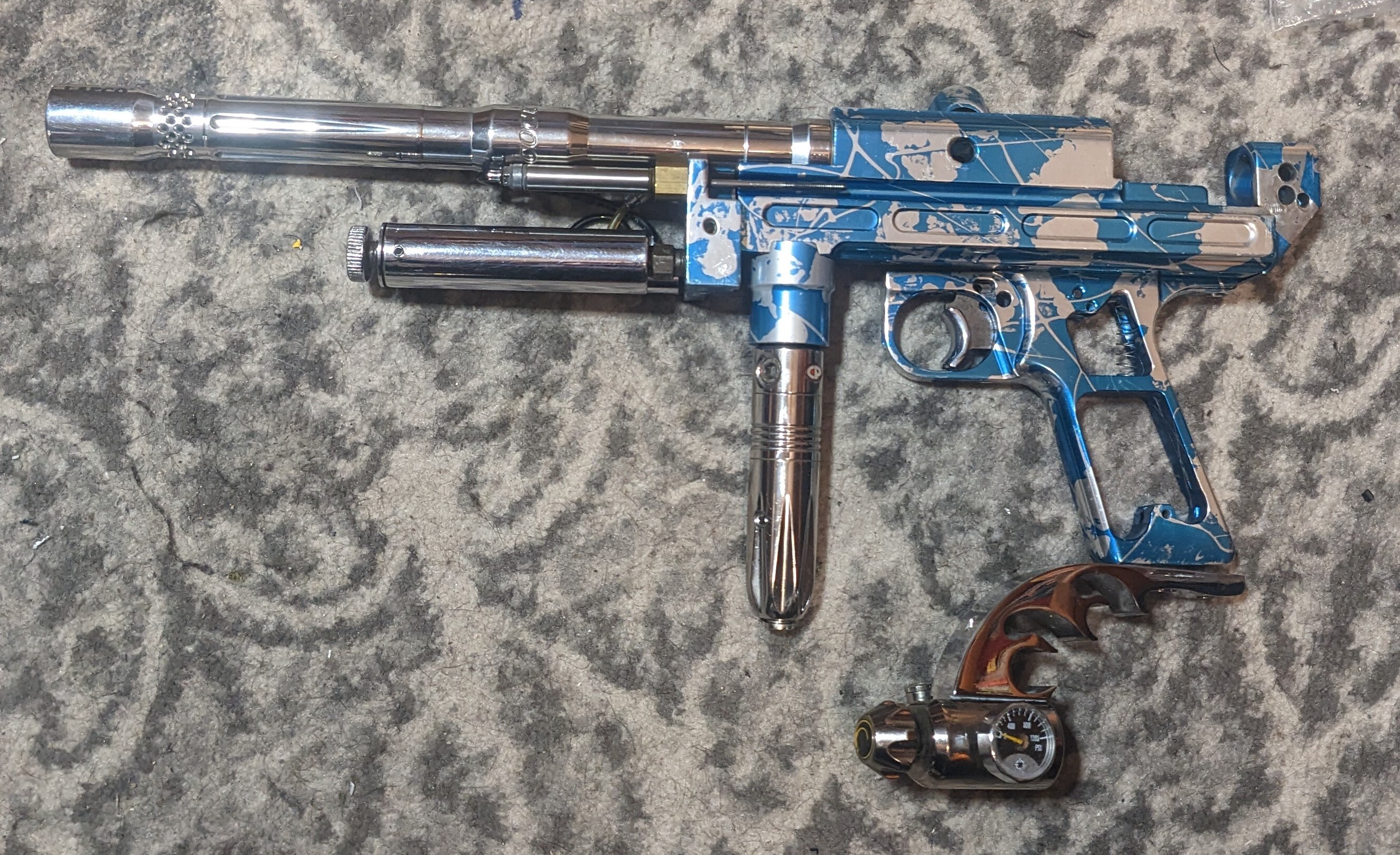

      Got all the "parts to buy" now it's time to make the rest and put it together 😅

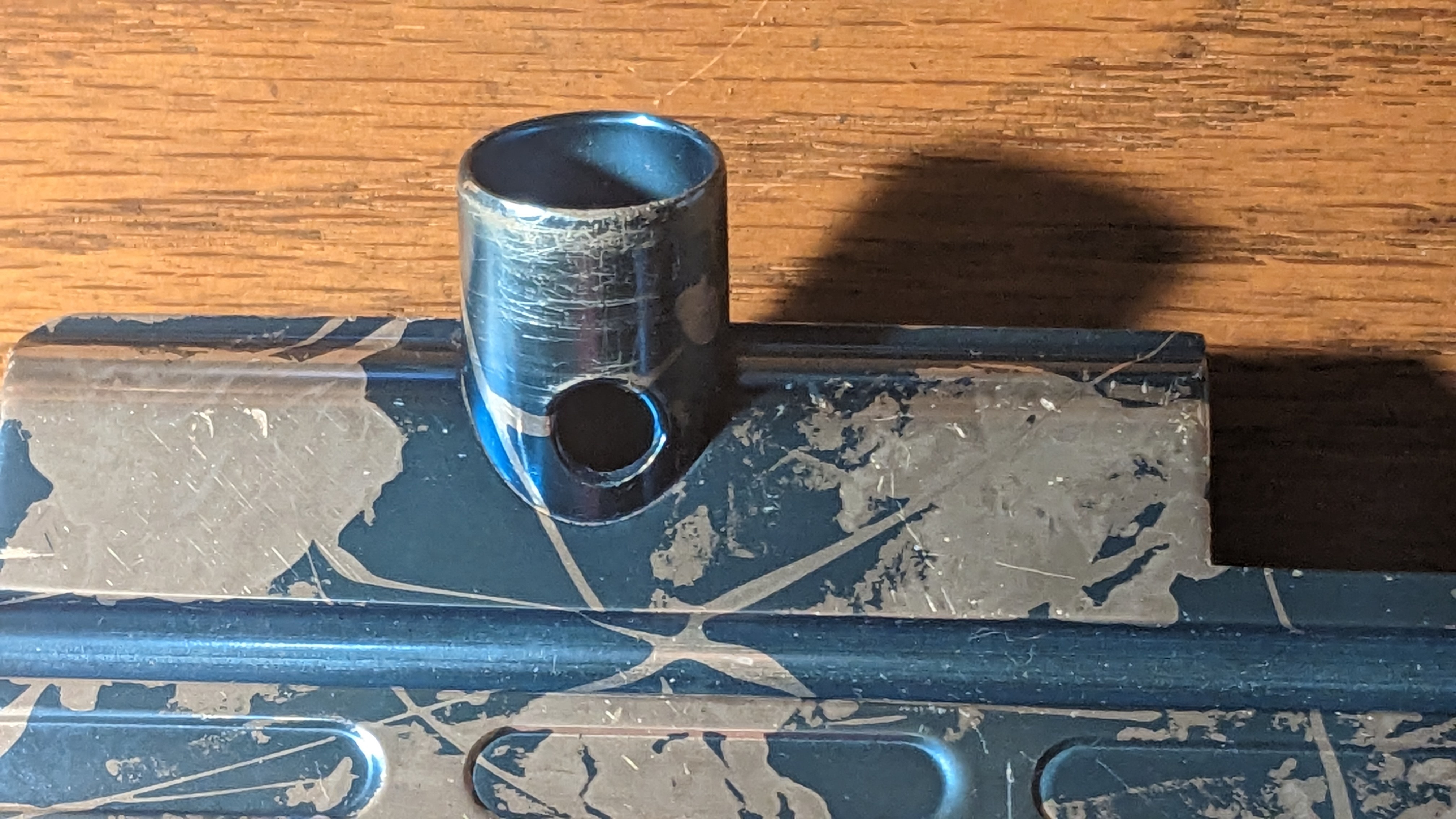

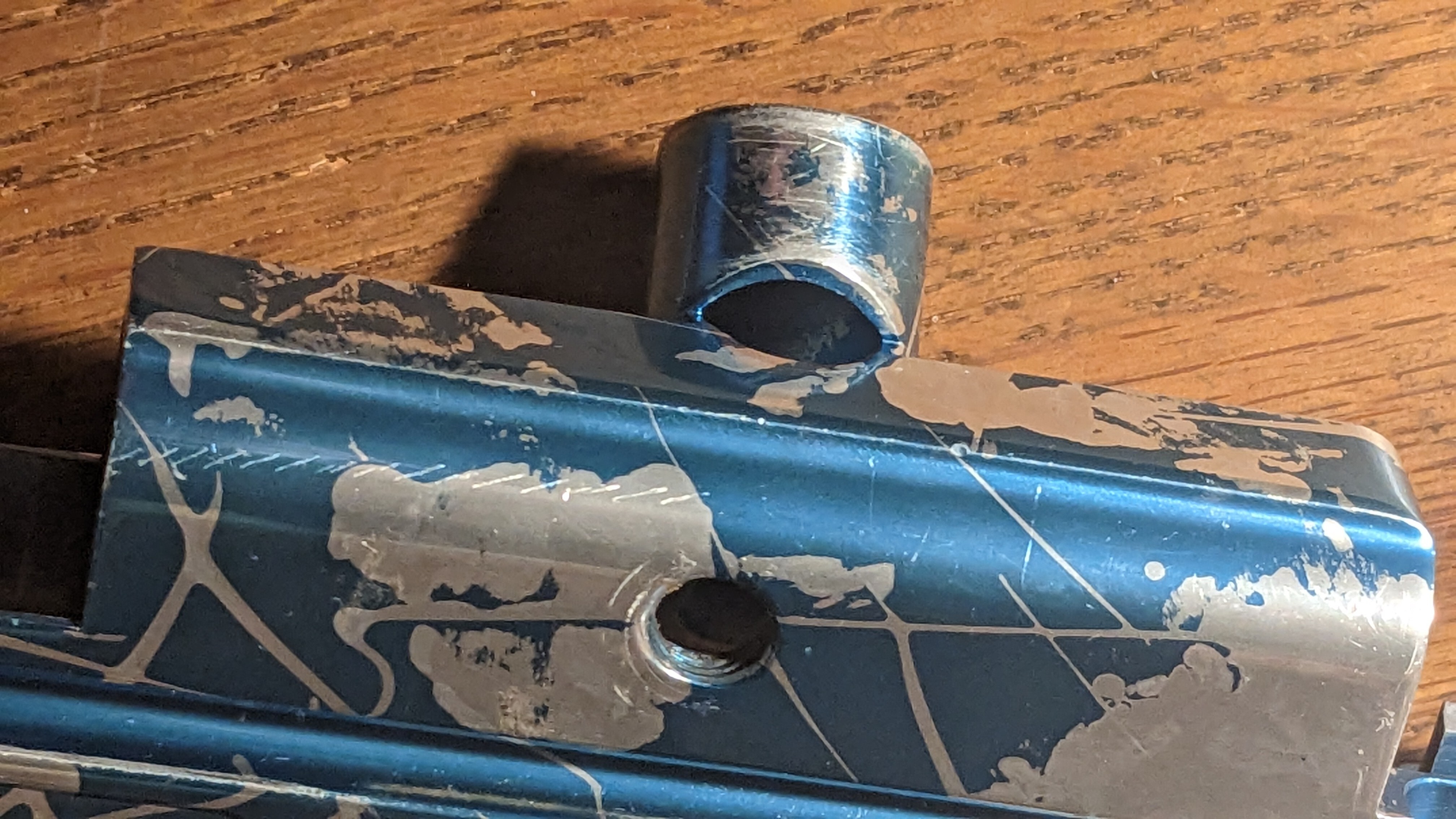

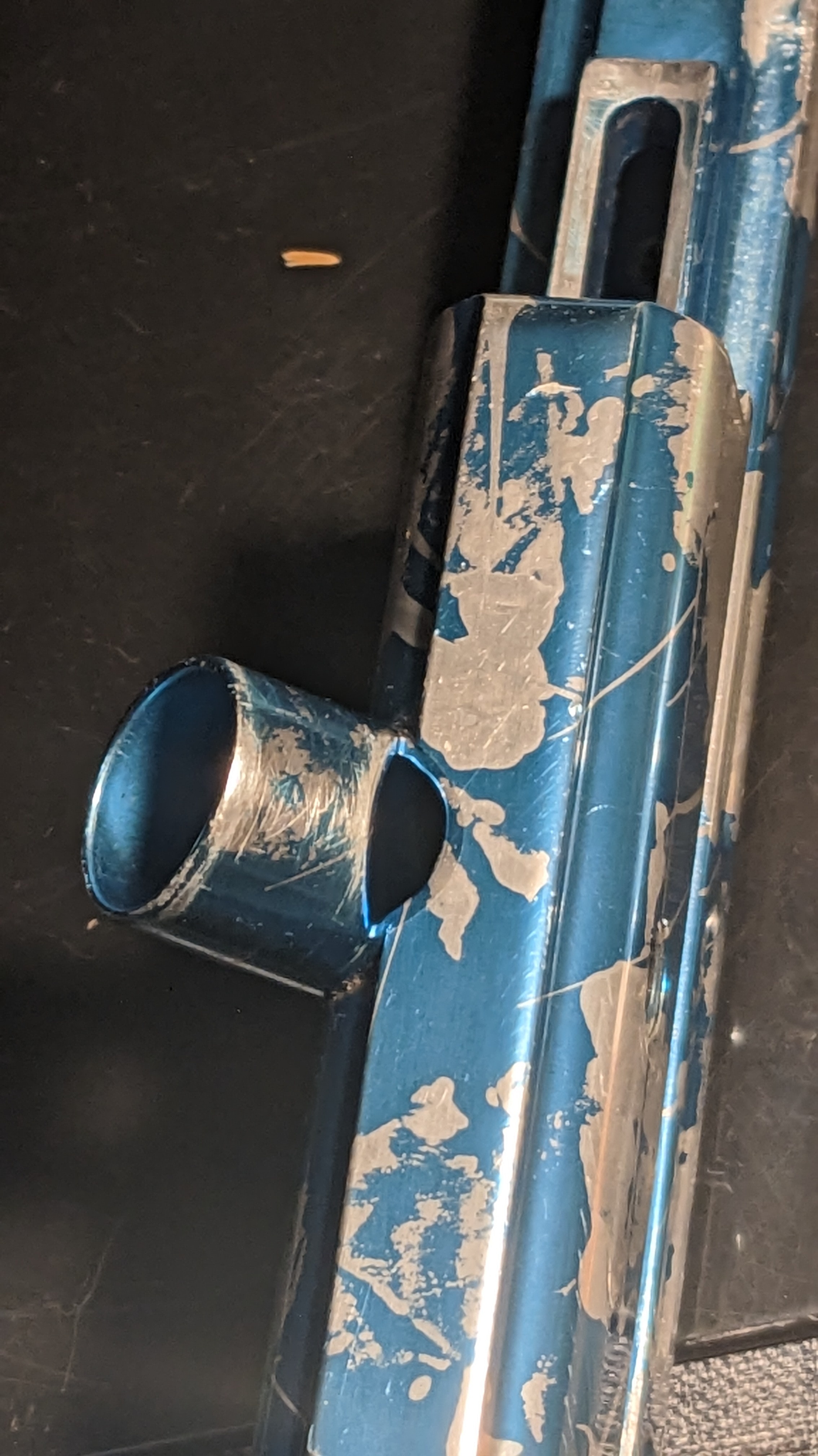

        Are there feedneck vents on both sides? Can you get a photo of either side?
          Frenchy is here!
          • 3019
          • Nor Cal
          Here are some details about the feedneck, does it help?
