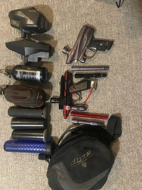

    Pondering picking up a local Gen 3 Alias Timmy. It’s missing its original reg and on/off and had donor parts from why looks like a PM series.
    Haven’t even held one of these before and I know they have a rep to be a pain to work on. Other than that, what are some things to watch out for or know? Board and solenoid like every other electro? Or are these simply a stay away at all costs? Not seeing a lot on the used market.

    You don't see a lot of them for sale due to the age more than anything. That marker is roughly 18 years old.
    The biggest deal will be availability of parts, especially eyes electronics and solenoids.

        I’ve owned over 60 Gen 2/3 BL guns and can say they’re still some of my favorite guns to shoot. They’re unique and you have to know what you’re doing to avoid fucking up threads and barbs.
        That’s a DM4. Also shoots amazing.

          Hmm. Looks like I’ll avoid it unless I can get it cheap. Something else has caught my eye as well.

            I'll second that. The DM4 was the first fancy marker I every bought, and it rocks. I still have her, and she still shoots great.
