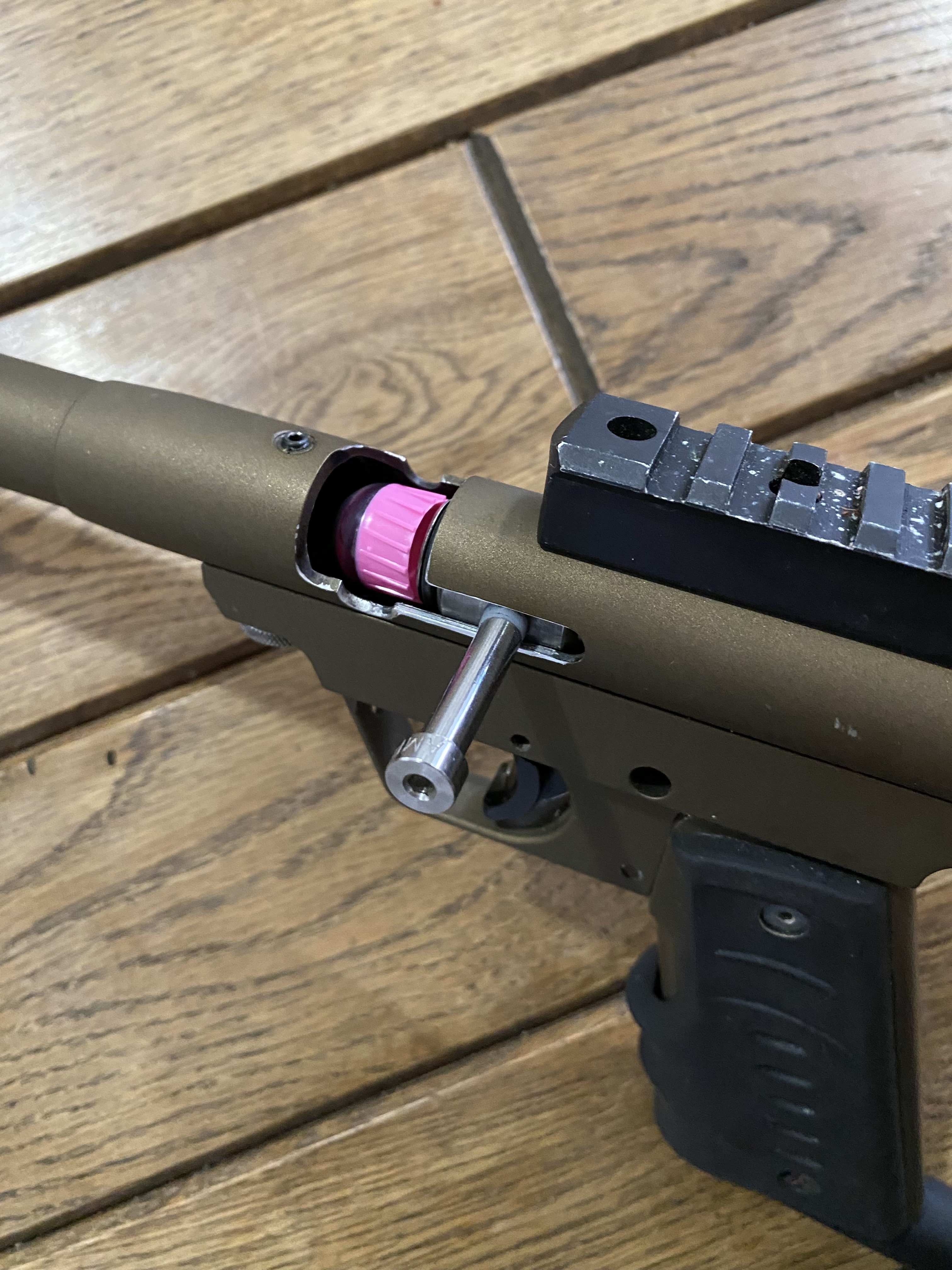

    Yeah single shot!
    I made mine from an asp cocker threaded breech so it can accept rifled barrels. I used a 10/32 shoulder bolt as my handle in the tpc set screw hole, on top of a little piece of oring to protect the threads and hold the tpc like the set screw used to do. Modified the breech with a dremel. The rear notch is really helpful when loading. I made a wooden stock from some oak board, not too difficult with a little shop savvy.

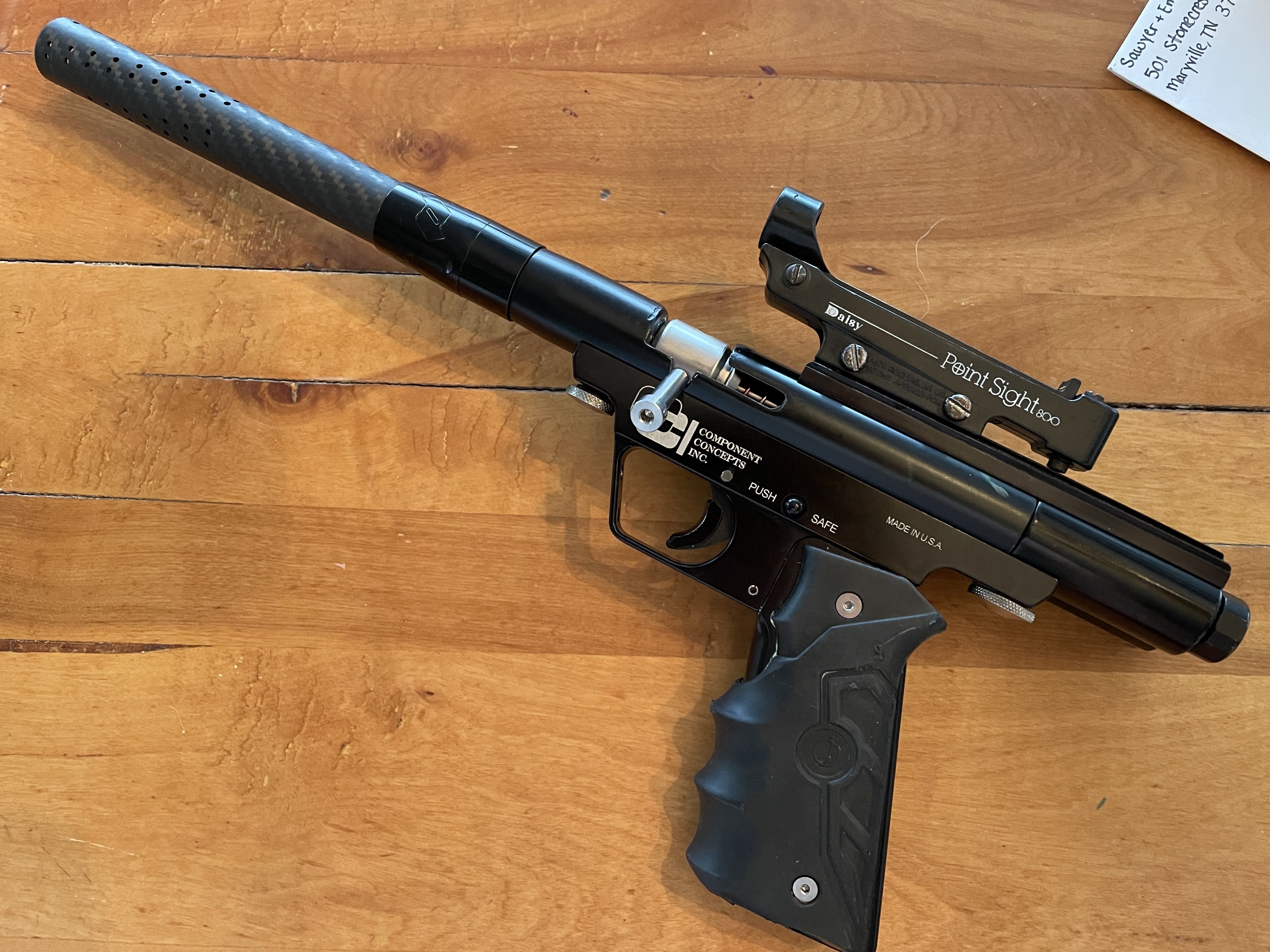

    the only pic of this one. Sold it a while ago….it had a 6” barrel with a Dishka Tip when it sold

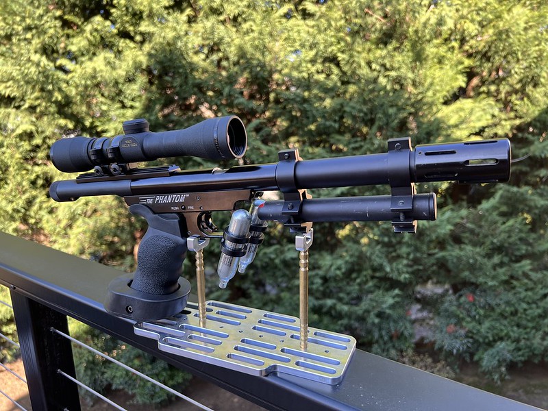

    My baby:
    haveblue cocker threaded body. Hammerhead rifled 20" barrel

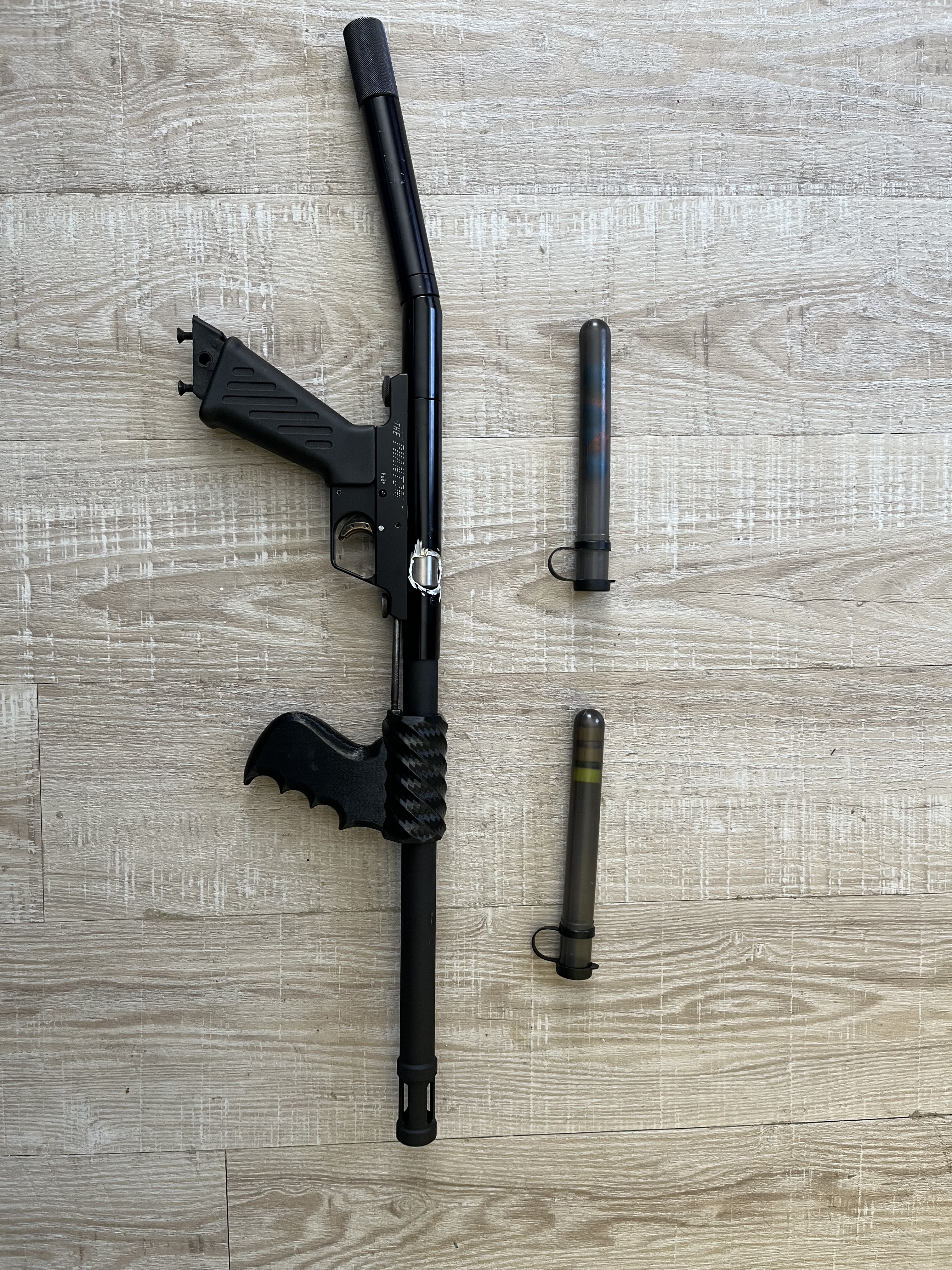

    Not a wood stocked one, but this is one of my favorite builds.
    Bolt Action "S-5 Heavy Blaster" Phantom inspired by a gun from SW: The Phantom Menace

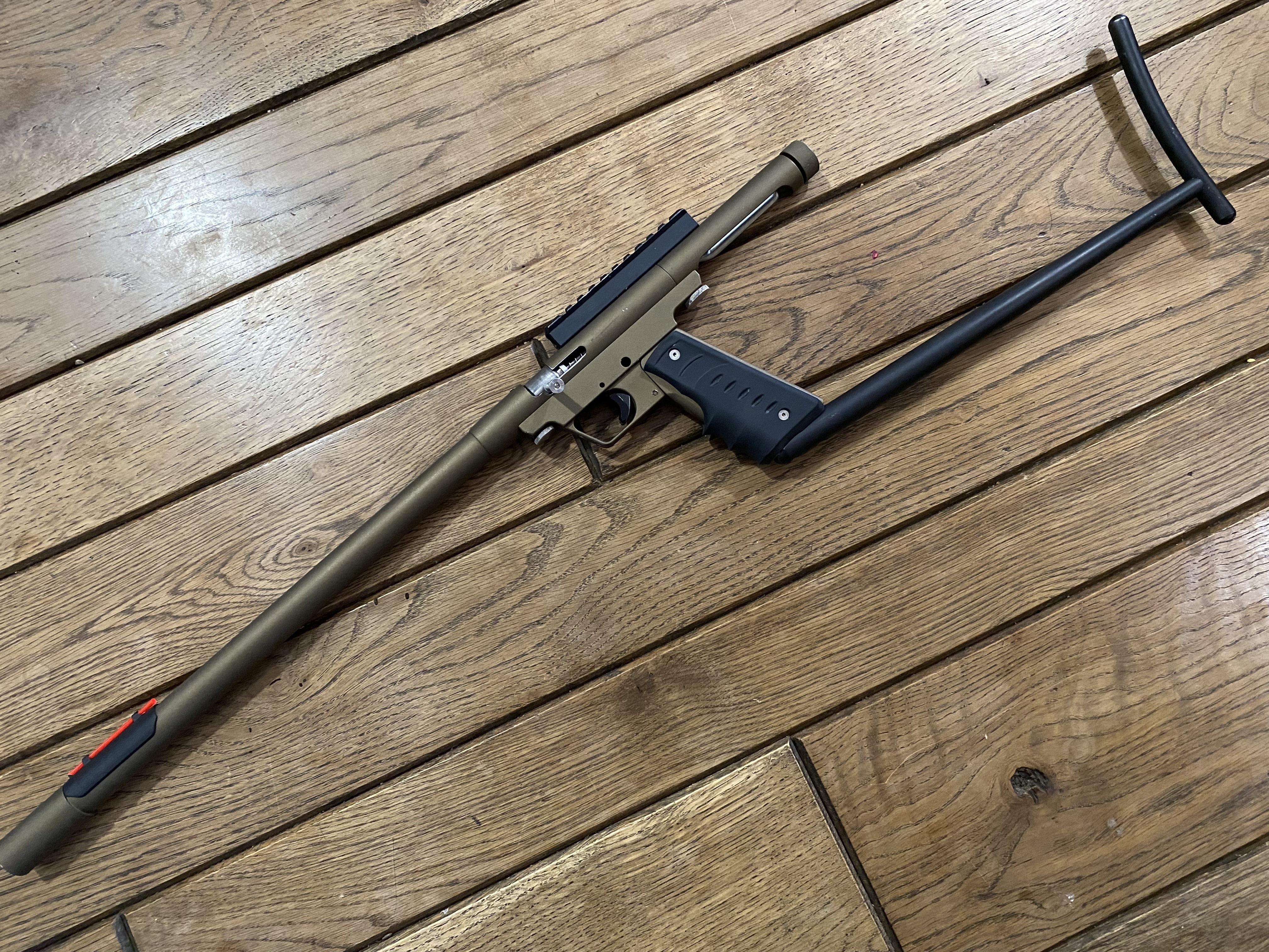

    Here is the one I made a few years back, with finger cocking (no bolt handle on this guy):

      Best bet would be to cut an ASP body because it will take cocker thread barrels. Cocker threaded rifled barrels are easy to come by.

          ok, I found a open class right side feed Phantom body. And I found a rifled Armson phantom barrel plus a dna paintball tommy gun pump. (By found I mean extra parts in basement).
          I used the Dremel to cut body to make it accept FS.
          then I swapped internal parts from one of my phantoms.
          Now I have a single shot FS phantom. It works great.

            Double check the rifling on the Armson barrel, I believe they twist the opposite way from first strikes. But I dig it with the Tommy gun pump!

          I did a terrible job with Dremel but it works.
