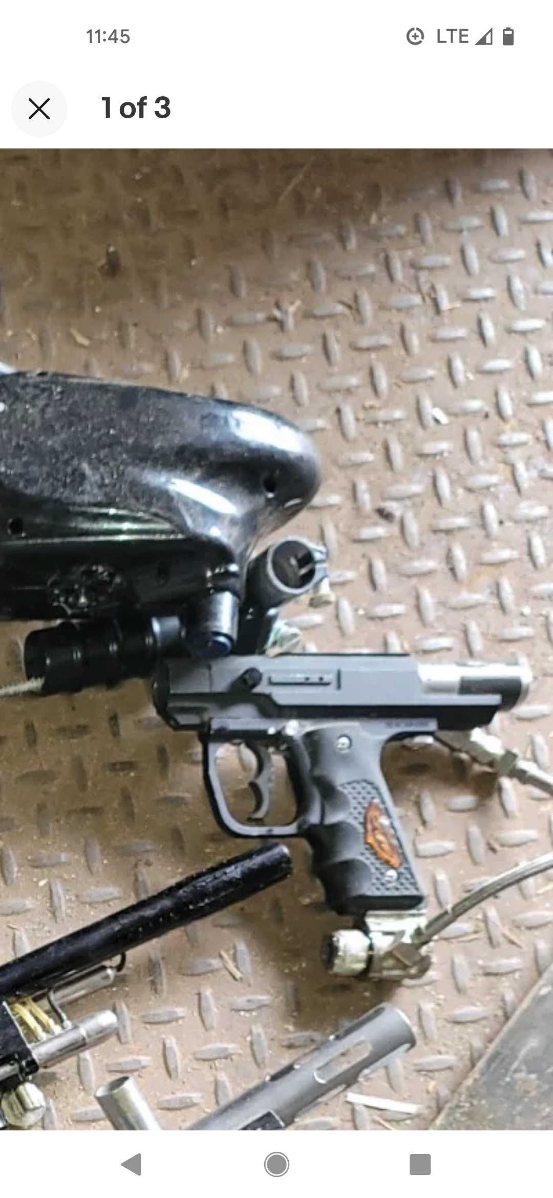

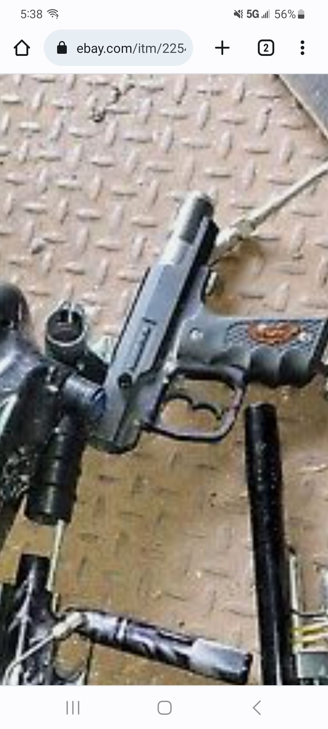

What type of Mag is this?
  • Junglepeanut
    I would rather be fishing
    • 1507
    Sorry for the crappy pic, it's all I have. Wanted to see if anyone can ID this mag body for me
    • 4456
    A micro mag with a retro valve or a aluminum back half
    • Junglepeanut
      Junglepeanut commented
      What year/type? I dont recognize it from the Micros i have seen but then again i am not a Mag guy.....Is it a knockoff version?
    • 4288
    It looks like a customized micro mag body. Other than that I can't offer any more information. I've never seen another like it.
    • pghp8ntballer
      Just a Member
      • 508
      • Pittsburgh
      That looks like it might be one of the oddball knock off micro mag bodies? I can’t remember any details about them though besides actually existing.
      My feedback
        • 4456
        It looks like someone ditched the finger ball detent and drilled it for a ball type
        • Riot
          Malört Acquired
          • 2469
          cougar20th
          • cougar20th
            • 1123
            • Amherst NH

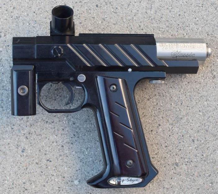

            I'm leaning towards it starting lif as a Micromag as it jas the milling for the ptp style detent. Every clone I am aware of used a different type of detent. My guess would be the ptp detent broke and they machined it for what looks like a cocker detent. It is also missing some of its milling. It wouldn't be the first time I have seen micromags that people milled them smooth.
            • Junglepeanut
              Hopefully I will have my hands on it sometime next week and I can post better pics. Its the smooth sides that threw me off, i have never seen one like that before. Thank you for the info
          • maggot
            • 498
            This is a real gen2 micro that's been butchered (milled flat sides and cocker detent added instead of PTP detent).
            I'd be leery, high likelihood of stripped threads and sub-par finish (paint/powder).
            • Junglepeanut
              It's included with some other stuff I bought so it's coming.... It just threw me off trying to ID it
            • 4456
            The whole lot looks crunchy.... But yeah definitely a messed with micro mag
            • Junglepeanut
              Wow, much better pic then I pulled woth my phone, thank you.... And yea it looks crunchy but I had to swing the bat..... Hoping it's a needs a good cleaning type grunge and not a left out in the rain type grunge
          • Walker
            • 1624
            • WA State
            The shaved ones are out there.....

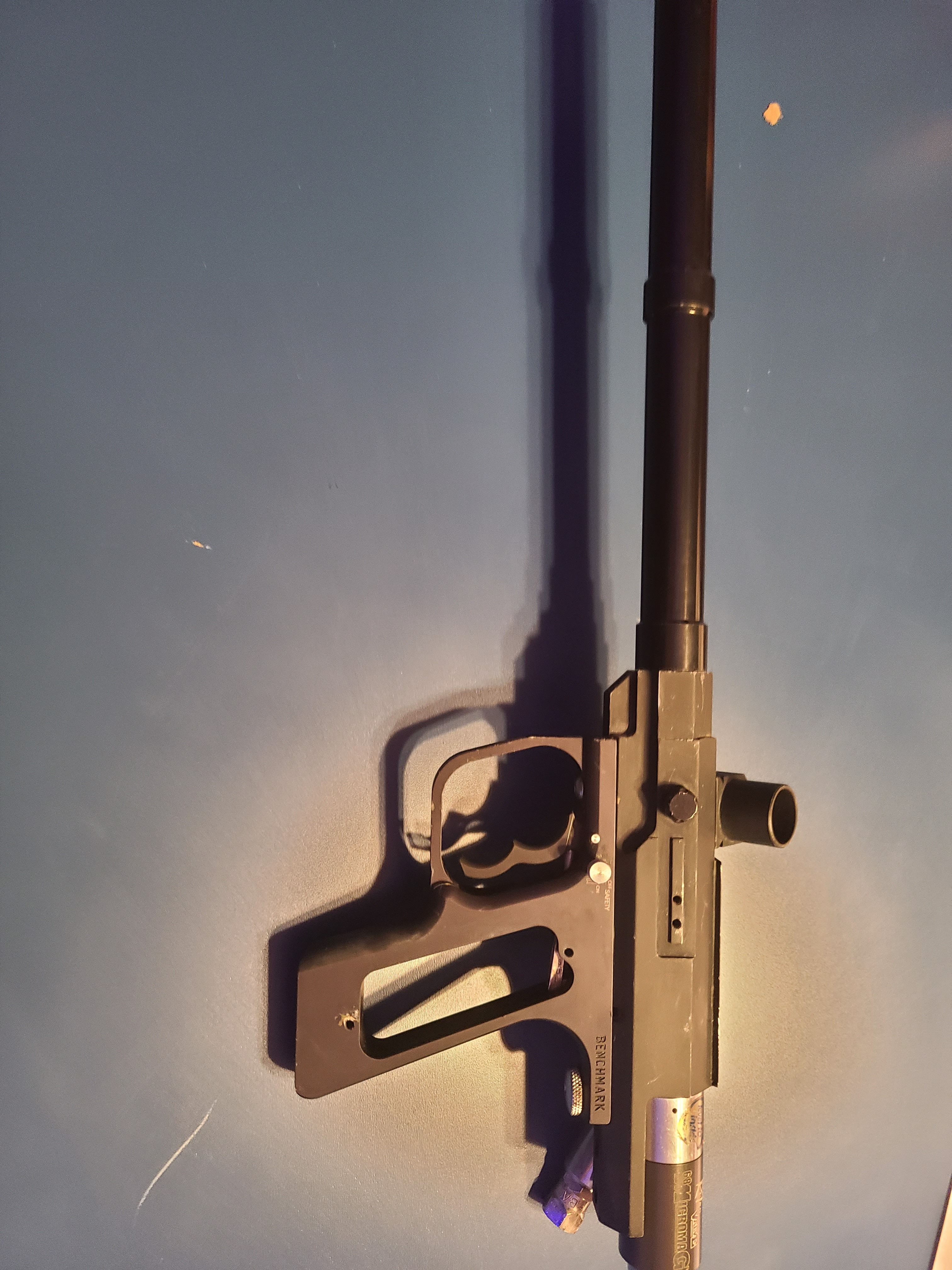

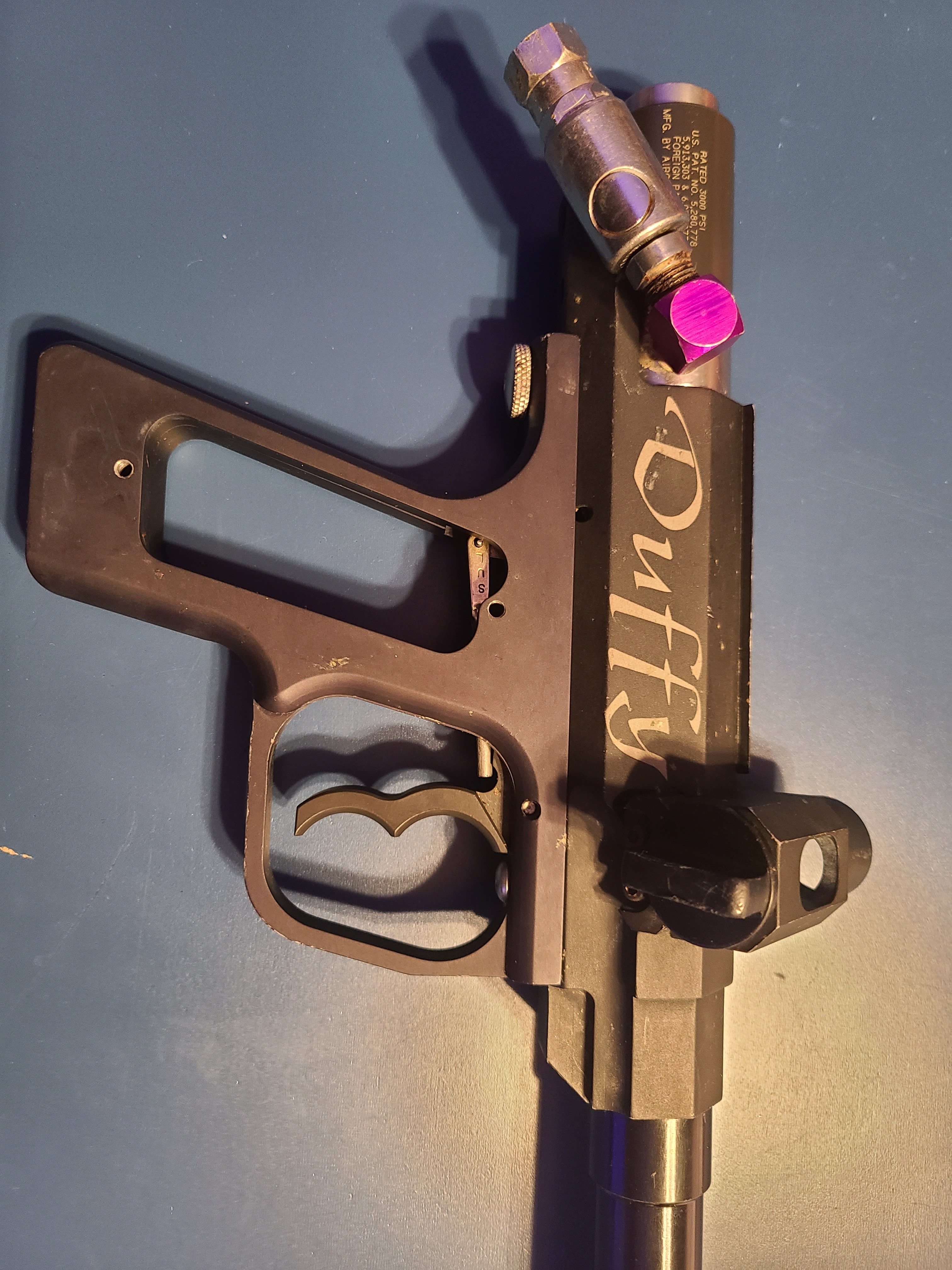

                Got the mag..... It is worn but actually very well built. No stripped threads and the dust anno looks as good as factory. Does have a name in the side.... anyone know "Duffy"?
                And any idea on value as is? I am sure it will need to be completely pulled apart and serviced. I assume the valve is the most valuable part? Being labeled as a Micromag RT valve hurt or add anything to it?
                • maggot
                  • 498
                  Cool! That worked out well. Worth a few hundred bucks. Valve adds to it slightly.
                  There's a user named Duffy on PBnation... otherwise I have no idea who that would be.
                    MCB member
                    • 3511
                    • Montreal, Qc, Canada

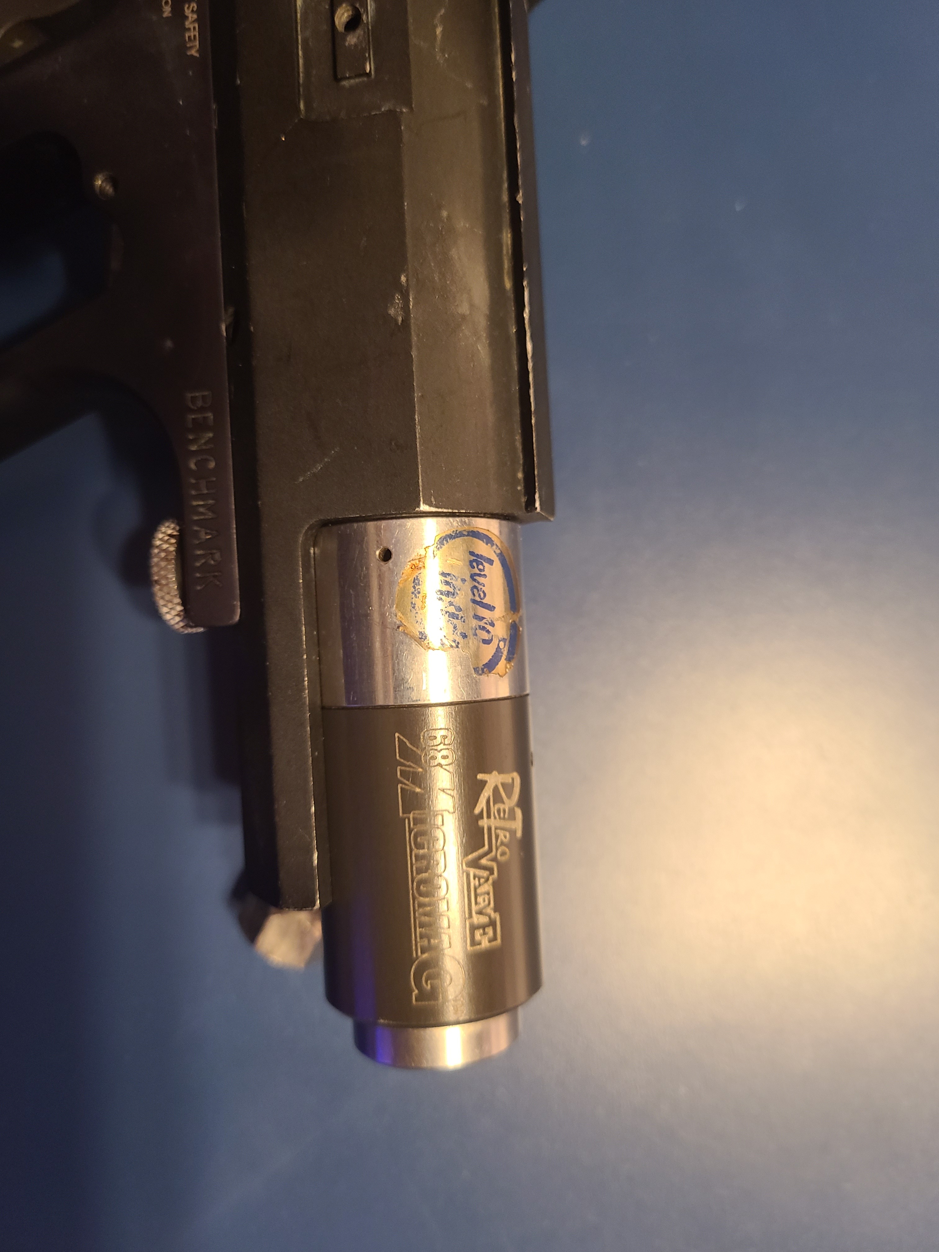

                    To give you an idea for the valve price by itself, here is the price if you want to buy one from Superman
                    Xvalves $280 each
                    Emag/rt valve with Level 10 $260
                    Emag/rt valve with Level 7 $220
                    There is a level 10 sticker on yours so if you confirm its a level 10 bolt it would be worth around $220-$260 for the valve alone. But please keep it with the micromag body it make a complete kit.
                    The push quick disconnect is fun to use too if it hold air. You can remove it if you want too.
                    Just put some grip and ASA on it and try it first you will probably like it.
