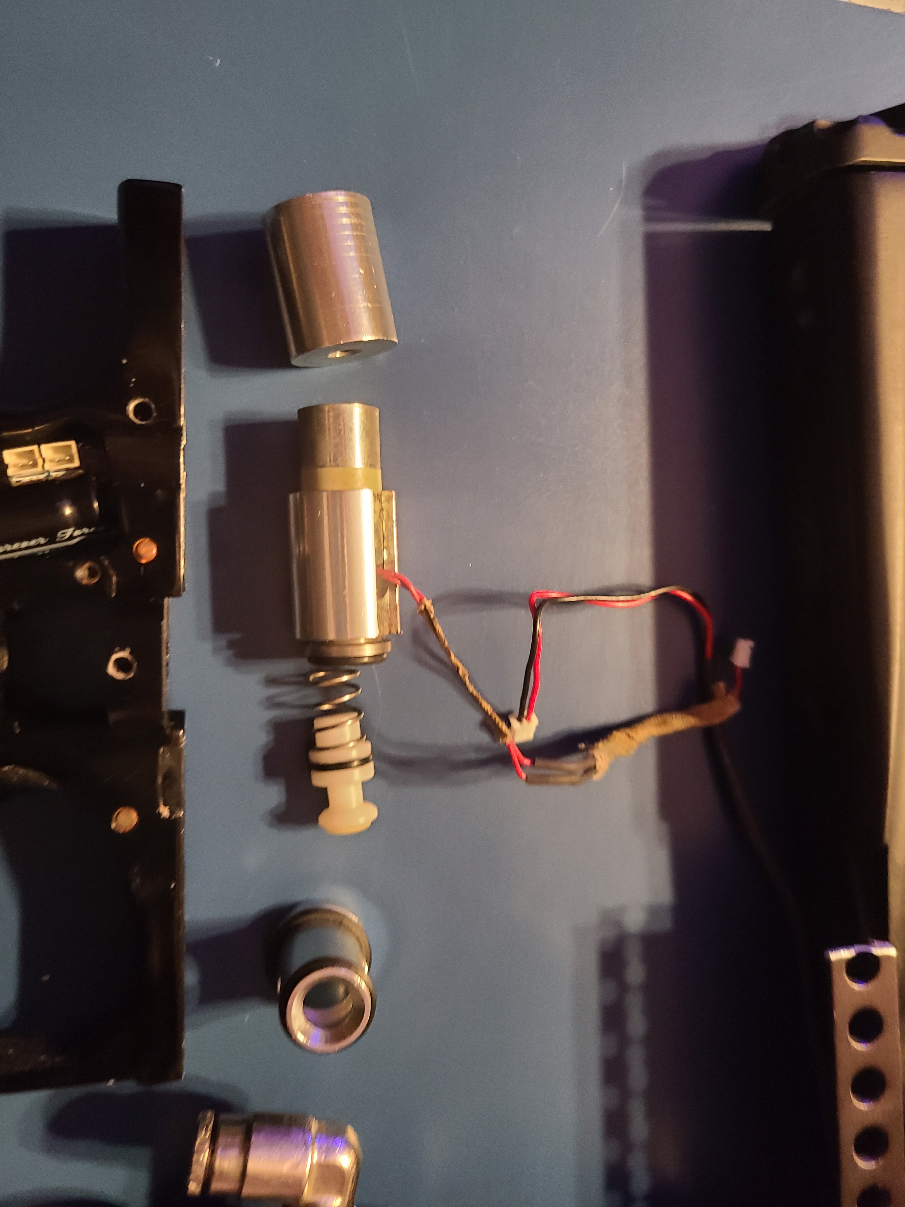

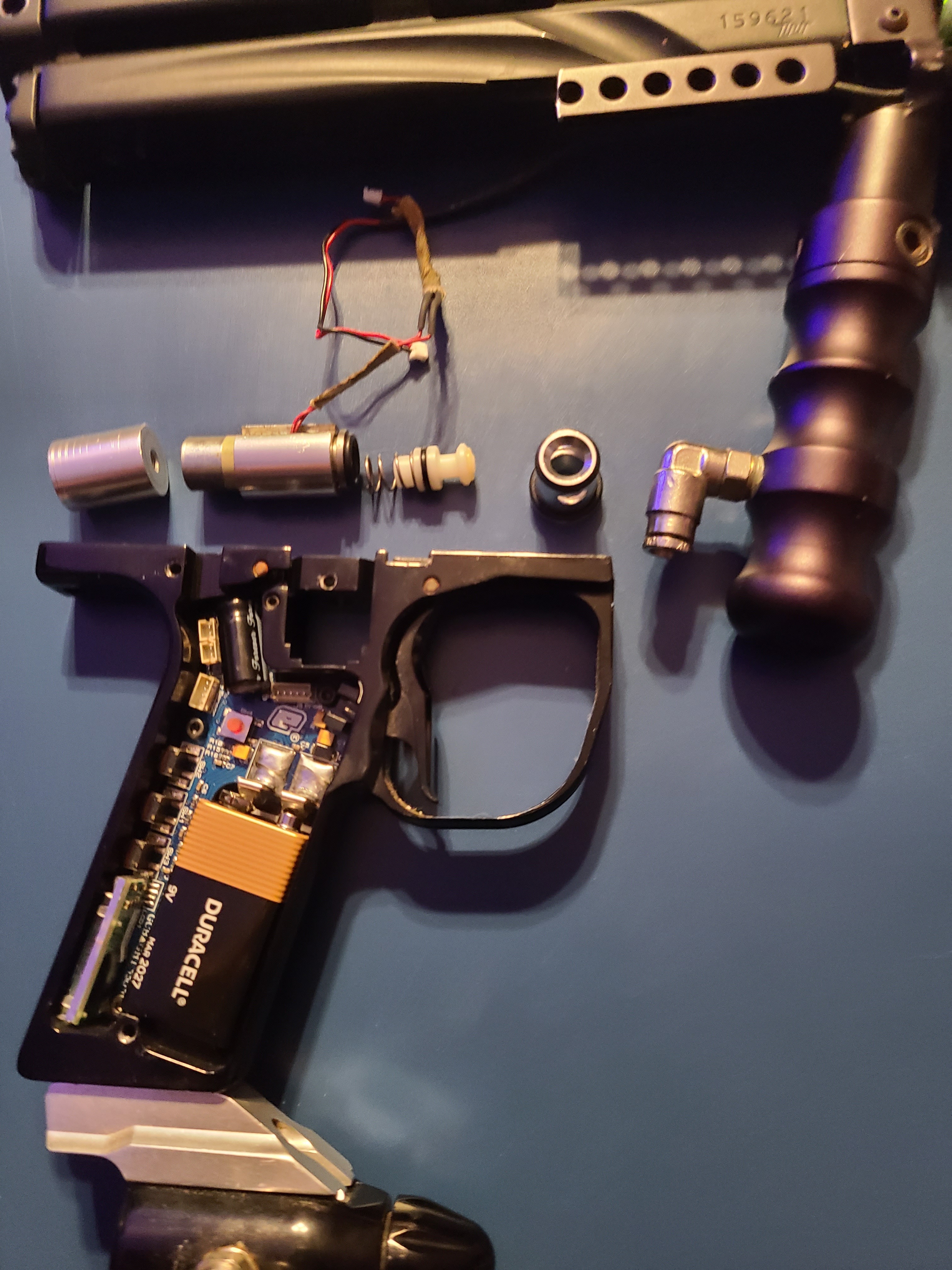

    I bought a marker lot because I wanted a cocker in the bunch. Got it today and found a bit of a surprise. When I pulled it apart I found it had an MQ valve in it..... Never dealt with one before and honestly never really planned on it. Trying to decide what to do with it but my first question is how do I test it to make sure it works? I assume this is an MQ1? These worth the trouble?
  • latches109
    Always Sciencing
    • 2075
    looks all there. plug it into the frame to check the solenoid clicks. appears to have the has the common frayed wires. install it and see if it leaks.

      Be very careful of the wires. It's eas very common for people to damage them during install.
      I know people that love the valves and people who hate them. I'm personally dislike them as i had nothingbut issues when i had one.
      If you decide to abandon it they are worth a decent amount still.

          Yeah one of the biggest things with the wires is when you get the mq in the frame, before tightening the rvg in, put an wrench or screw driver up through the sear slot to prevent the mq from rotating with the rvg. If you don't, it rotates and clips the wires right off.

            Thank you all for the info..... Really threw me off when I pulled the frame and saw wires sticking out of the hammer slot. Hopefully I can get some life out of the MQ without installing it. I am leaning towards ditching it and building something else but want to at least verify it isn't dead..... Removing it I can definitely see how the wires would get crushed if it spun at all

                So I plugged the noid into the board and it acted like it was dead (no noiise/movement/sound). I removed the noid from its housing and it worked well. Put it back in its housing causing it to be completely compressed and it went back to nothing. My question is does it need air pressure to function normally or is the noid starting to give out or maybe weak wire connection?
                  • 6185
                  Needs air, the pilot valve is tiny so I wouldn't be surprised if you can't hear it

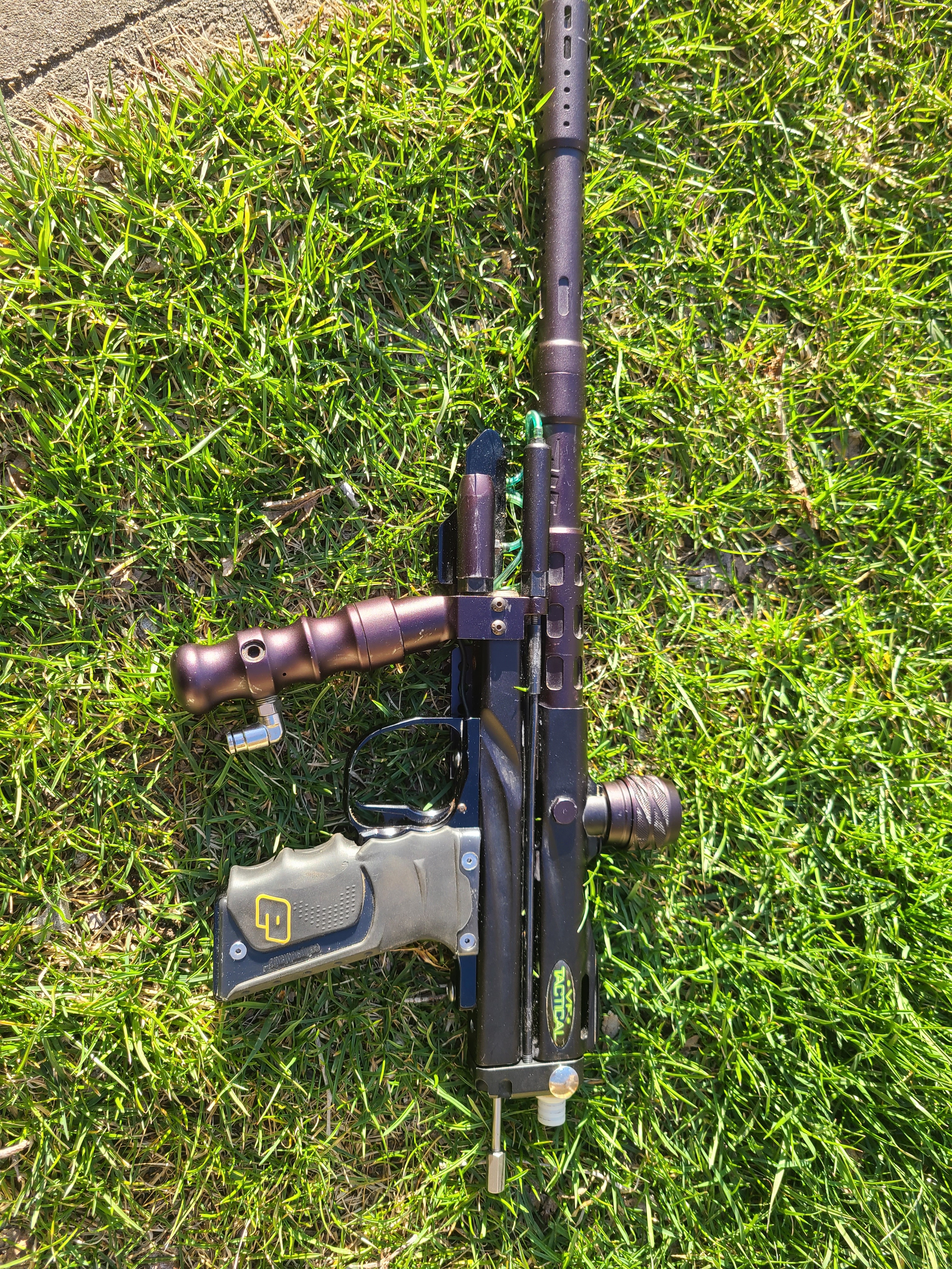

                    SHE LIVES!!!!! She is far from being dialed in (mainly because I don't really have air) but I cleaned the MQ up, reinstalled, hooked it to my Air compressor which only has a max output around 130psi i believe and she cycled great with zero leaks. Very smooth and fast. Here js a pic of her.... No clue what to do with it now but there is hope for it
                      • 6185
                      Keep in mind, the mq , at least mq2 and I would assume 1 as well, maxes out at around 200 psi
