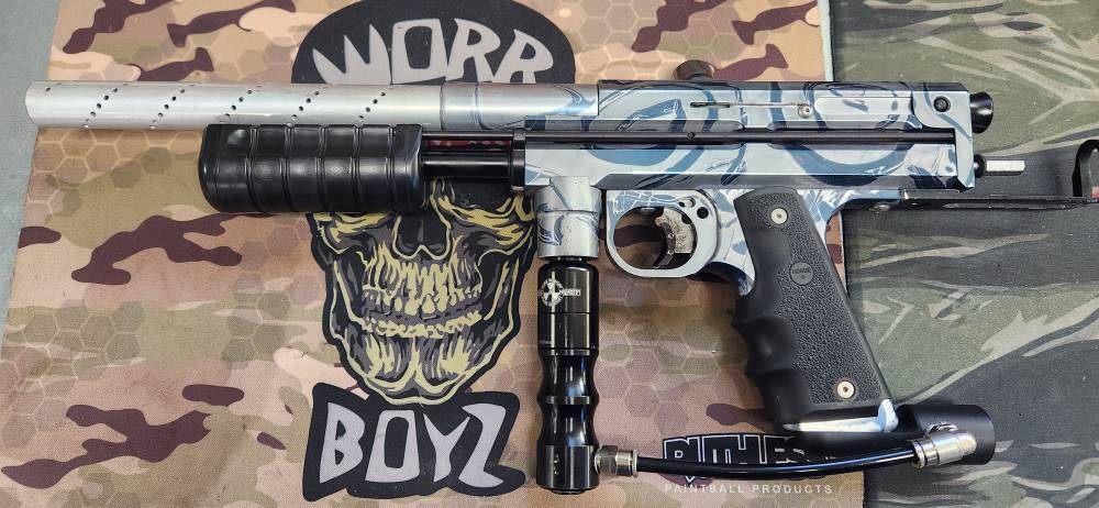

    Picked up this fun anodized pre-99 Evolution Autococker body & frame from woouulf at SPEW on saturday.
    Threw it together with other spare guns I had on site and got it running to play a game with later that day.
    Here is my question for you all:
    Did the Evolutions come with a specific regulator? Or just a gas through grip?
    Also has anyone seen this anodized pattern before? It's the first time I've ever seen it that i can recall.

    I think in the US they came with a bottomline Max-flo setup.

      Never seen that ano before. Probably aftermarket.

        Going by the serial number, it probably started life as a 95 Evolution. Pneumatics and valve would have been WGP, tuned by Belsales. It wouldn't have come with an HPR, so someone would have added whatever was available if it was needed.
        That one is missing its back block, someone modified a stock WGP block to fit, prior to annodizing.
        I don't believe the Angry frame was an option until 98 or 99.... (correction: make that 97/98)
        The anno is not factory... I have not seen that type of anno before..... It has a kinda washed out look to it... Grows on you...

          Evo came with either nothing or a gas thru grip later on mostly on the evo X
          Someone made evo X looking REgS recently that either are CP regs or take CP guts. So they look just like those evo X gas thru and are perfect.
          but early evo would have had a Wgp reg, most likely (because it woulda come with nothing)
          Walker has it right.

            Man that would be cool to find one of those for this one. Otherwise, I'll be looking for a max-flo I reckon.

              Have one of those RJ regs with Cp internals for sale

                From ZDSPB:
                Max-Flo manifold (old-style): (1998-2000)
                This was the original version regulator system. These are less common nowadays, but can still be seen. These perform relatively the same as the later versions of the manifold regulator. They were available in 4500 versions in 2000, and screw-in versions from 1998-2000.
                The 95 Evo would not have a Max-Flo, or an Evo-X foregrip.....
