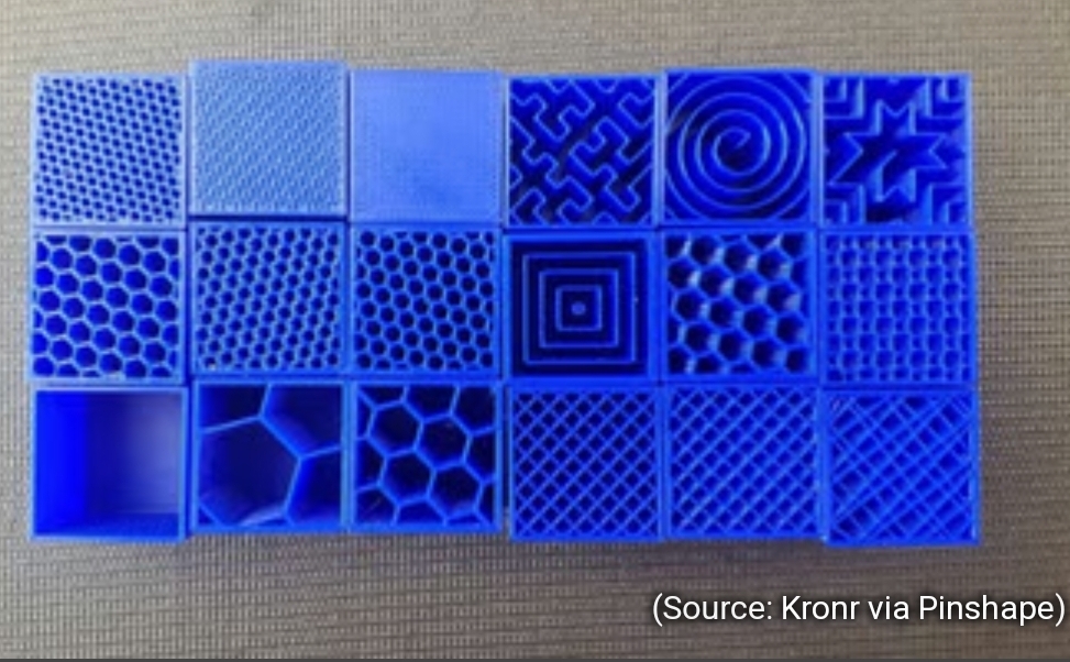

        3d printed parts can absolutely be cut, sanded, and drilled. The biggest issue is if they don't have 100% fill. A lot of prints will use a % infill to save on material and weight (see picture below), so cutting may not always give you a solid face and drilling might offer less support than expected.
        A lot of folks sand their prints to smooth out the layers, especially for painting. Click image for larger version

          Ok, well the arms cracked and broke off so I'll have to use it for a shroud or attach arms to it at some point, it's fill looks like image 2 or 3 from that photo
