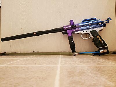

                    The cage and cocking rod combination are going on my Evil Spyder (purple/blue fade with silver splash Flash body)... I am modifying an Evil bolt to work with the AKA cocking rod, as the Evil cocking rod thingy is too large diameter to fit in the cage.

                          This is the Evil Spyder, so far. I put a big, shiny TASO LPC on it, an AKA feedneck, and I took off the sight rail (for the AKA cage)...

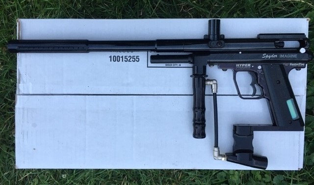

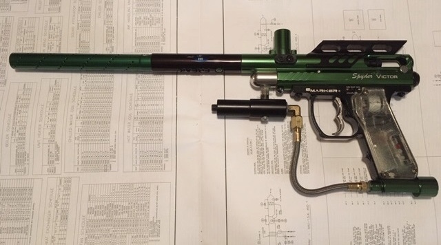

                            Adding an AKA Lightning bolt to a windowed body Spyder isn't too complicated. It's not a drop it in a run with it upgrade. Grab the pin from the old bolt and get (or make) a rod/knob.
                            Here's my Victor with a Lightning bolt:
                            Here's my black Imagine, also with a Lightning bolt:
                            • Tarsun2
                              • 1031
                              that imagine looks nice. (insert drooling face here)
