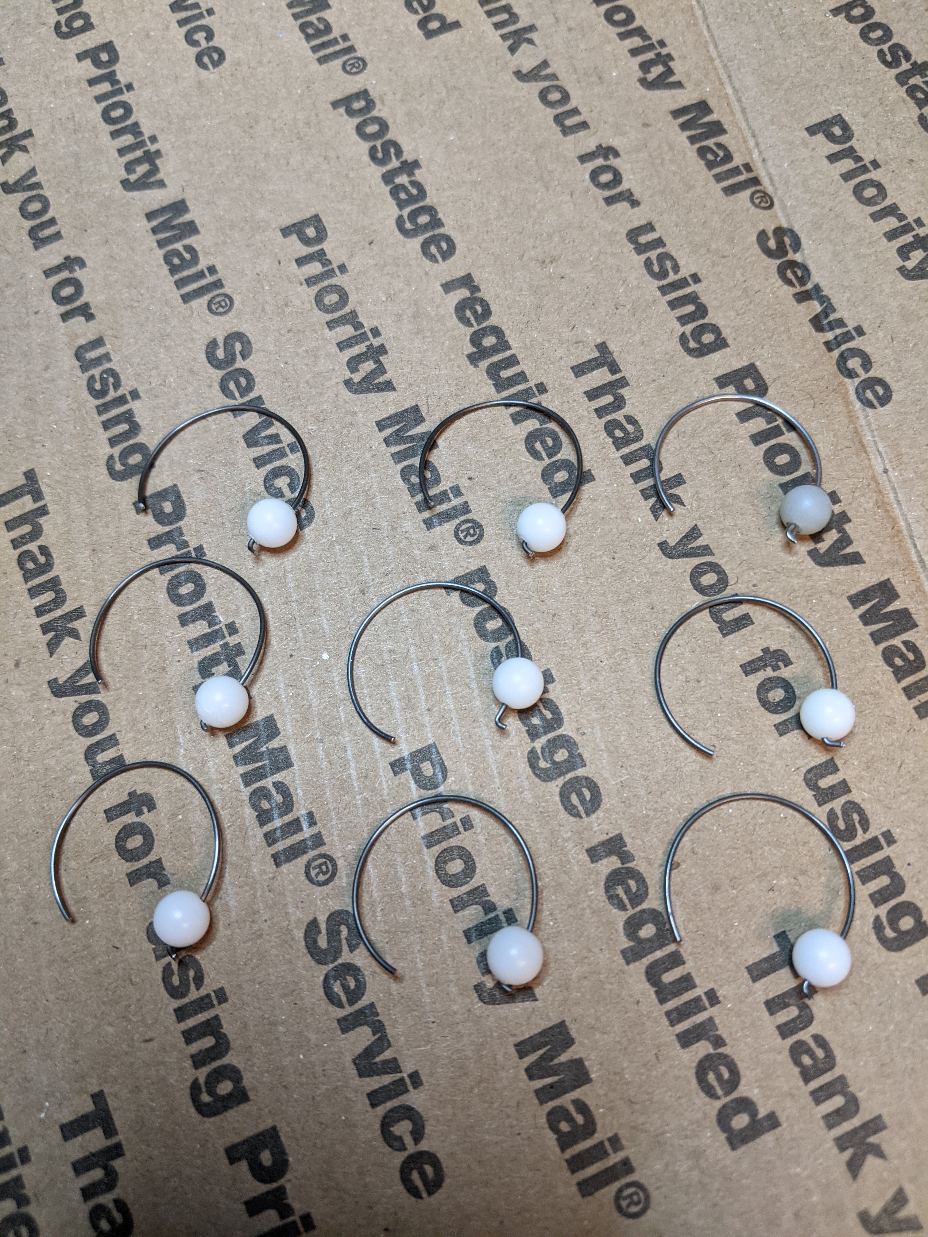

    So I may have installed them wrong, may be shooting paint that is too small, or broke my detents but the ball detents on the top that hook around the marker are allowing multiple balls per shot some times. This is likely on me as I used 2 rotors to feed my Nasty Typhoon but I thought i would check if anyone might know where i might get 2 new Nasty Typhoon ball detents. One idea that I had is to use a nubbin that would fit over the holes and the original wire detent could push against it or i could put a piece of tape over it.

    The rotor has a pretty high feed force and might just be too much for the palmer design

      anson was/is making his own. This might be something you could try doing yourself...?
      I ended up buying some delrin balls from McMaster Carr and bending the wires from some old mag springs.

        Ecapnation That is what I thought and plan on using an agitated feeder for the time being but if i can find another set encase I loose them or actually break them.
        Carp Thank you for that I think i will have to see if I have a mag spring or other spring that is the right size and try that.
