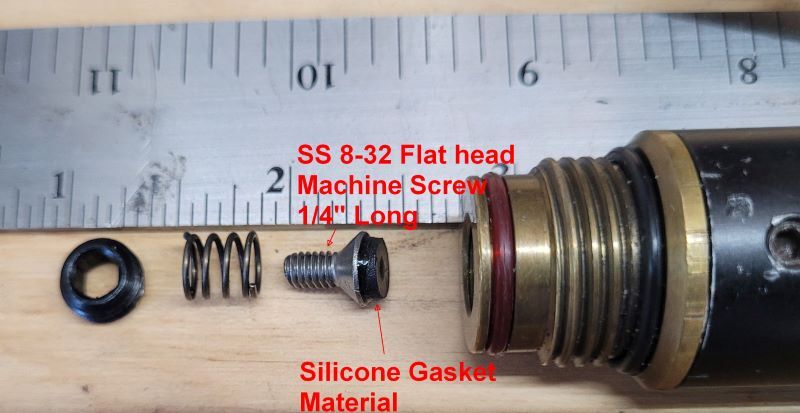

      This is what I am currently using in my main Micro CA II. A Flat head SS Machine Screw (8-32) with a dot of silicone gasket material epoxied to the head and a random spring (I literally have hundreds of misc. compression springs). Once the epoxy set I clamped the screw with gasket in place so the gasket work form a little pultrusion where the hole is in the valve to preform the gasket. I might chuck up the screw and remove the threads and turn down the head closer to the diameter of the gasket to open up air passage but it works now so I doubt I will fix something that is not broken for the time being.
      The reason I moved from a ball to this is there were times of hard use (abuse) that the check valve would not work. I theorized it was because the ball did not stay centered over the hole so I went this route because even if the screw shifts the gasket will still cover the hole.
