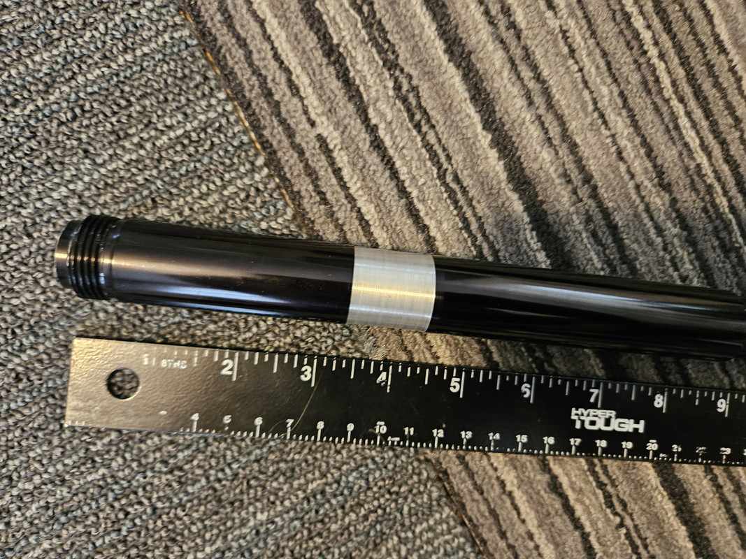

    First, it comes with a 15" Smart Parts barrel in beautiful condition, but there's a 1" segment about 3.25" from the threads that has been machined down a bit.
    Anyone know what that's for?

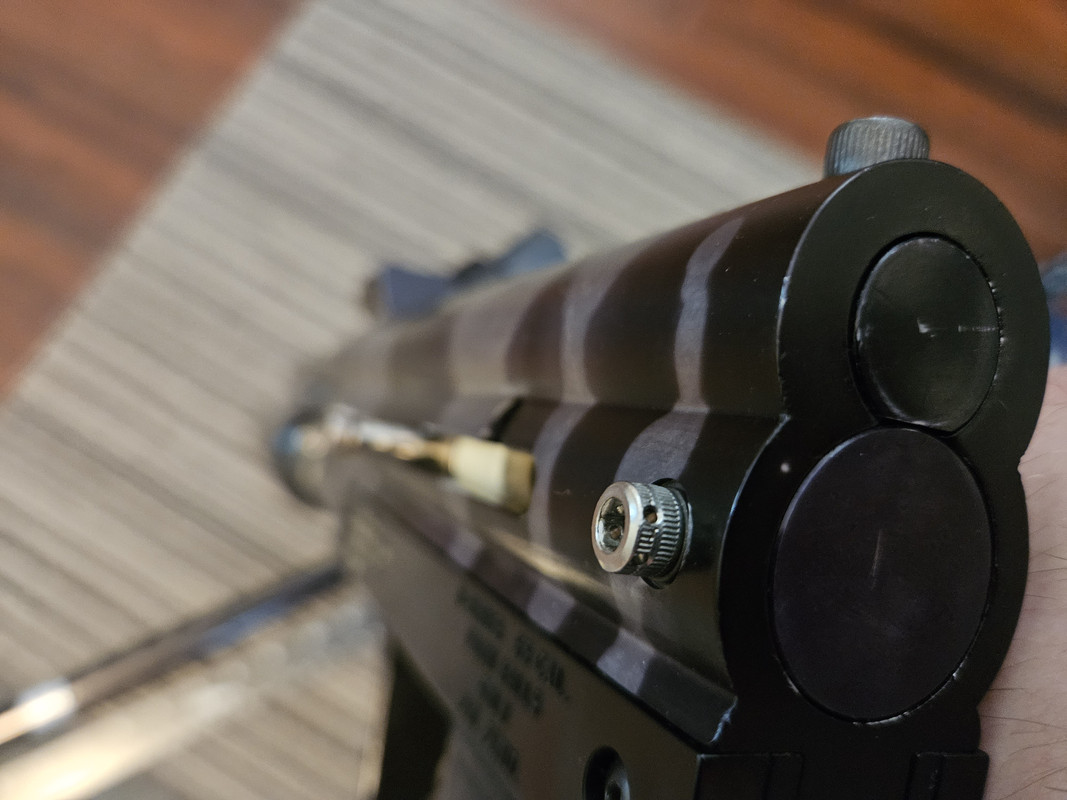

    Also, most of the bolts on the body retaining the valve and rear cap have been replaced with really nice stainless bolts which have what looks like holes for anti-vibration wires. Were these from a kit of some sort or did the prior owner source them himself?

            Install it and the bottle, it looks like it might be some clearance - ing for the burst disk on the bottle.
              Ecapnation commented
              Or an on off

              The Smart Parts barrel is a seconds barrel. The previous owner most likely got it for 25$ instead of paying full price of 100$.
              Smiley
