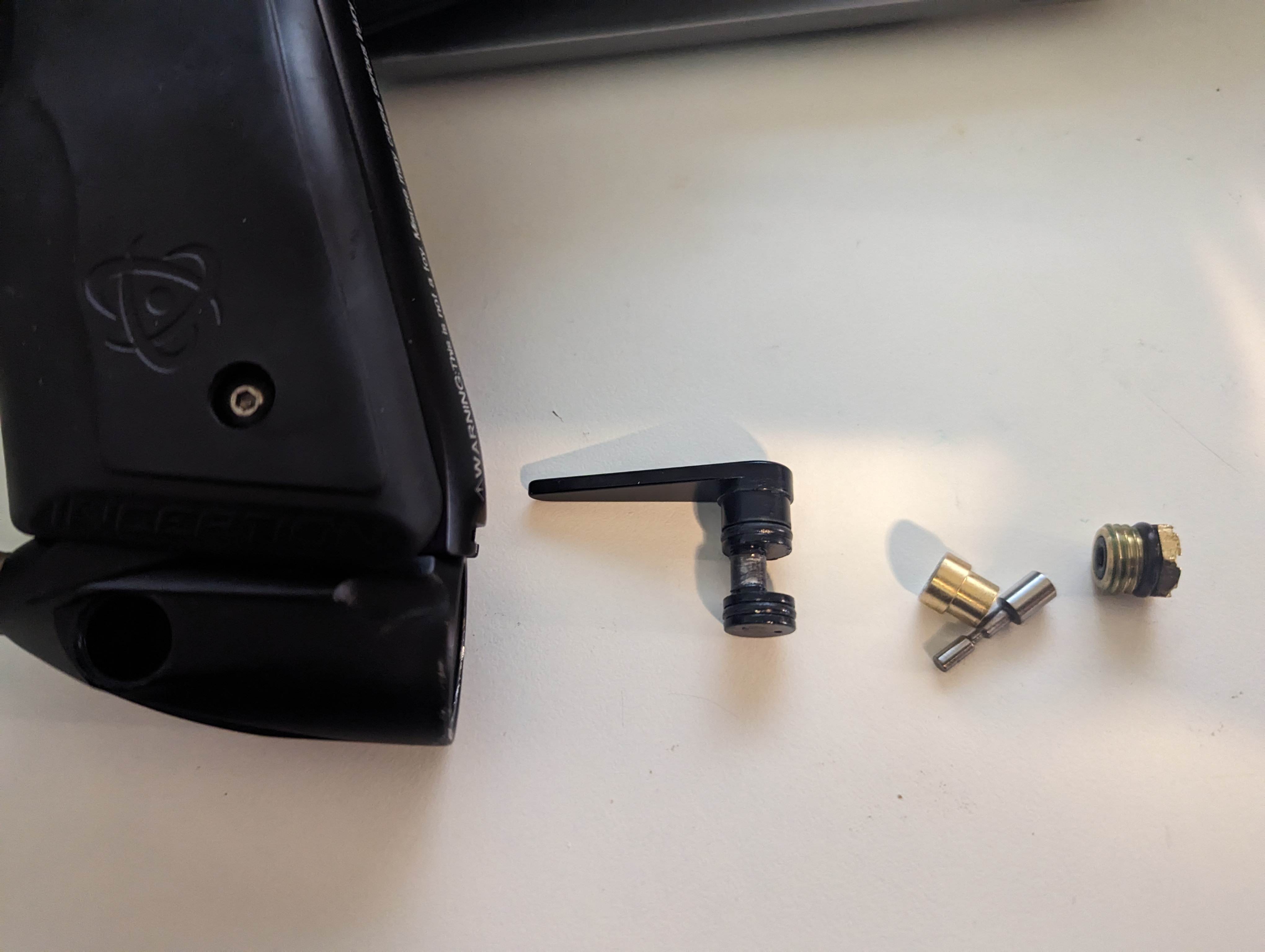

    Okay, this is such a simple part, I can't believe I can't figure this out!
    PROBLEM: When I flip the on/off lever on my ASA it just blows air (violently) from the degas hole on the ASA.
    At first I figured it was my tank, so I swapped tanks (ninja ball to ninja pin), same issue, then I tried a first strike reg, same issue.
    I then took it apart, and everything looked fine, so I lubed everything re-assembled and had the same issue.
    I then took every thing apart swapped the orings on the lever and tried again, same issue.
    I threw a tank on my Empire sniper with identical ASA and it worked fine. So I tore the guts out and everything looked identical to the Ressy.
    This is where it gets weird! I then swapped all the guts from the Ressy to the Sniper and vice versa. Sniper worked fine, but Ressy still had the issue.
    That is where I was left scratching my head. What is going wrong here??? This Ressy worked fine before being hung on the wall for the winter.

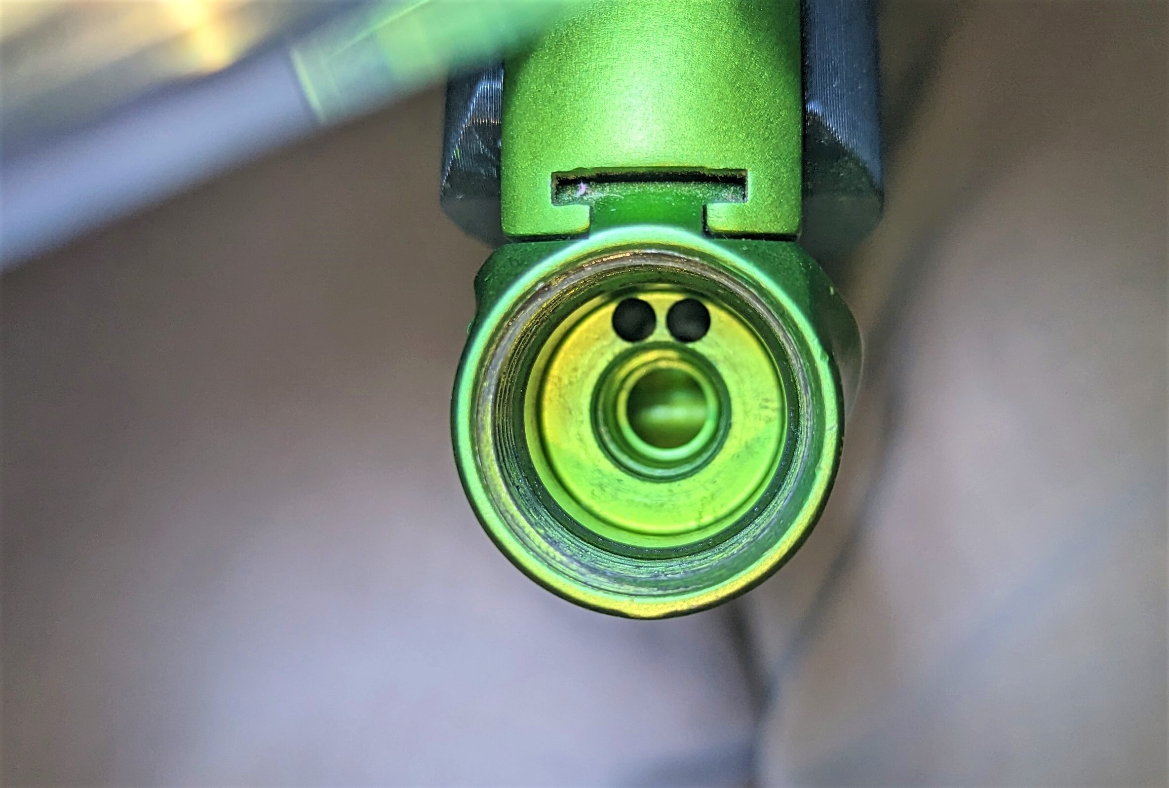

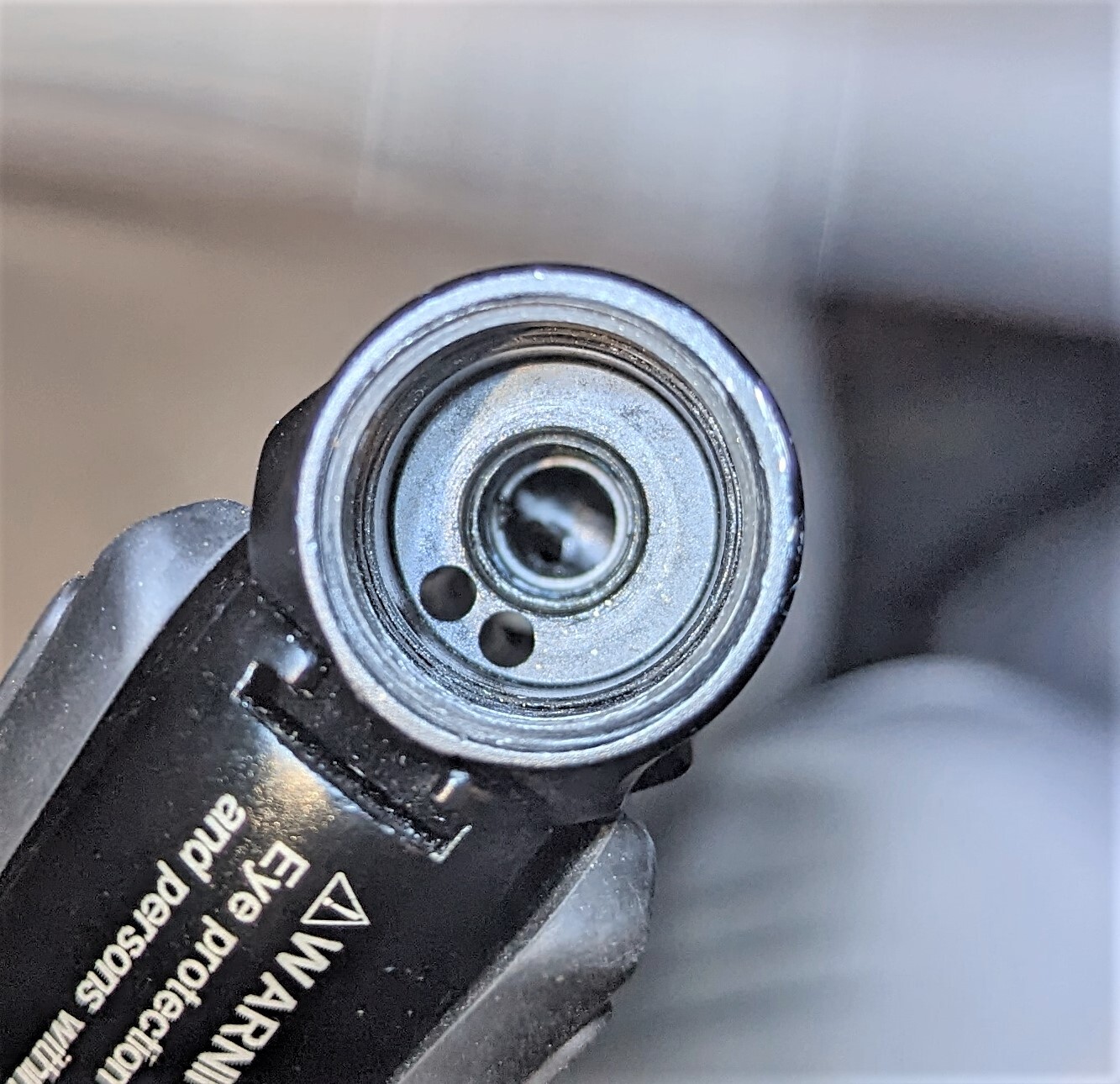

      This got even weirder. I replaced all the orings again, and no luck!, I checked for extra parts or something and it is all the same. However, then I started looking at the actual housing. The Ressy has a hole past the lever bar that the Sniper does not have it. Given how this on/off works I don't see how this hole would work without blasting air out that blow off hole. Is it possible that this hole should not be there, and some how the air blew a hole in the asa?
      It is so hard getting pics of it, but the black is the Ressy and the Green is the Sniper.
      Can someone tell me if this hole in the Ressy is supposed to be there, or if there was some super bizarre failure in the ASA and it blew a hole in the housing? Thanks!!!!
