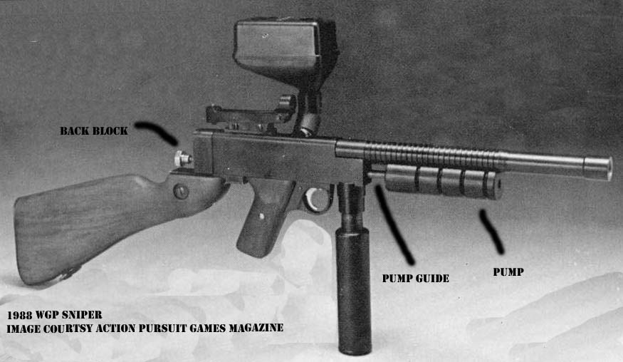

    I'm currently building a Pre2k autococker pump and I'm trying to run a 13ci 3000PSI tank straight into the vertical ASA. What parts will I need to support the pressure? I attached a google image of what I'm going for.
    Thanks, Mason

    The tank will have a reg on it, which will probably be putting out ~800 PSI, which is perfectly acceptable in most older autococker/sniper bodies. If you're trying to use the tank without a regulator, don't, just don't.

        A pure pre2k could and should handle 800 psi fine

      It depends on the valve you are using. If there was a ref on there before, then find out what the sweet spot was and use a tank that matches that output. (Likely something around 400) You will have a steeper pressure curve without double regging , but it will work. You’ll just lose a bit of fps at the end as the tank pressure drops.
      Now if it was an early sniper that never had a reg then a normal output pressure tank will work fine as the old snipers had co2 directly to the valve.
      it’s all about the valve and what pressure it likes. I’d go with a high pressure valve so any normal output pressure will do.
