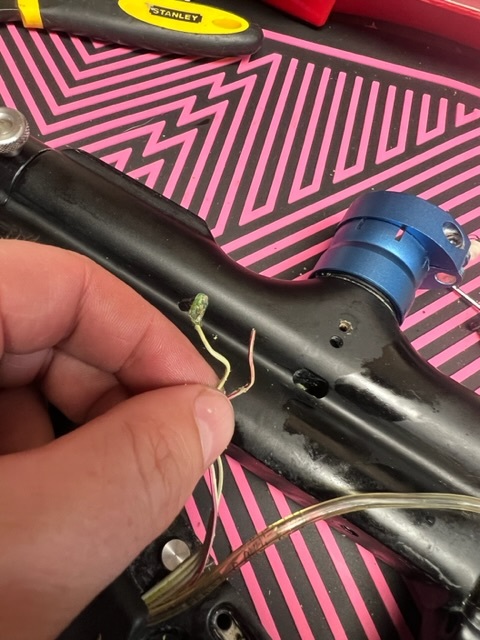

    Working on a Trilogy with electronic trigger frame. Pulled the eyes out and one of the eye wires has broken. Are these repairable?

    Pretty easy to solder on
    strip the broken wire so you have about 1mm bare wire
    Tin your soldering iron by melting a bit of solder onto it, then use the tip of the iron to hold the wire to the solder pad (try to get the tip half on the wire half on the pcb). Then touch your solder to the point the pad and wire meet.
    Using Flux will make it easier to take teh tip of the iron away without removing the wire with it
