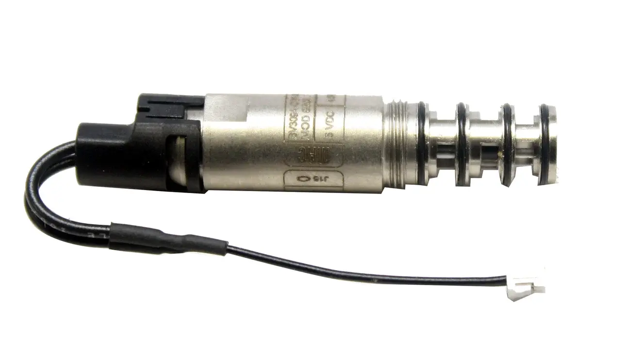

        Originally posted by Price
        looks like the same solenoid used in the bob long insight/onslought. this is the picture from field ones site
        • flyweightnate
          flyweightnate commented
          MAC bullet valve... don't recall the specs on these offhand
        • latches109
          latches109 commented
          120psi max, definitely not c02 friendly. The 309s all have custom mod numbers. The bob long one is stepped and difficult to seal on custom housings
