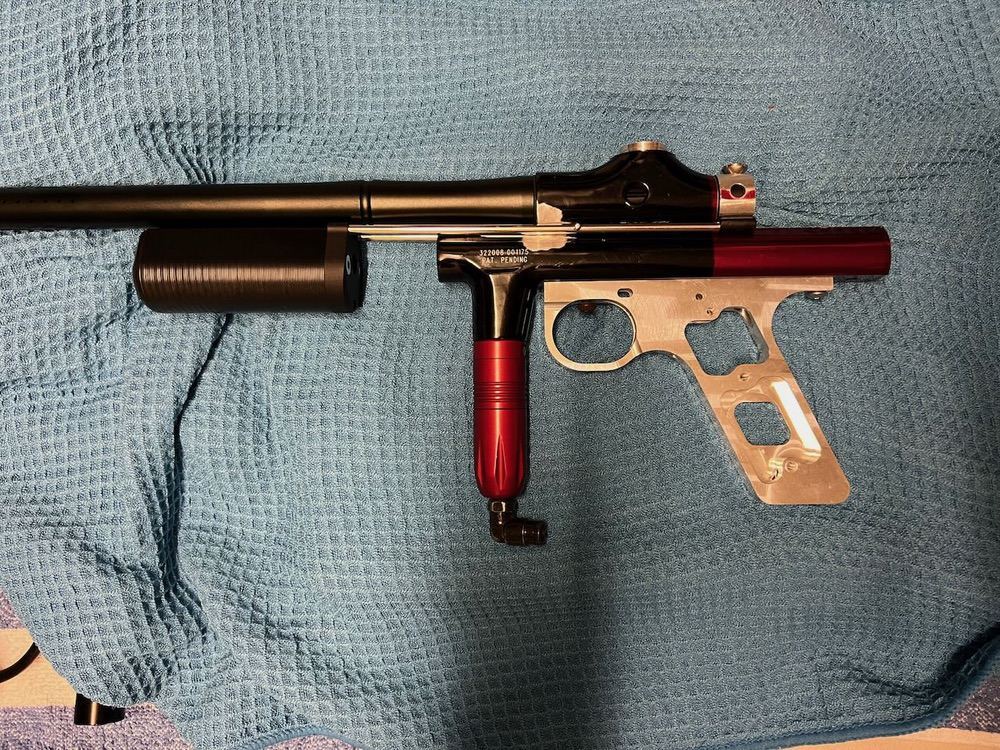

    It's fun, I've done a few - get it cut by someone who knows how to do it right. I like to make mini back blocks for a cleaner look.

    Working on a trilogy dual rod pump that will get a cafe racer ano, and a prostock that will get a nebula ano
    you will need
    half block hammer - which is a normal hammer with a slot milled on the top side.
    halfblock/midblock pump arm
    halfblock bolt & pin to cock the hammer.
    sled or back block
