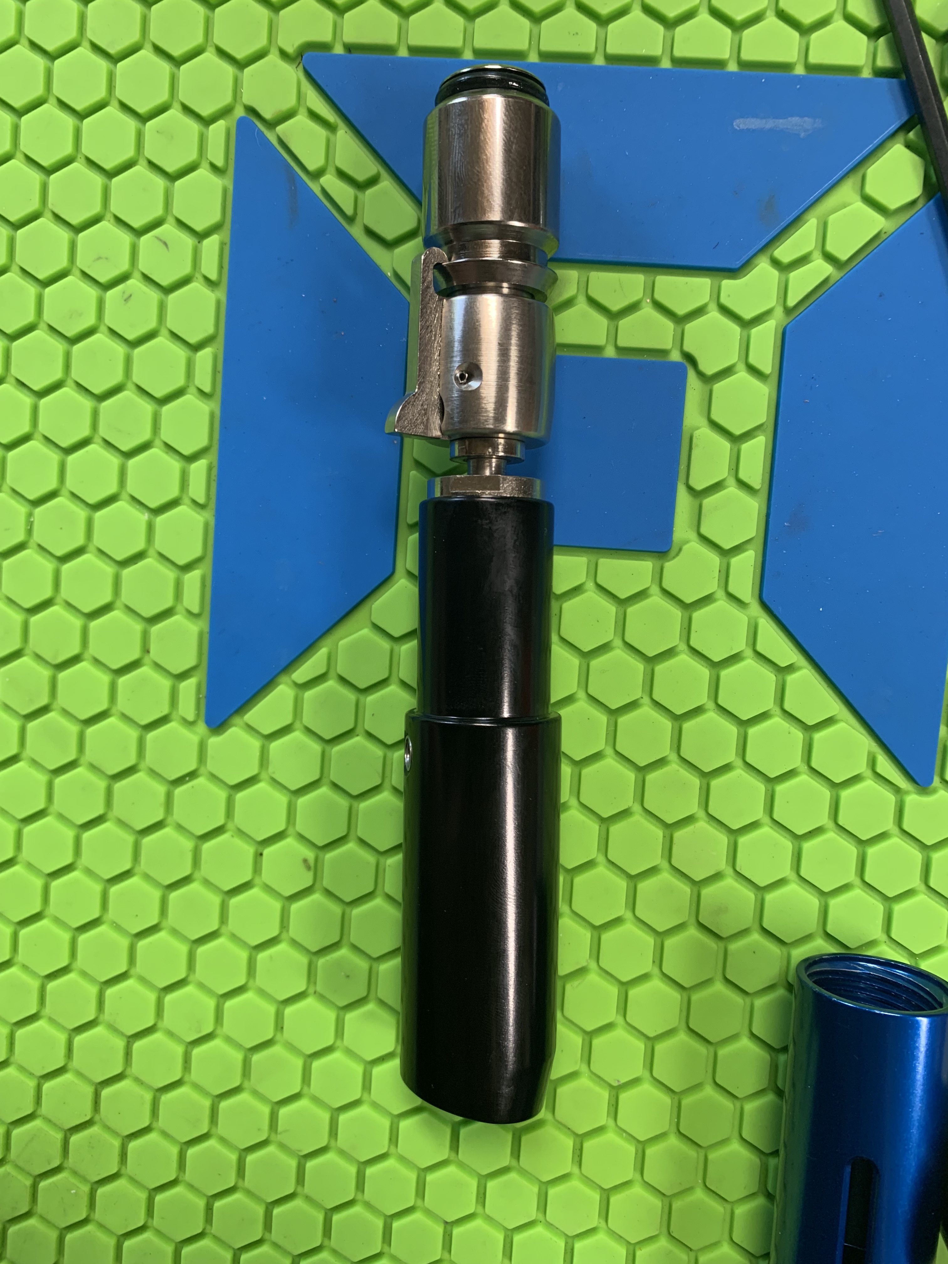

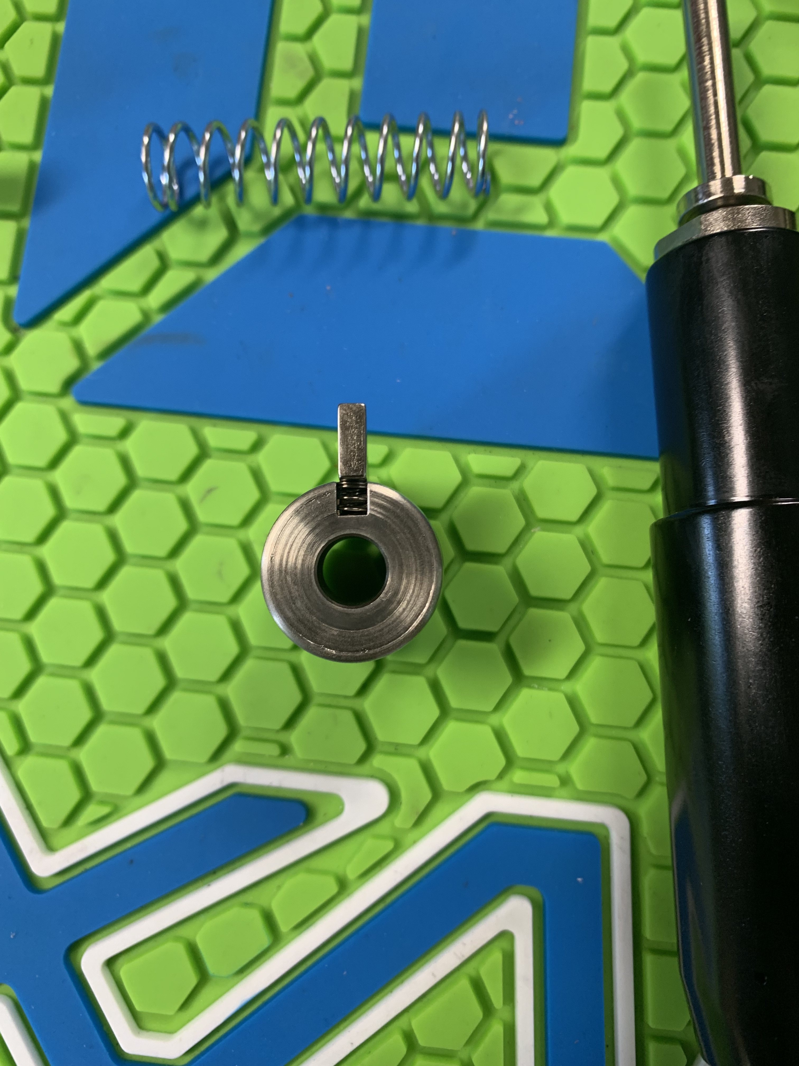

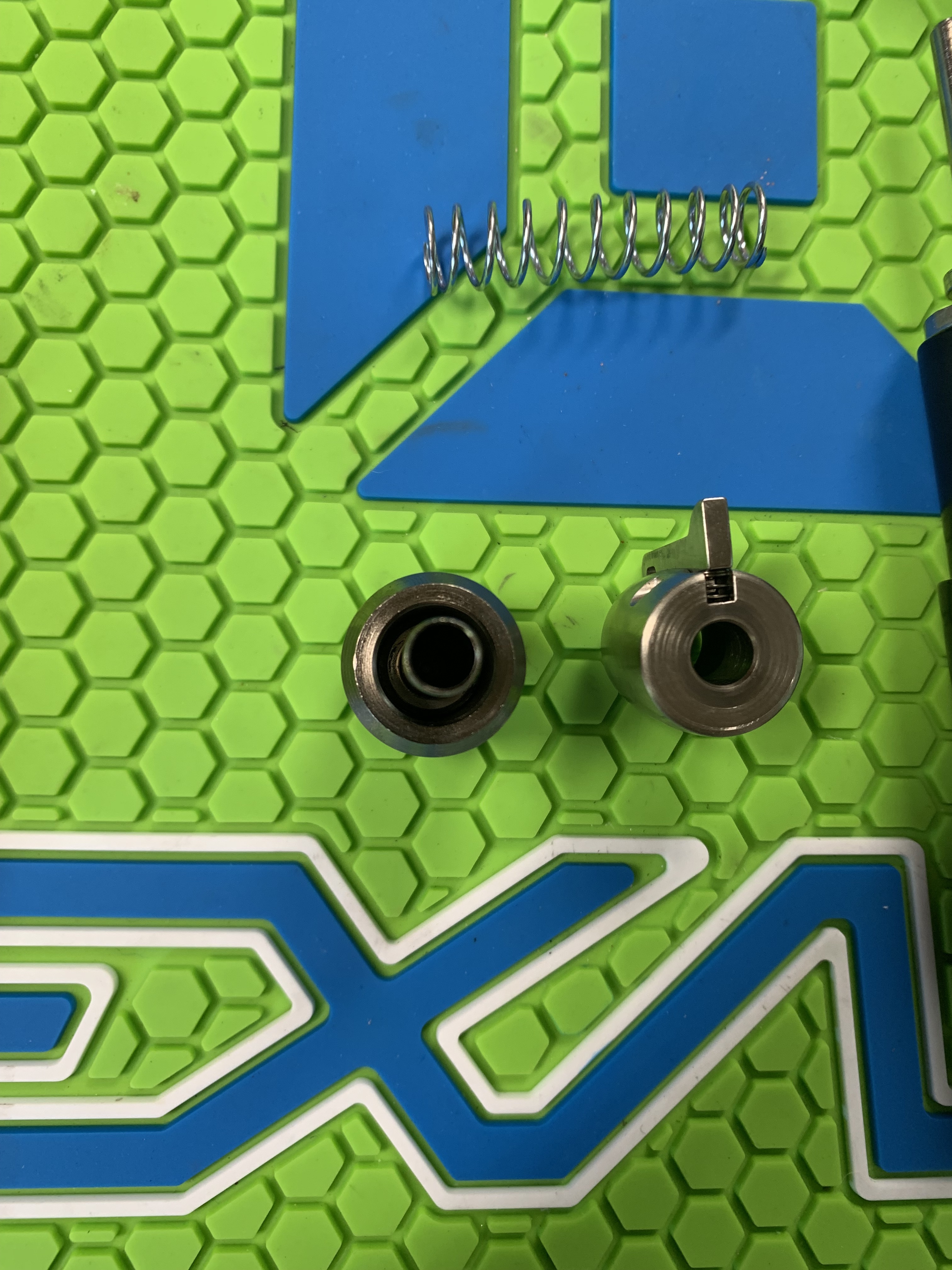

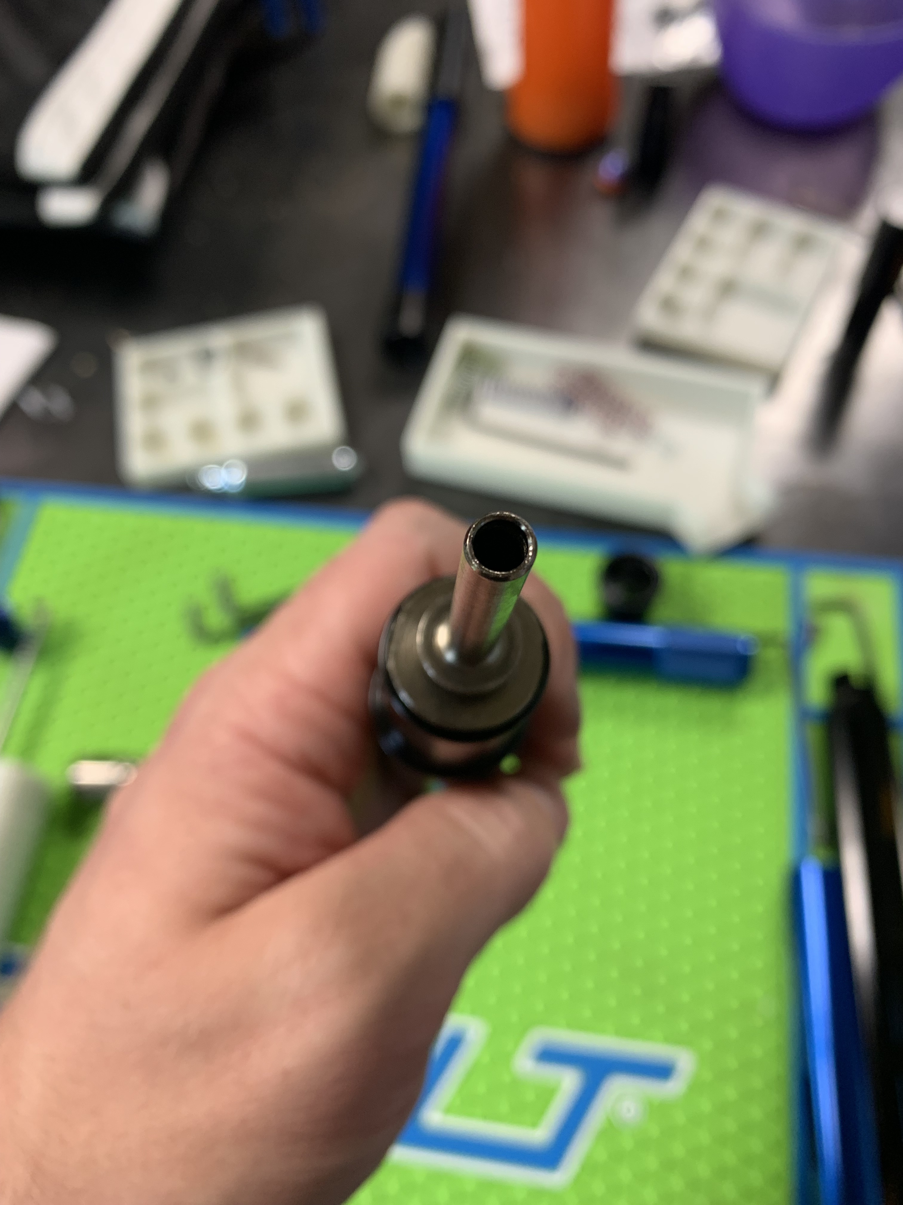

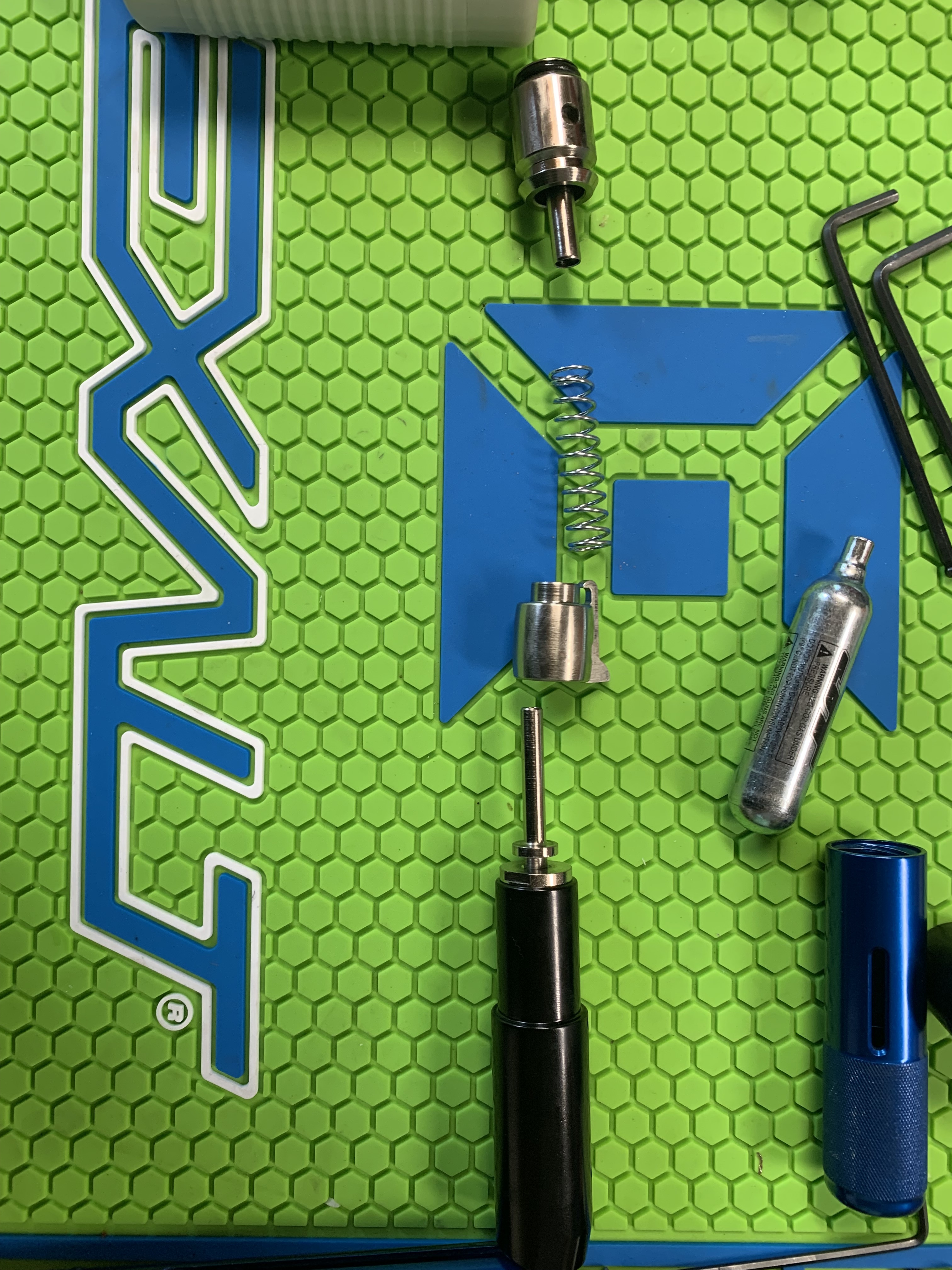

          I attached pictures of the internals. I don’t really see anything wrong but maybe you will notice something.
            • 6378
            #20
            Looks normal. The newer internals are not polished as nicely I see. Definitely a rougher finish. But I can’t see that being an issue. It’s probably irrelevant. I have know idea what could be causing that binding and the valve purge on the rearward stroke.

                  Ok so I FINALLY found the issue! I never sent it in to EV but I ordered a new puncture pin assembly and that was the issue. My old puncture pin was crushed and there was no hole for the air to get through and fill the valve. New puncture pin has the hole and have shot 69 shots through it with two different 12 grams and no issues.
                  THANK YOU TO EVERYONE WHO ASSISTED!!!!!!
