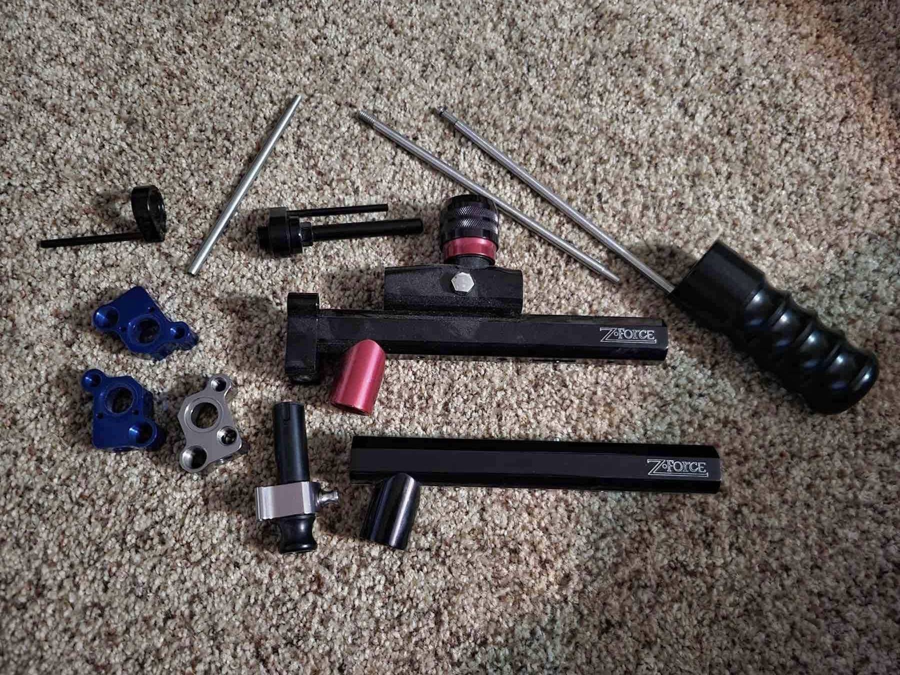

    was curious if i could get help on specs about the lower tube, what valves and hammers work. i know theyre 11/16, but so far everyone makes these things seem like a nightmare.
    jumping the gun and asking for help before its even shipped but i like my builds to finish quickly…​
    looking to finish one complete marker as a pump

      the valve is a bored out 11/16ths, and there's no perch for a valve spring, which means you can only use a madman rocket valve
      if you learn how to setup a rocket valve, then odds are, youll be able to make it work

        was pointed towards the direction of trilogy valve springs that use the banjo/pump guide as the stop

        wouldnt mind a morph or other balanced valve tho

      They use a bunch of non standard parts is all I can say.

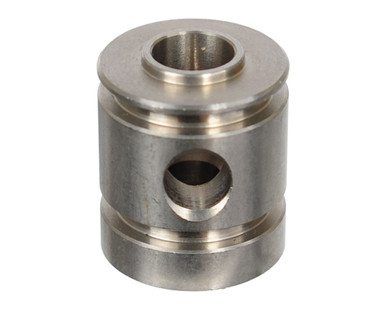

        is this an opportunity for someone to machine a run of Z-Force Happy Valves? Ahem DocsMachine MozakMachine

          https://ansgear.com/empire-resurrection-valve-72660/
          It’s been a couple years but I think I used a Resurrection Valve.
