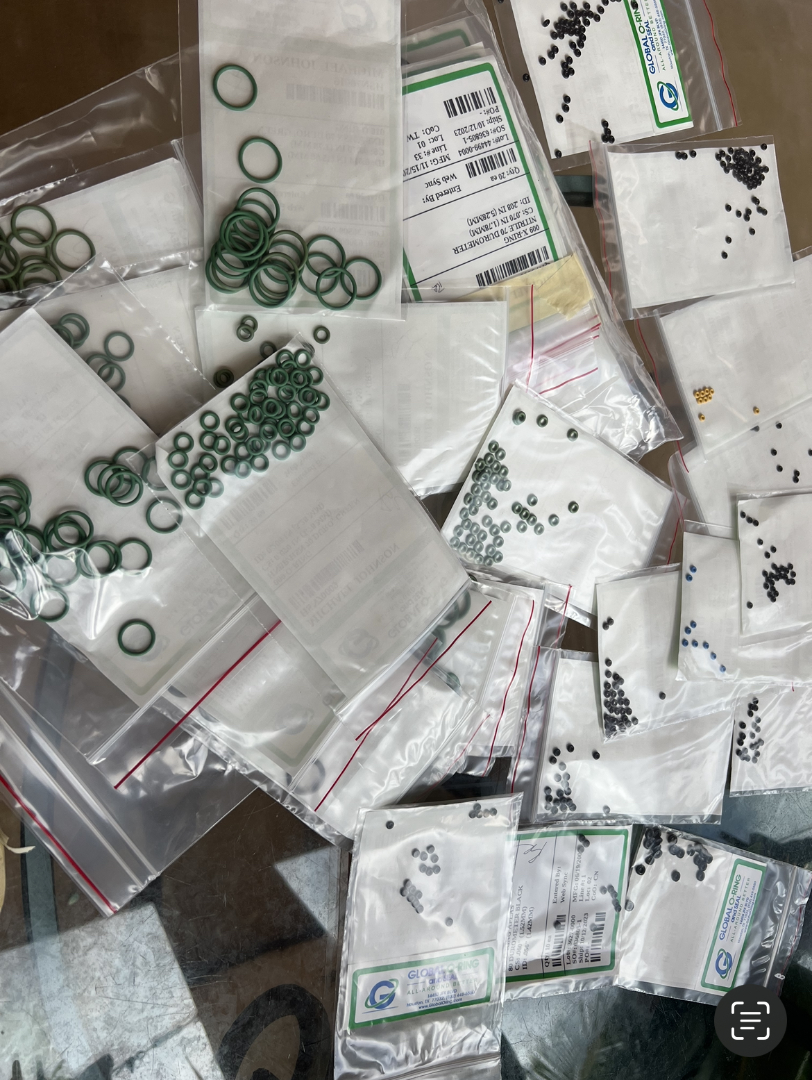

                  HBNR is my favorite too. Last and wear better than standard NBR, comes in 70D, 75D and 90D, green and black.
                  My first order from global oring came in and I would recommend them. Orings are fresh and shipped same day. I am not affiliated with them at all. “The oring store” upped their minimum qty and prices. https://www.globaloring.com/
                  i went a wild and ordered a few sets of each kind of 003 for 3 ways. Going to see which is best.
                  Click image for larger version  Name:	IMG_8234.jpg Views:	0 Size:	1.41 MB ID:	460950
                  • Myrkul
                    Myrkul commented
                    This is glorious!!!
