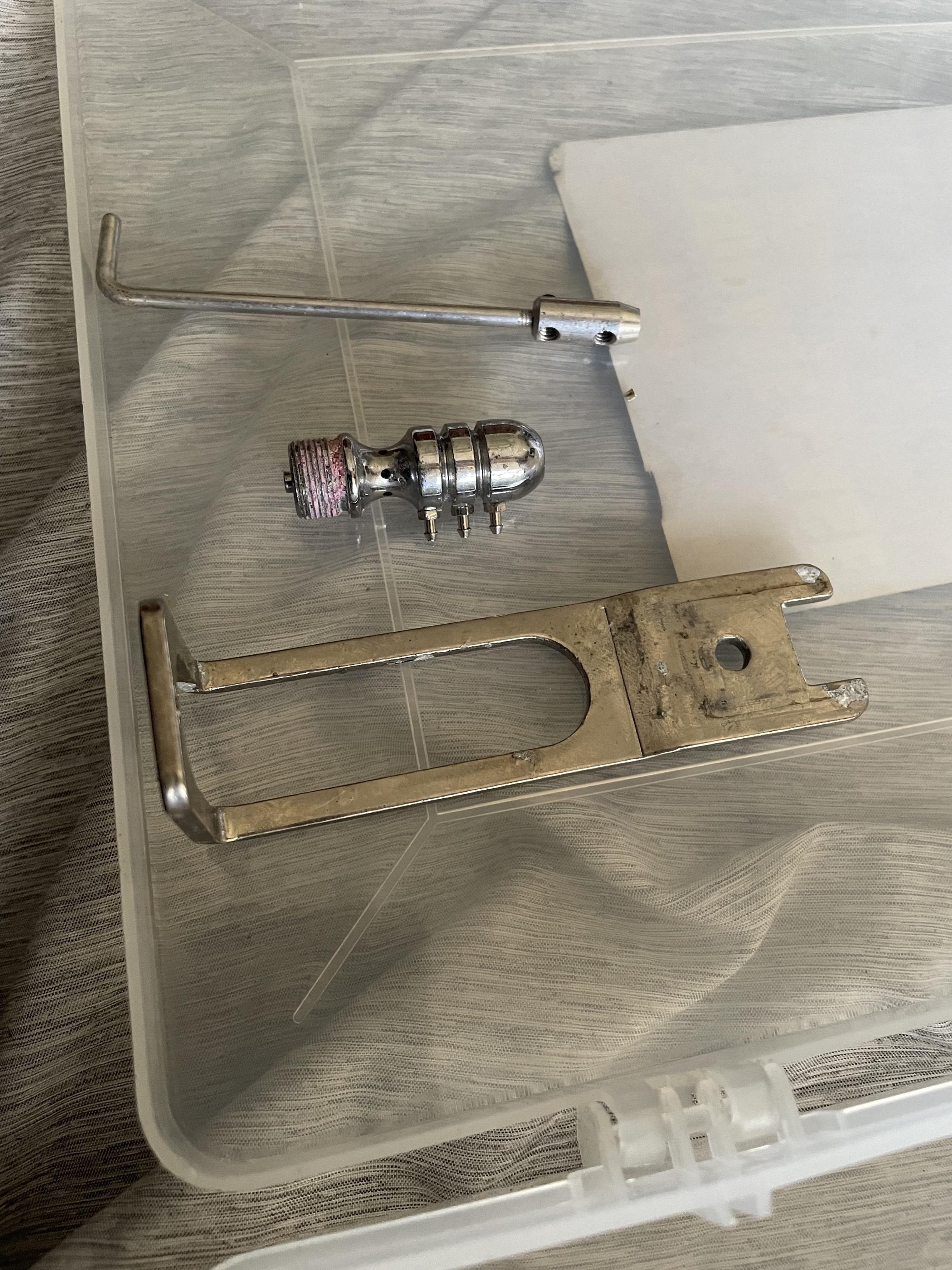

    What kind of 3 way is this?
    I picked this up as an add on with some other gear I was buying. At first I thought it was a ST bomb, mostly because it looks like a bomb. After some googling I can’t match it up with anything

    belsales hollow point.

    • autococker04
      autococker04 commented
      Never in a million years would I have googled that. I forgot that Besales was even a company. Thanks!

    A lot of people are looking for Belsale pneu and you just find one without knowing. Nice score

      Thanks, not bad for a $5 throw in! Looks like one of my brass 3 ways is getting replaced.

    Hollowpoints tend to sell for AT LEAST $75, just FYI. They are highly sought after, and for good reason.

    As a secondary question - Is this 3 way functionally very good and a significant improvement over the stock WGP brass one, or is it sought after because of the name/collectibility?

      Yes
    • Brokeass_baller
      Brokeass_baller commented
      They have a shorter throw, allowing for tighter timing. They are similar to Bombs. But also, Belsales shit is getting hard to find.
