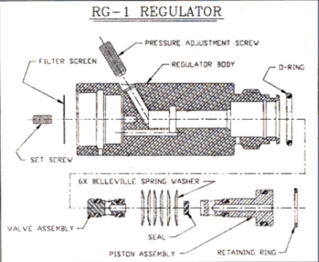

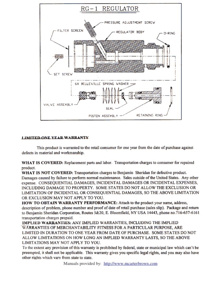

    Here's the manual. Unfortunately, it doesn't tell you what size the o-rings are. I'm using it with HPA, so I can get away with Buna. Can anyone help a brutha out?

      I wrote up a how-to rebuild for one of them back on the old MCB with all the mcmcaster carr P/Ns. Let me see if I can find it.
      • netsurferdude2
        • 879
        • North of Bawlmer
        Whoa that was easy. Found it on the wayback machine.
        https://web.archive.org/web/20160616...d-picture.html
        Front Oring: 012
        3x Rear Orings: 006
        6x Belleville washers: .500" OD, .255" ID, .021" Thickness, .037" Height​
