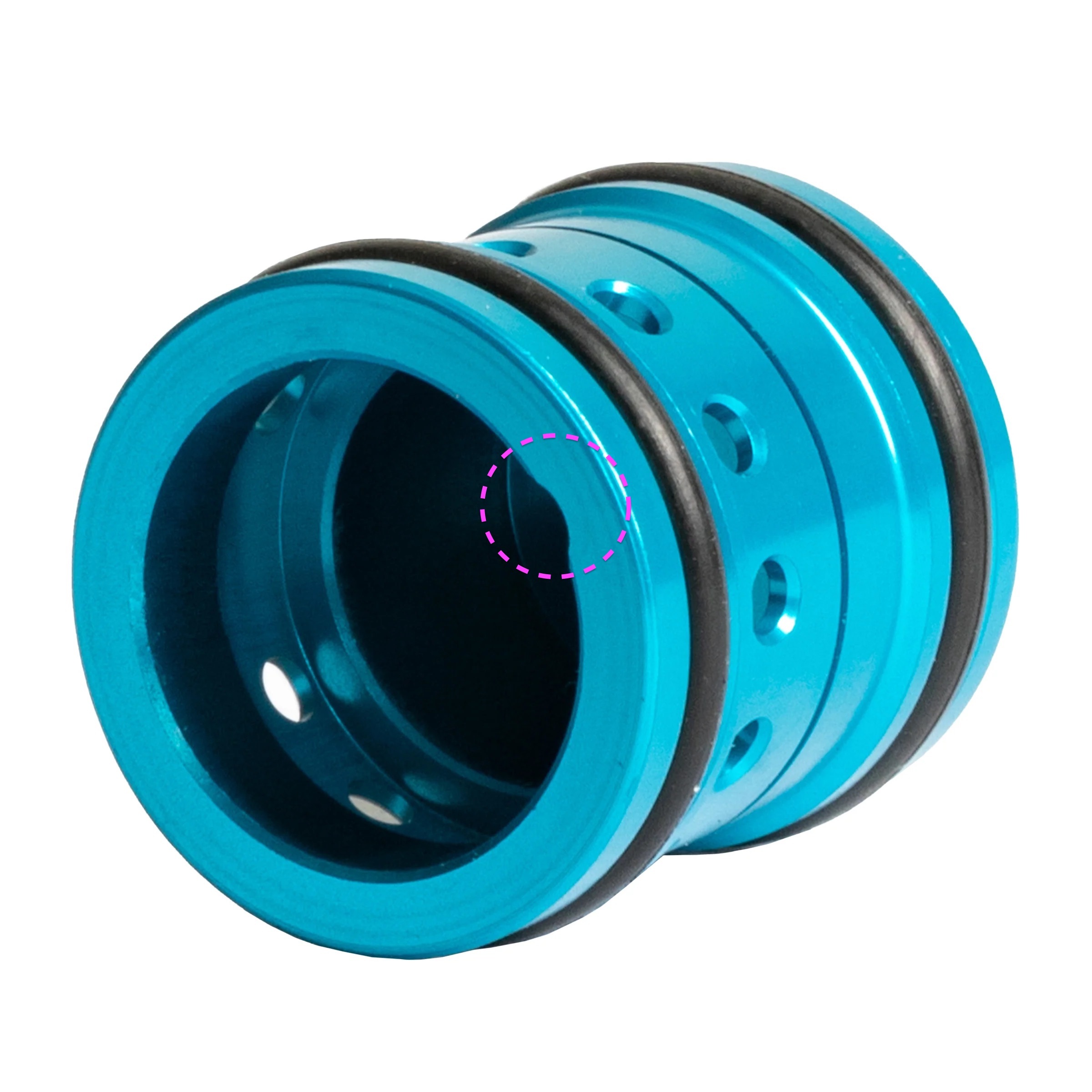

    Is the secret to the HK/PBG "Hellfire Valve" (for Planet Eclipse Gamma Core) the notch on the inner wall?
    To cycle faster, the notch is large. To cycle slower, the notch is smaller.

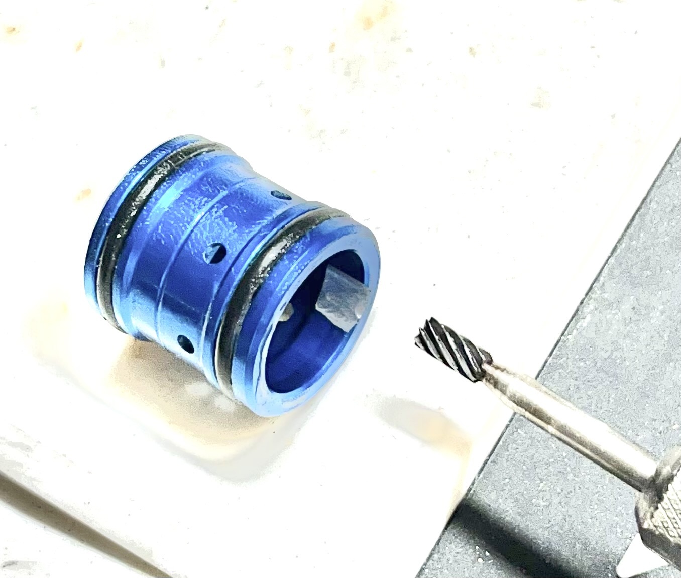

          IMG_3889.jpg Round 1. Used a dremel and spend more time cleaning up little bits from the grease. I can single trigger as it normally would. Achieves 4balls per second when the trigger is held down. I’m thinking the next step is to go deeper. And if that doesn’t work, enlarge the holes.

                      IMG_3889.jpg Round 1. Used a dremel and spend more time cleaning up little bits from the grease. I can single trigger as it normally would. Achieves 4balls per second when the trigger is held down. I'm thinking the next step is to go deeper. And if that doesn't work, enlarge the holes.
                      So enlarging the cut slows it down? Cool

                        Enlarging the cut (which is similar to having a larger part of the spool’s oring removed) increases the BPS, from my understanding.
                        Round 2: Using my dremel, I enlarged the cut. The marker i definitively shooting faster than 10.5BPS. I tried to use an original Rotor and the paint won’t feed fast enough. I’ve never chopped a ball with any gamma core marker, and now I have a lot of soup. I cleaned everything all up and tried again, and still can’t get enough balls to feed to measure the BPS.
                        I think I cut out too much material. And I also think we can appreciate the Hellfire mod as I feel a lot of tuning went into it (and definitely didn’t use a dremel).

                          Originally posted by Hooptie
                          Enlarging the cut (which is similar to having a larger part of the spool's oring removed) increases the BPS, from my understanding.
                          Round 2: Using my dremel, I enlarged the cut. The marker i definitively shooting faster than 10.5BPS. I tried to use an original Rotor and the paint won't feed fast enough. I've never chopped a ball with any gamma core marker, and now I have a lot of soup. I cleaned everything all up and tried again, and still can't get enough balls to feed to measure the BPS.
                          I think I cut out too much material. And I also think we can appreciate the Hellfire mod as I feel a lot of tuning went into it (and definitely didn't use a dremel).
                          I wonder if the bolt isn't coming all the way back before it shoots again. 10.5 shouldn't be any kind of speed a rotor has problems with

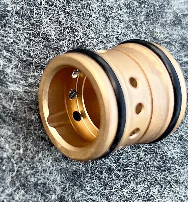

                            IMG_4075.jpg Greetings, I thought I’d share a closer image of the core ignition valve, where you can see the machined slot.
