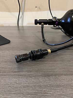

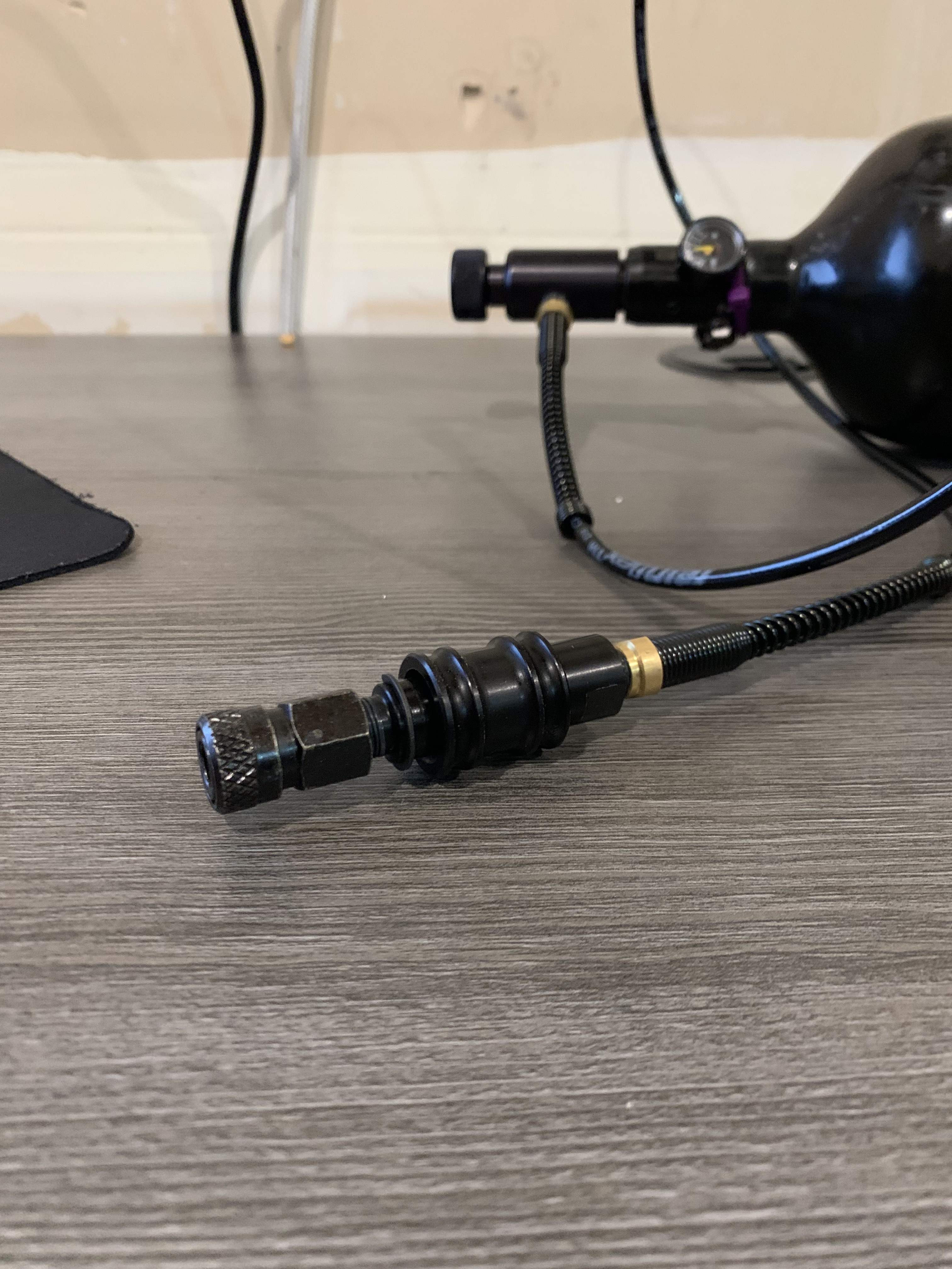

    Remote line leak
    Just bought a brand new ninja remote. When I air up I hear a feint hiss coming from where adapter meets the nimple. I’ve tried different ninja nips and different guns, same hiss.
    Can someone point me in the right direction?
    Thanks

    Is it on the threaded side of the quick disconnect or through where the male and female sides meet?
      It’s where the male and female side meets.
      I lubed the oring inside the disconnect and now it’s not leaking. Probably needs to be replaced. Do you know what size?
        Jordan commented
        010 on the last one I changed, same as a macro fitting.
