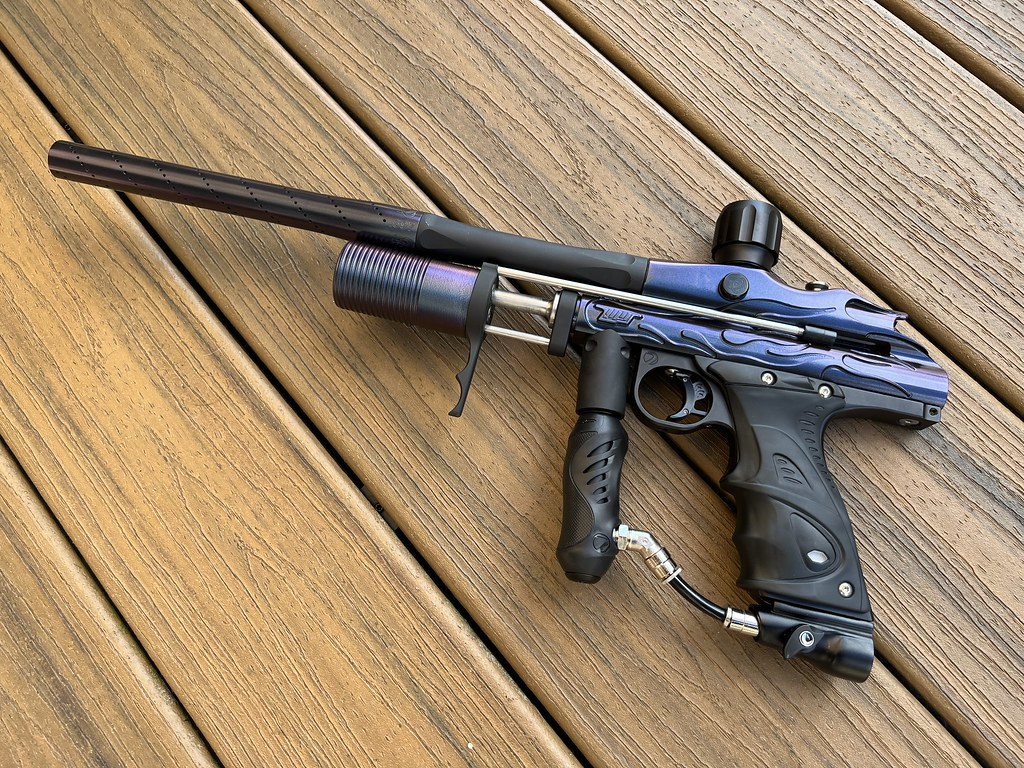

    What pump kit do I buy for a midblocked Black Magic? Had this guy long enough that I'm pressed to get it up and running.

      Thanks! I've procrastinated it for way too long, looking forward to pump conversion

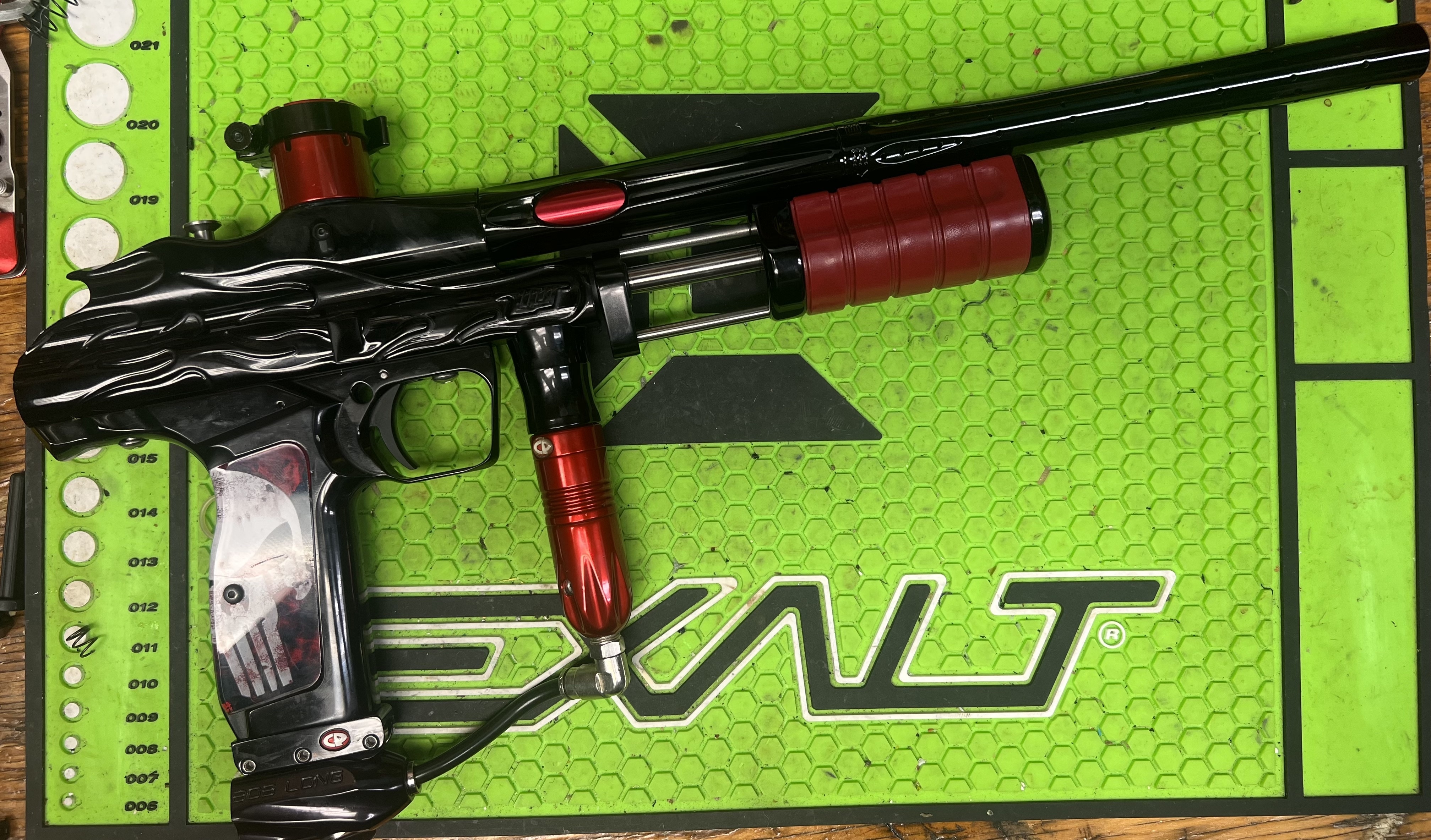

    Really it's just the pump rod you need to be mid block length. Any 2K kit will work. I've got a Pump BM as well. I'm running a Premium Slice Kit.

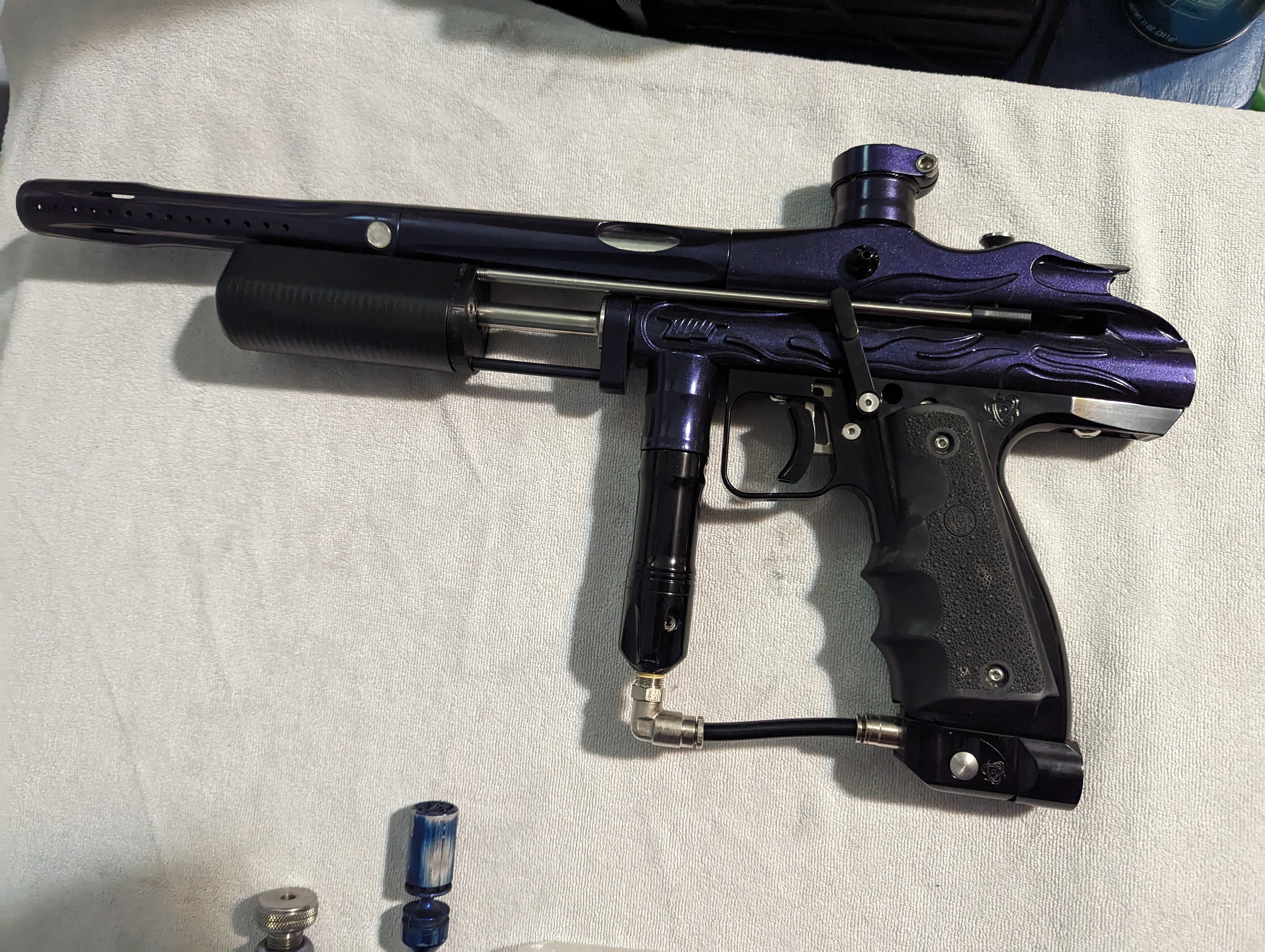

      Well this is my old marker... so I might be able to help. Ironklad that kit might work, but the ID kits have that lip right under the threads that might cause an issue. I would recommend the Autocockerparts.com ones as they are compatible with CCM handles, and look cleaner. You might have to play with the adjustment on the pump arm length, I believe I ended up cutting down a full size.
      Do you still have the pump handle? I went back and looked at my sale thread, I now remember that I had to use the pump kit base for another project. If you want to use that handle, then grab one of the ACparts kits.

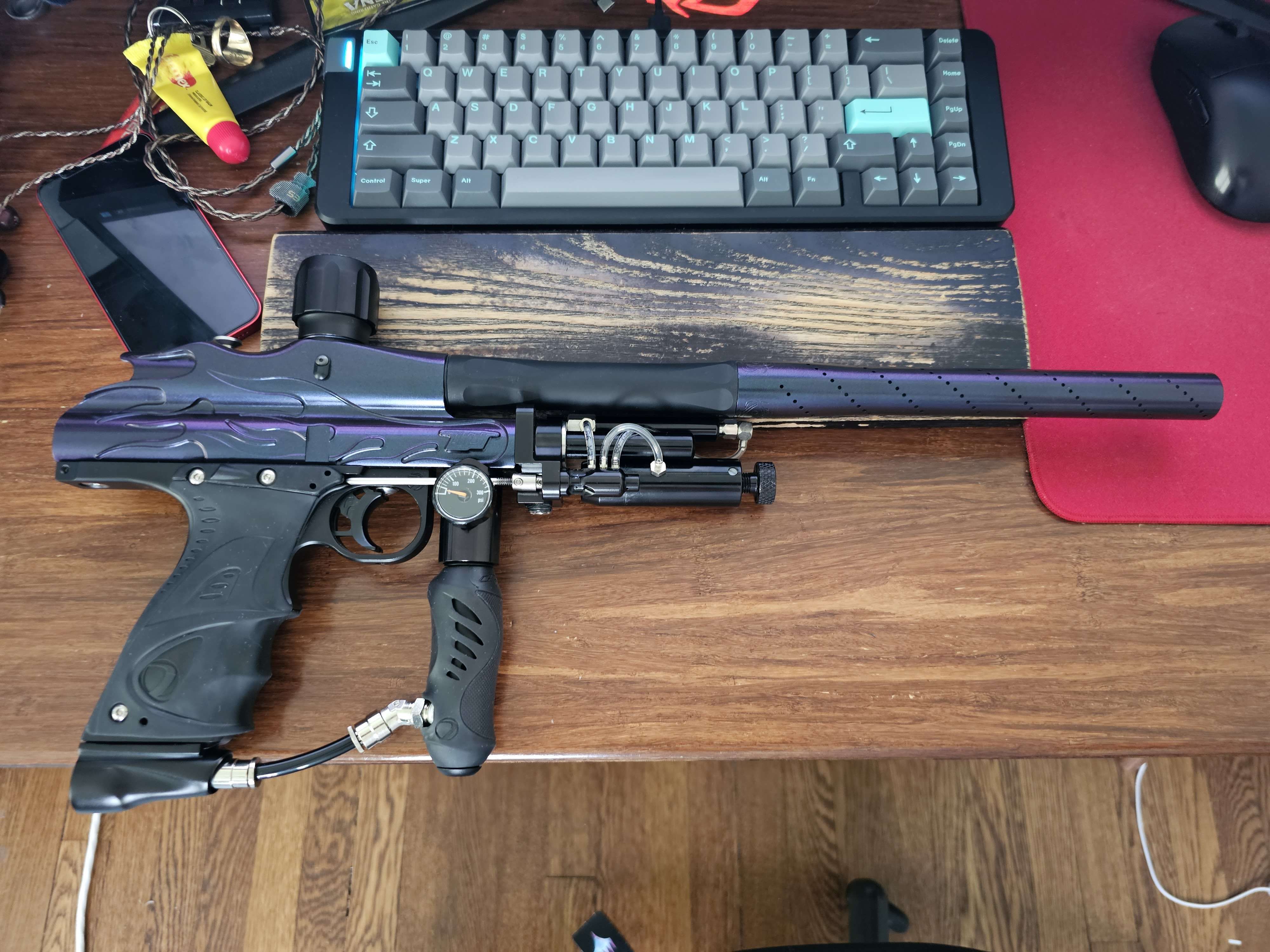

      I have darn near your twin, and I believe this is a Autocockerparts.com pump kit I put an CCM EZ Pump handle on.
