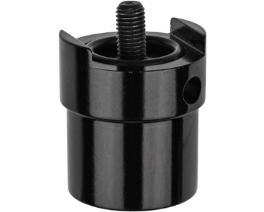

    Couldn't help myself and have a wire detent RF slab body on the way. It has a 15* angled vert ASA, which I will be tossing. I just don't know if all vert ASAs work, or if there's a pre2k/2k+ variation like with banjos and bolts.
    • 4334
    Yup pre2k / 2k asa is a thing

      The 99 spec vertical ASAs have 90* cuts on each side of the top while 2k+ are rounded. ANSGear has some right now for $17, not a horrible deal considering the current state of the cocker market.
      https://ansgear.com/ans-autococker-c...r-gloss-black/
