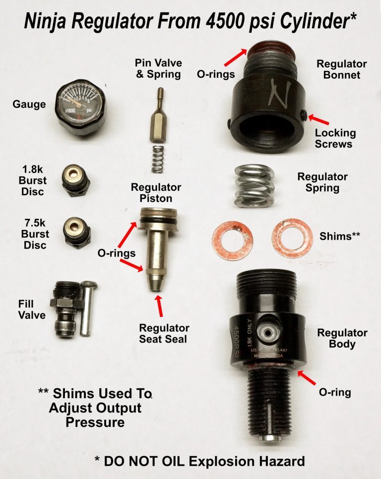

    I have Ninja Regulator on 13ci tank. I was filling it with Nitrogen from a bulk HVAC tank. when I opened the Valve, it start filling got to about 2000 psi on the tank gauge then. started leaking from every where but the burst disks ( leaking from the 2 set screws) anybody have an ideas what when wrong before I start ordering parts??

    Likely the pin oring at the top of the tank. Take the bonnet off and check? But would a use a general leak like that.

      It sounds like the internal regulator o-rings. The urethane o-rings perish after a few years.
      You can get a rebuild kit for these.
      Just make sure the tank is empty before removing the bonnet.​
