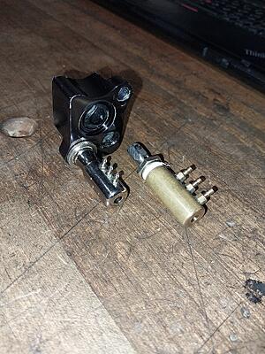

        The original 'Cocker 3-ways were off-the-shelf switches, I can't recall from either Clippard or Humphries. I don't know if Bud had to thread them, or if they were already threaded, but either way, they were about 1/2" in diameter, and needed a shallow thread to fit them into the front block.
        A standard 1/2" thread, like 1/2"-20, would have cut too deep into the 3-way body. You needed a finer thread so the thread depth was considerably shallower.
        15/32-32 is an obscure but not unique thread. Why not 1/2"-32, which is another thread that exists? Probably because that slight OD reduction allows for a thin "shoulder" keeping the user from screwing the switch into the block too far. (Then again, the threads simply ending should do that, too.)
        Most likely happenstance? The switches were probably already threaded, off the shelf. Bud simply bought those, ordered a tap, and went from there. Why reinvent the wheel?

          You'll also find 15/32 32 on the threads by the adjustment knob on the clippard LPRs and some of their other stuff. They used them for mounting their components.
          TV-3SP by CLIPPARD - Buy Or Repair - Radwell.com The non 1/8 NPT end is 15/32 32​
          It is also the threads used on the end of the barrel of walther p22s.

            Oooh, I think Beasts is on to something. I never even considered that, but yeah, those little knurled nuts that go to toggle switches, are often 15/32-32.
            Pneumatic switches like you linked to, are meant to mount in the same panel as electrical switches- that would make sense that the spool switches/3-ways would have a similar thread. So my blind guess that the original 3-ways that Bud used were already threaded, was almost certainly correct.
            And THAT makes me wonder why no one's used one of those little knurled nuts off a toggle switch, as a sort of "lock nut" to tighten a 3-way into the block at the correct angle.

              IIRC, Craig Palmer said the early WGP switches were a direct copy of the Humphreys 4ppx switch (used on early PPS semis) with the ports rearranged to accommodate the front block. Humphreys 4ppx valves are threaded 15/32-32 for mounting, so it stands to reason that Bud copied it, likely for those reasons you mentioned.

              Before even reading the rest of the replies, as soon as I saw mention of an Autococker three-way I went on Clippard's site and found that thread size on their other small three-way valves.
              The only alternative is to make your own front block and three-way with some common thread. It will then very ironically make the assembly entirely non-standard for Autocockers.
