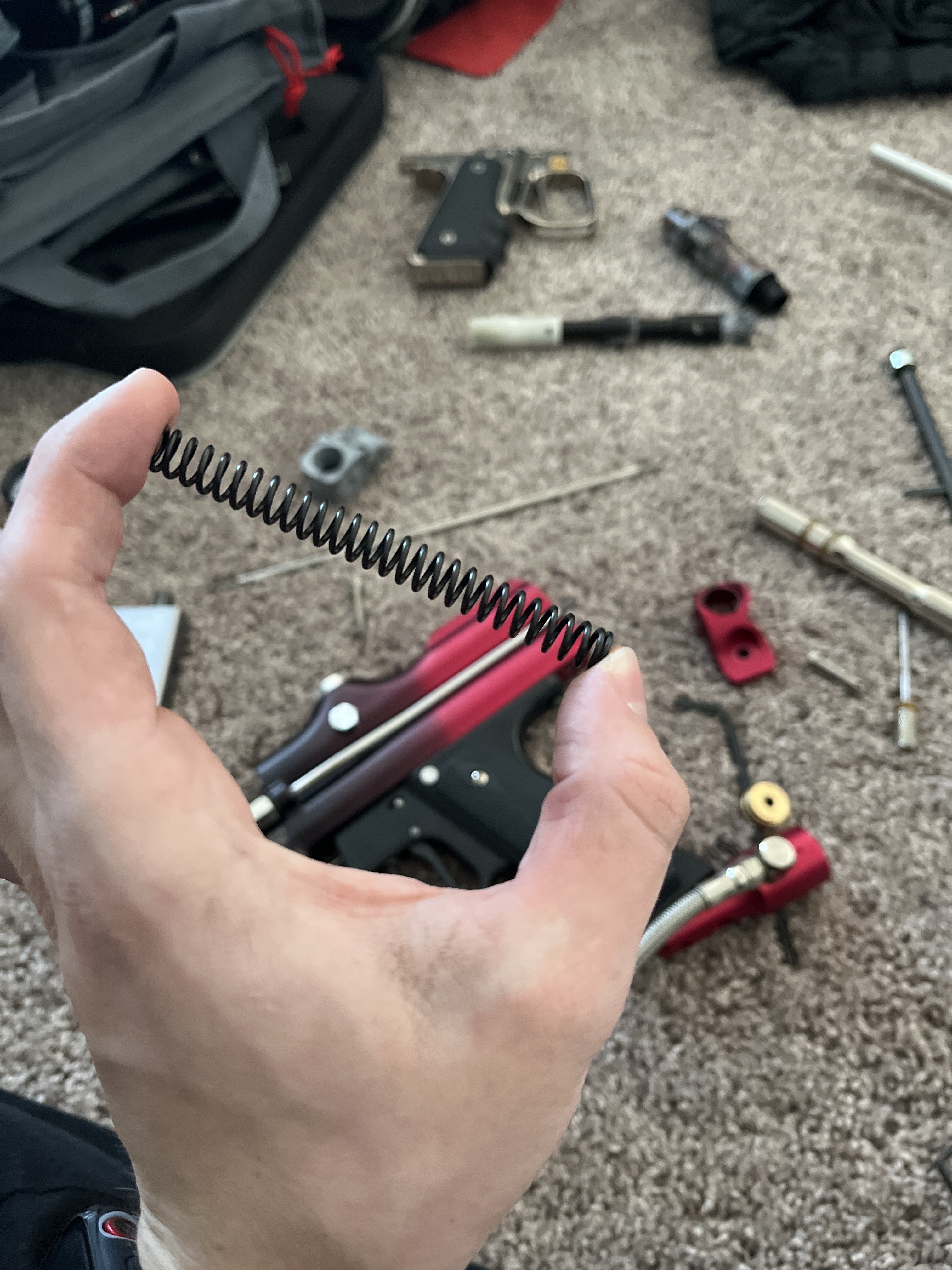

    Hello experts, I already know some of yall have some trillys with Lazarus valves in it but idk how to setup the lower tube. Do I keep that long spring or do I need to swap it out for a different one?

    Don't you just not use a valve spring with the Lazarus? It has a spring internally already as well.

      I guess I have a leak from something else then lol

    No valve spring is needed with the Lazarus valve (this long spring is the valve spring). Its already enclosed in this valve design. Insert the valve and lock it in place with the screw. Get the lightest hammer and valve spring you have, set the IVG flush and start from there.
    • Jackson
      Jackson commented
      I think you mean lightest hammer and hammer spring.
      Alexndl commented
      Jackson is corect, lightest hammer and hammer spring
