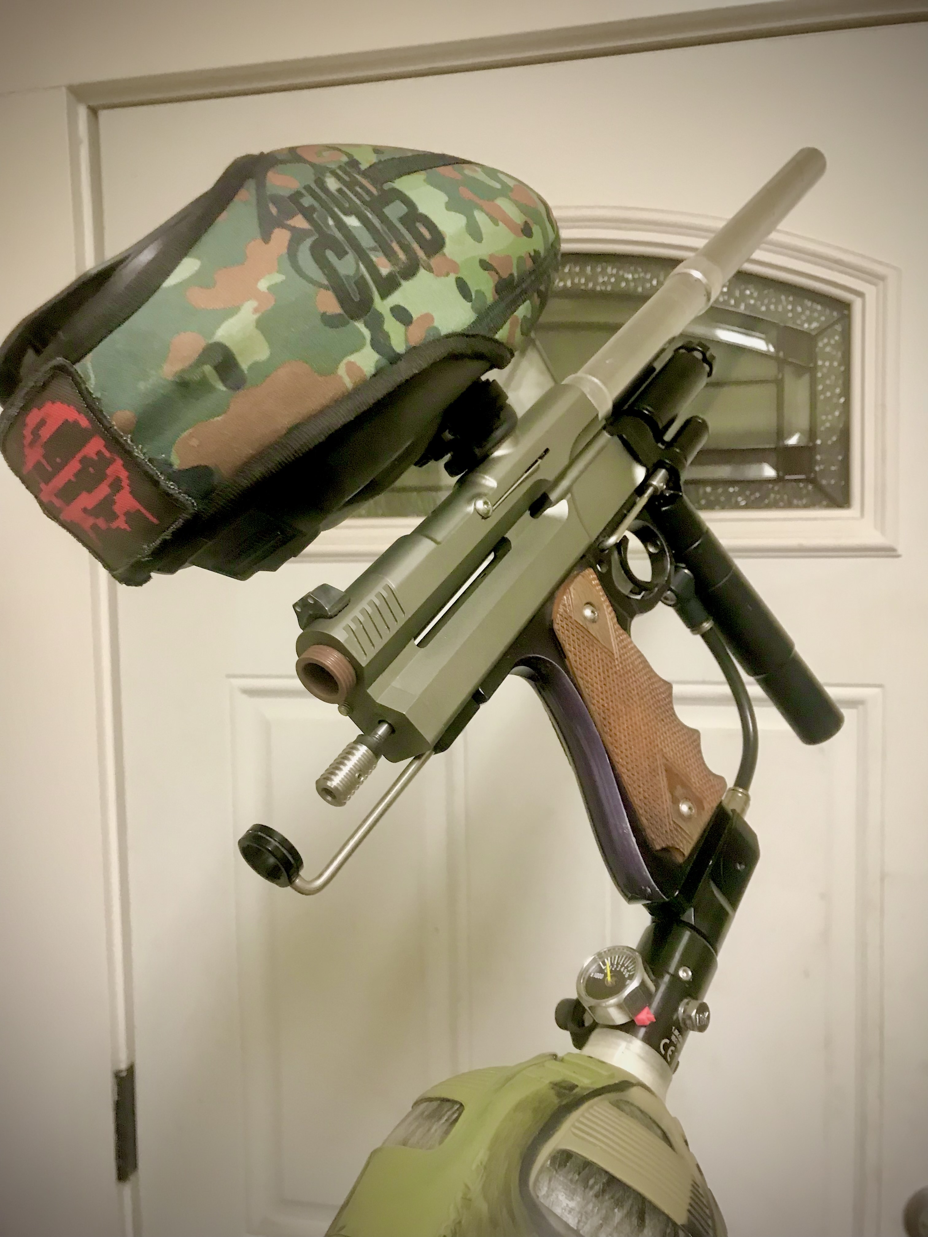

    Hello everyone, I usually run a Dye rotor or the Gog 100rd hopper for my cocker. My detent is pretty new but there’s definitely more of a chance of double feeding with my rotor than a revvy. What hoppers do yall use besides a revvy? I feel like the dye likes to shove paint in harder than other hoppers.
