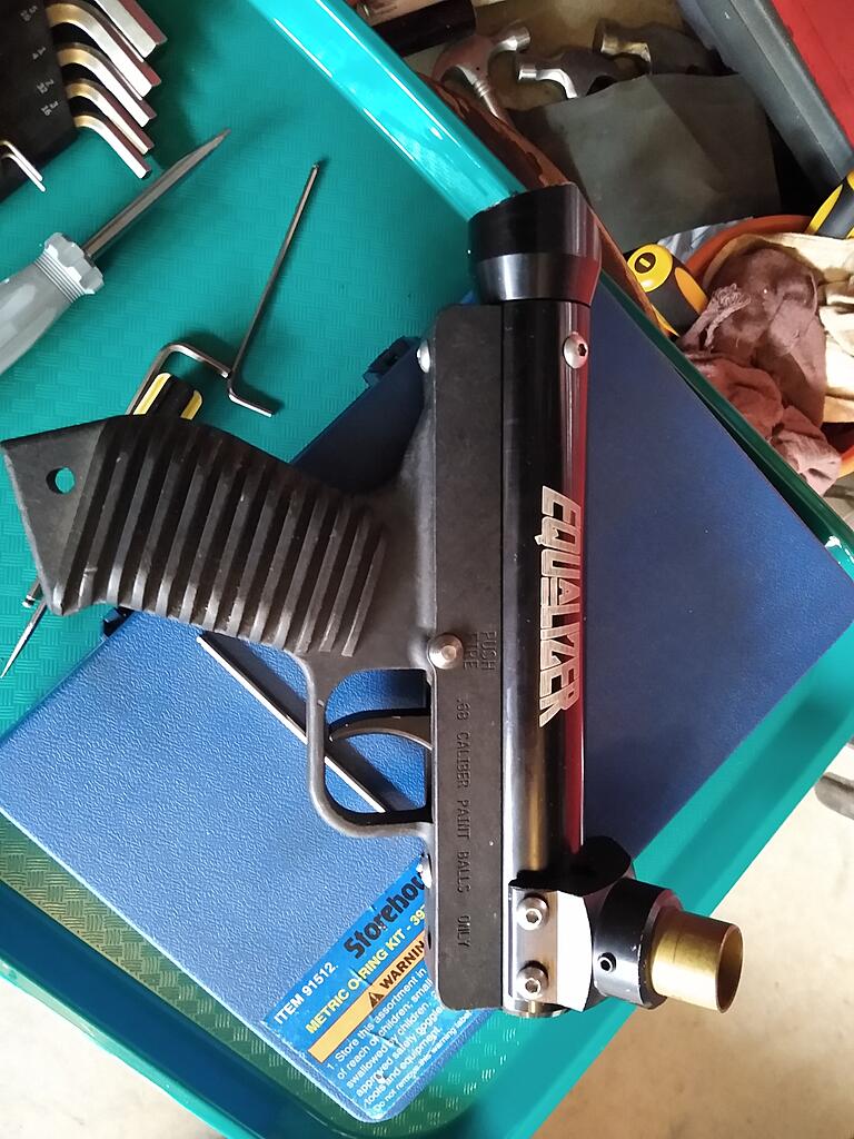

    Equalizer
    Just got my equalizer sealed up but it needs a ball detent. Where/who is making or printing these?

      They take VM68 ball detent?
      If yes I can 3d print you some and sent them to you they are not hard to make and I have the files for them.

          Originally posted by Axel
          DocsMachine weren't you making Equalizer detents at some point?
          -Two of them, actually.
          I was going to start molding rubber ones, and found out that Palmer's carried them. I also came up with a permanent, spring-loaded design I was going to make, and found out there's supposedly a guy on FB making something very similar.
          With Palmer being out, I was thinking of finishing up my molds, and could easily revisit the spring-loaded ones.
          Doc.
          Paintball in the Movies!
          • Chaos
            I'm Comin' To Getcha
            • 878
            These use standard VM-68 detent fingers...you can either get some 3d printed ones (Freedummy has a file on here for it) or contact BretG and see about getting one of his spring loaded Charm detents (which as very durable and should be the last one you'd ever need)
